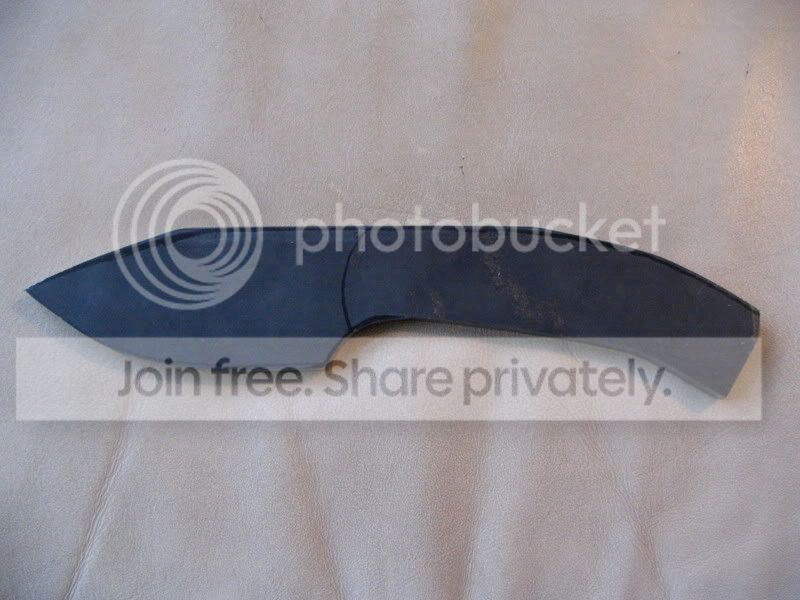

I tried drilling the outline of the blade as shown in the tutorial, but the drill bit just wouldn't cut. Then I bought some 'good' bits, and they still wouldn't cut. Finally, I burned through a few hacksaw blades and filed the rest of the way to the profile:
Next, I filed in the plunges with a round file:

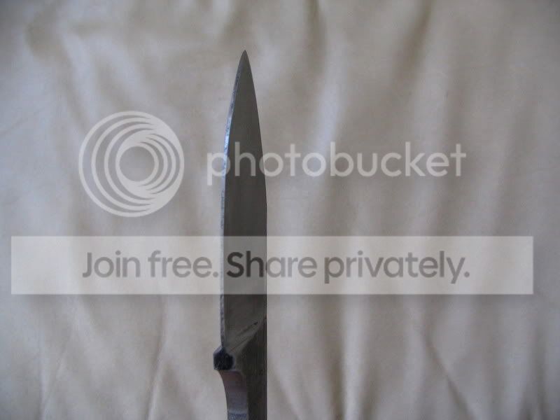

Then I filed and filed and filed until I had the bevels more or less done:

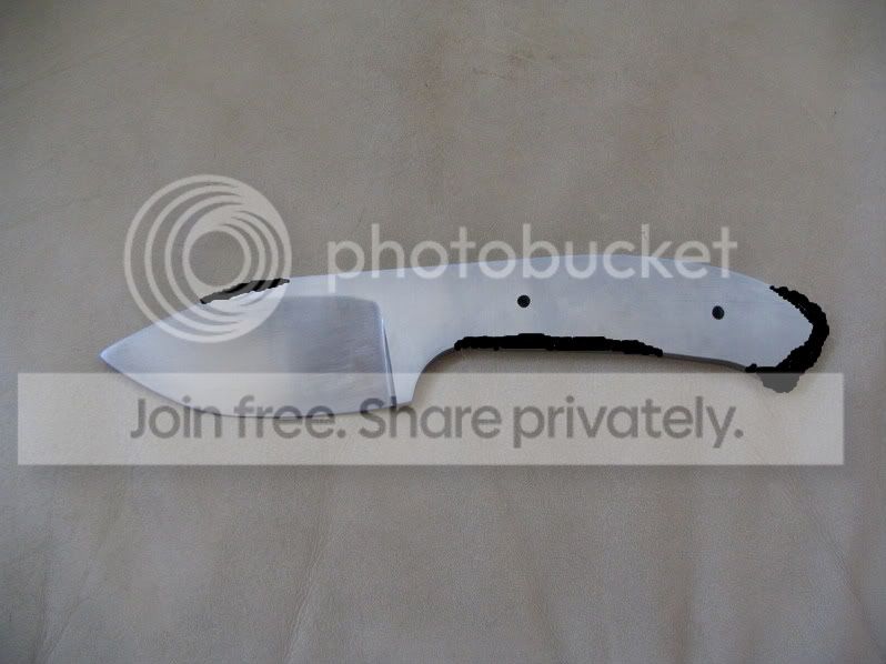

Here I had drilled the pin holes with the hand drill (which took a couple of hours with the 'good' bit) and contemplated some minor changes to the profile:

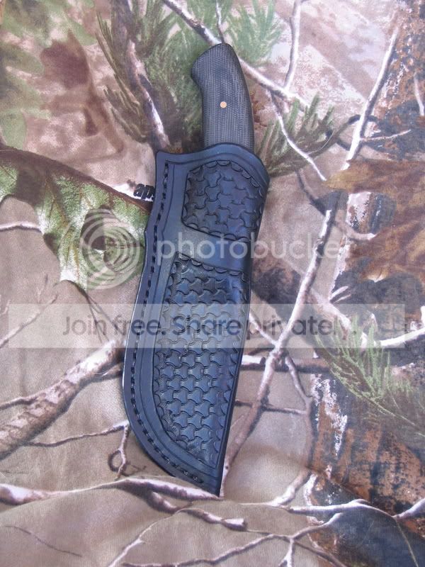

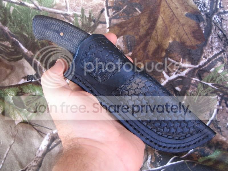

And finally, some pics of the finished blade along with the 3rd sheath I've finished following Wild Rose' excellent sheath making DVD. HT was done by bringing it to non-magnetic in my forge, and quenching in 130F veggie oil, then tempering twice at 375-400 in my toaster oven:

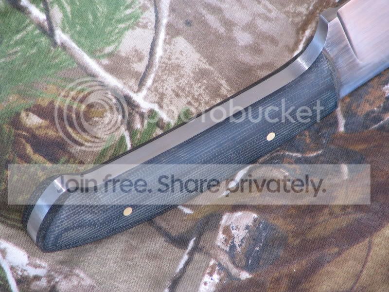

Although not real apparent in the pics, in direct sunlight there are quite a few j-hooks or fish hooks in the final finish despite going over it with fresh paper and the corner of the sanding block. I don't think it's real flat because the hand sanding before and after HT fought me tooth and nail. I also managed to put some surface rust on the blade and tang when I sharpened it by taping the blade up to protect it, then getting water under the tape.

Wow! Great first effort. And excellent job done on the handle shaping! I would be proud to tell people that was my first. Oh, and please tell me you didn't make that sheath. Because if you did, I may just have to go throw away all of my leather and tooling.
edit: I just re-read and found that this is your third sheath. Excellent job! I just watched Chuck's video yesterday, and I'm looking forward to making the next sheath. Maybe there's hope for me yet!
--nathan
Looks like great work especially considering that it's your first knife. How long was the knife making project? Your tooling on the sheath looks great! So are you going to be making some more or was it too much like work?
Wow guys, thanks a bunch for the generous comments! And yes Nathan, Chuck's DVD is outstanding in my opinion. I've never touched leather before (well, you know what I mean!) this, and if I can cobble a decent looking sheath anyone can. There are some tooling mistakes on the sheath, but I guess the dye/finish and photos help hide them somewhat.

I think all the compliments are well deserved. You can tell in the details. The plunges are clean and even. The handle is shaped carefully and uniformly with pleasant lines and swell. The scratch marks around the tang are parallel to the knife and uniform; you hand finished the blade. The sheath is a great job to finish the package.
You took your time, and the hard work really shows. Keep it up, and keep paying attention to the details.

I have a question about the final finish if anyone can help...when going over the blade at the end with a fresh section of paper with each swipe and using just the corner of the backing block, how do you guys get in and around the handle scales at the ricasso? I found this difficult, as the scale fronts are rounded and my backing tool is not. Also, it was difficult getting right up to the scale/ricasso junction without messing up the scale fronts.
