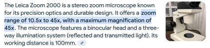

How much magnification? I have a cheap 60x, and it helped me to be able to see what's going on at the apex. I almost bought a better one with higher magnification but never pulled the trigger.
Mine was like $20, it does exactly what I need it to do.
I have a different brand but it looks exactly like yours. Performs well but hard to focus at high magnifications. I’m going to spring for one of the ones with a digital display. 2000 magnification.

Outdoors55 recently did a video where he bags on those cheap digital microscopes. Normally I agree with most of this stuff I think he misses the mark on this one. He's comparing a cheap scope to his stack of expensive camera lenses and editing software that stacks a hundred images into one! Of course a $50 scope won't equal that, but it doesn't have to. My cheap jewelers loupes and no-name Chinese digi-scopes allow me to see the burr and evaluate a scratch pattern which is all I really need them to do.
Those numbers are very misleading.
Digital "zoom' and optical zoom are completely different.
The cheap magnification do have their place but they are far from ideal.
If you go with the bargain option look for one with some sort of staging that will hold the devise and viewed object stationary while in use.
FWIW if you want a bargain for a more serious set up start watching local government and education auctions for surplus sales.
For the best results set up a preview and check function and suitability before bidding.

For observing the edge of a knife and sharpening you don't need super high quality optics. You can pick up a My First Lab microscope on Ebay for often under $30.
These microscopes were a popular Christmas gift years ago and kids instantly got bored of them and put them away on a shelf, ask me how I know...
They do a decent job of 40x and 100x magnification and they will provide most people with a view of the knife edge they have never experienced and for most will help better understand sharpening and how the edges dull.
