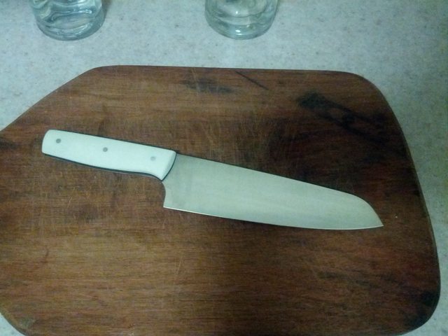

Hey guys!
It's been quite a while since I made a knife that wasn't a 'Resolute' model, and it was nice to have a bit of a change!
Sorry for the poor photos!
Specs:
Blade: 1/16" thick AEB-L @ 60HRC
Handle: White G10 with black G10 liner (chosen because they're my least used colors!)
There's a bunch of stuff that I'm unhappy with in this knife, but it's already served to teach me a lot which was the main purpose.
Things I don't like:
* The edge profile doesn't feel quite right to me, it doesn't rock the way I'm used to, not sure if I'll get used to it or not
* The edge is thicker than I'd like (~0.012") but I didn't want to take it thinner as I'm unfamiliar with this steel
* The heat-treat seems to be not as good as it could be
* The handle isn't anywhere near as comfortable as I thought it would be
* Grinding AEB-L after heat-treat is gross! Lots of long stringy 'steel wool' that was constantly burning and going EVERYWHERE
The heat-treat that I used for the AEB-L was:
* Coat blade in anti-scale and put in foil envelope
* Ramp to 1995ºF, hold 5 minutes
* Plate quench
* Temper 400ºF, 2 hours, twice
Result: 60HRC as tested on my hardness tester

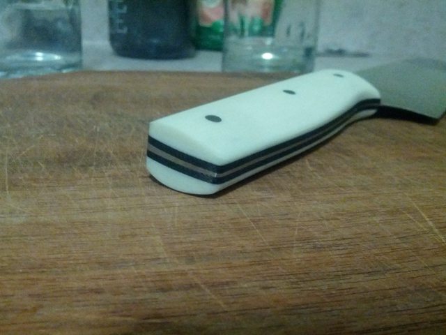

Things I did like:
* New water-thin CA (superglue) that I'm using is awesome and has many uses
* Temporarily gluing handle scales together into pairs for drilling and rough shaping, super convenient and fast
* New handle glue-up method
One of the big things that I did differently on this knife was the handle glue-up. Normally I use epoxy, but I was in a hurry given that this is just a prototype and I think I accidentally stumbled on a new method that I like better than epoxy:
* Drill and rough-contour handle scales, counter-bore the holes for the corby bolts
* Finish the front of the handle scales
* Put some thread-locker on the corby bolts, bolt the scales to the tang tightly
* Put a tiny drop of water-thin CA on the point where each corby bolt meets the scale, the glue wicks in around the corby
* Run a small amount of water-thin CA (super glue) along the edges of the tang. The glue wicks into the minuscule gap (miniscule as in impossible to see) between the tang and the scales, spray the excess glue with accelerator
* Grind off the heads of the Corby bolts, finish grind the edges of the handle.
The CA seemed to wick all the way under the scales very quickly. I applied it to the top of the handle and you could see it appearing on the other side pretty much straight away. At the ricasso it formed a tiny (super tiny) little fillet that didn't require clean up. Just the tiniest hint of shiny surface at the point where the tang and scales intersect, about the same as what you'd see with epoxy after judicious clean-up.
So in less than 5 minutes of gluing up I was ready to finish grind the handle. I've done destructive testing with CA glues in the past and they were very strong, but I always had trouble with how to apply them neatly. This new super low viscosity CA that I'm trying seems to introduce a bunch of new possibilities! The brand is 'Hot Stuff' and it's the 'original' formula.
One of the nice things is that it's possible to clean up CA after it's cured using the solvent supplied with the glue, with epoxy this is pretty much impossible and can cause serious problems if you ever miss a spot.
The glue lines that this method produced are literally impossible to see. With epoxy well applied you can't see a glue line, but with this method it's like there just isn't any glue at all, can't quite describe the difference. The final results looks very clean. I will do some destructive testing with this method in the near future and see how it holds up.
I've also been using this new CA to hold handle scales together in pairs for drilling and rough shaping. A few dots of CA and they're bonded together, then when they're done I hammer an OLFA blade in between the scales and they pop apart in just a few seconds.
I ground the knife with a straight bevel from tail to tip (after heat-treat), and to hold the knife on my grinding jig I again used the same CA. A few dots on the blade, then some accelerator applied to the jig. Hold them together for a second and they were stuck. The after the grind was done one one side I used a piece of scrap G10 and a hammer to pop the blade off the jig. Worked very well!

I can't believe a knifemaker of your caliber hasn't made a kitchen knife until now! I see a little bit of the Resolute in that handle (Where's the window breaker?! In case of emergency tactical kitchen exfiltration!). I'm a relatively recent convert to knifemaking thanks to your videos, so I can't really say anything constructive, other than it looks like it wants a bird's beak at the butt. I tried using thin CA/super glue to seal up the miniscule gaps in my first knife, but ended up making more of a mess than I was trying to fix. I'll have to revisit it given your success with the method.
Grinding high carbon and stainless steels before and after HT requires a ddifferent approach even IMHO different abrasives, for high carbon cheap zirconium bands do the work just fine, for stainless and specially after HT I found that zirconium overheats a lot and dulls pretty fast so I switched to ceramics.
I tend to use thicker stock, from 2 to 3mm (3/32" - 1/8" ish) because I like leaving a ricaso and a distal taper all the way to the end of the blade, a 3mm blade allows to do this. And when I use thinner 2mm stock I leave no ricaso like you did on your model.
The shape you choosed is traditional, I found that adding a slight change on a traditional model add a lot more of interest to my work, in my case I clipped the point a little instead of dropping it, slight change, more eyeballs :)
Regarding pins, I use 2mm nickel silver (alpaca) they look better IMHO than the traditional 1/4" rods used by manufacturers. And finally about adhesives I use epoxy, never had a problem, maybe if I ever find corby bolts here I will try CA, good idea!
Pablo
Aaron,
For your first kitchen knife, I would say you did a very nice job. Concerning the profile, if you want to improve it for "rock chopping" adding a very slight belly starting about 1.5 - 2" from the heel will help. Currently, the profile looks fantastic for push cuts and pull cuts, so keep in mind, different users have different styles of cutting.

I have used CA on many handles after watching Steve Johnsons video and talking with knifemaker Mike Lovett about it. Steve goes into detail on how to use it for handles and his video is the best knifemaking vid I have seen.
I now prefer to use it mainly with the handle/liner glue up and use epoxy for the tang handle. The epoxy is better at gap filling and easier clean up at the ricasso.
No matter what the case I would only use Loveless or Corby bolts with CA.
