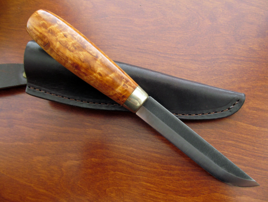

i was also curious about the blade not being flush with the bolster. i have seen it both ways. the knives i have used (in this style) have all been flush. is there a reason why Veikko (and others) choose to not have the edge and/or spine flush with the bolster? is it a performance related decision or just aesthetic preference?
also....HFinn, how do you like that Veikko Hakkarainen? i would be interested in your thoughts, as it looks like you have put that thing through some good use. (thanks)
It is one of my all-time favourites. The steel is very hard, so it will hold an edge for a long time, but sharpening it is difficult. I finally found a stone that will do a good edge, it is a local stone here in Finland. Anyway, the handle is really comfortable. As you said, I have used the knife a lot which shows, but it still has a lot of life left. It is good for whittling and all-round use, I have also opened and cleaned some birds with it.

In this case, being the blade quite slim (19 mm or 0.75'' high) being flush with the bolster would lead to a big taper towards the blade of the front part of the handle or, worse, a generally slim and petite one.
In prolongued use, especially in wood working, the slimmer the handle, the worse.

makes total sense. wasn't keeping dimensions in mind. thanks.

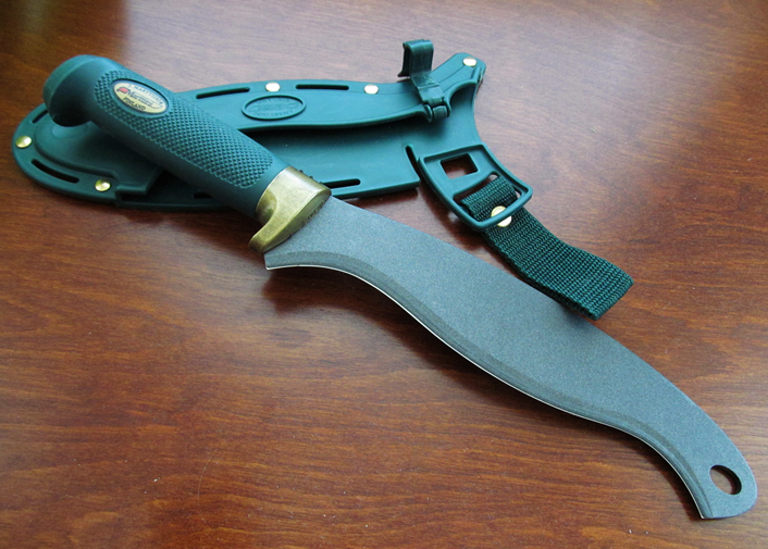

For something a bit bigger, not as pretty a handle, but one seriously great bush tool that is also capable of doing some surprising small scale work I give you the Finnish Skrama II.
I got to test this out for the fellow in Montana who imported a bunch and is selling them. Sadly, the initial bunch will be his last as the communication from the Finnish designer/producer is spotty at best. Sad too as there was talk of testing and possibly carrying a similar Puukko design.
I love my basic tomahawk, but I'd probably strap this thing to a pack instead of my hawk if I were off adventuring.
