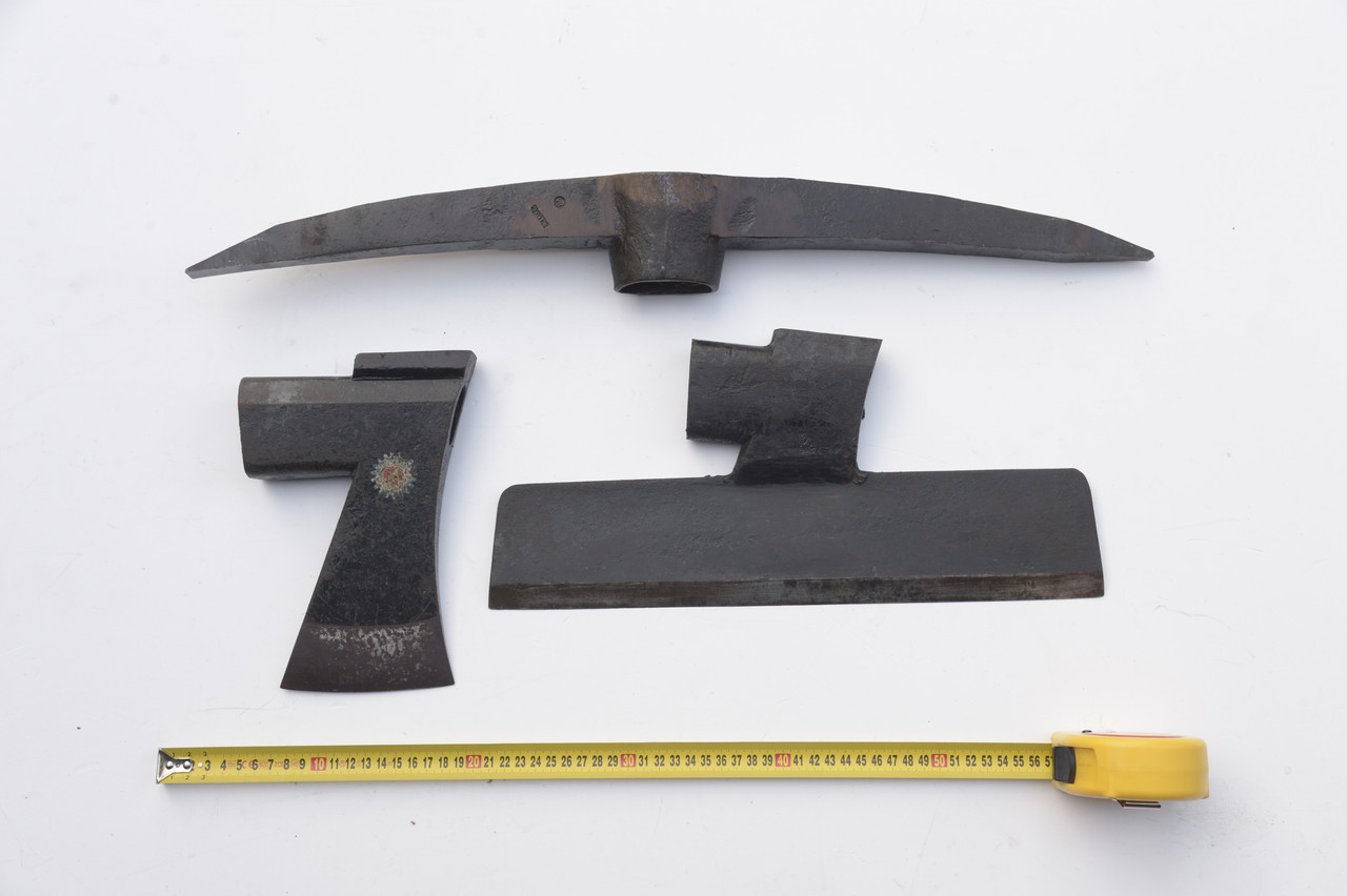

Billnäs brutes from the bygone era: their biggest axe No. 1, biggest rafter hewing ("tar") axe No. 30.7 and pickaxe No. 113. All are unused and will remain as such as they are too heavy for me and I actually don´t have any appropriate task.

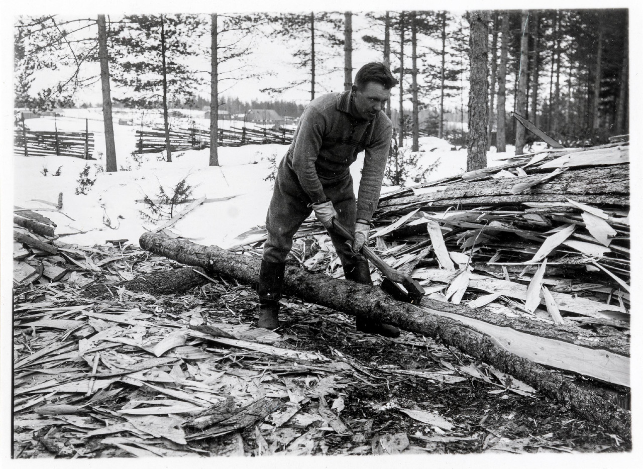

Here No.1, notice the haft:

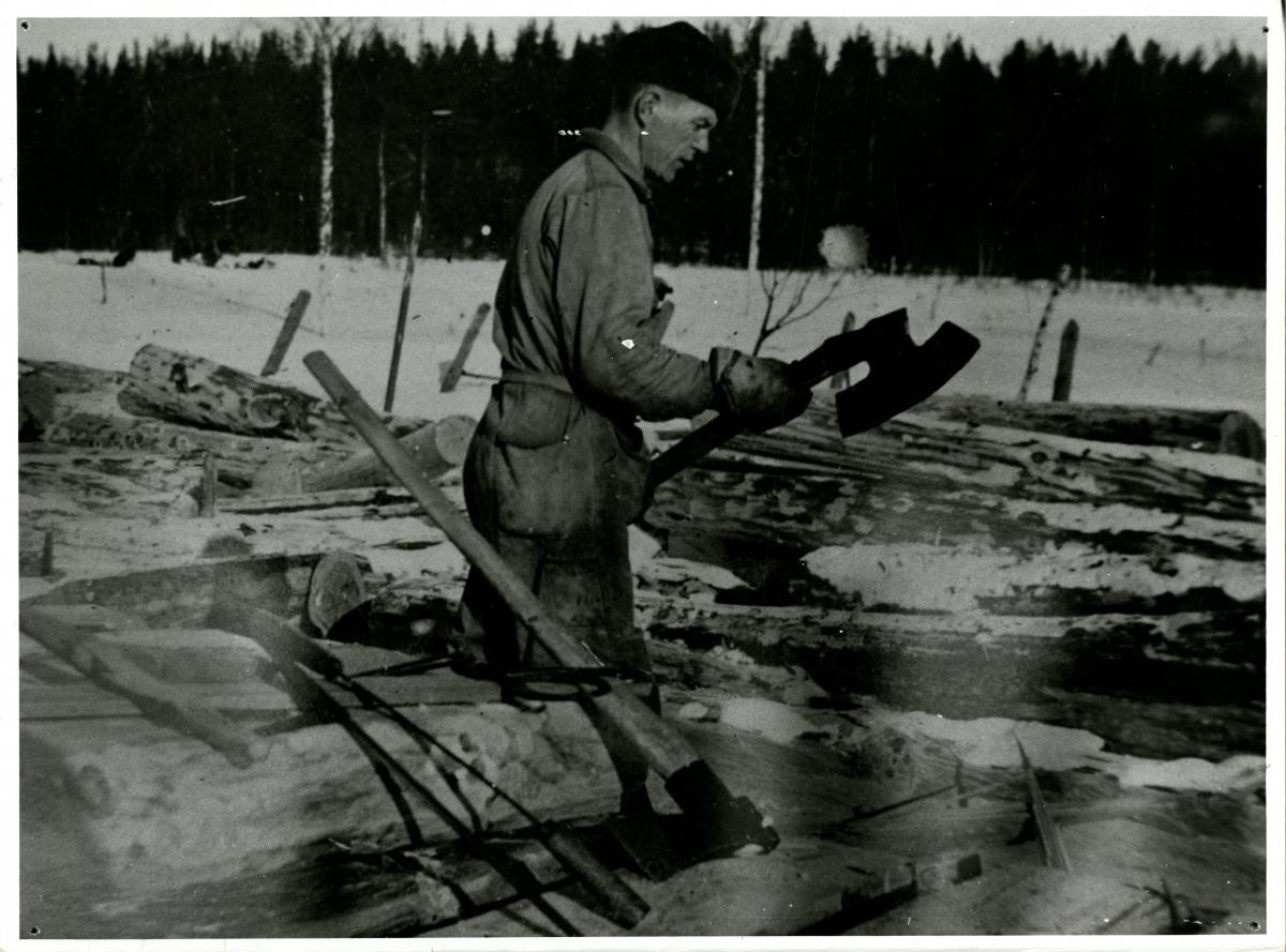

Here No. 37.1:
veeteetee. Very interesting and informative historic photos, thanks ! I would like to make some comparisons to the historic American broad axe log hewing techniques.
In the second photo I see a right hand off set broad axe head (side axe) with a S bend offset haft and what looks to be about 28" + or -. I see a felling/ scoring axe with a straight 36" to 38" + or - haft. I see what looks to be some type of bark spud. And I see the axeman using a hewing technique like the historic American technique to hew larger logs. He is standing with both feet on the same side of the log.
In the third photo I see the axeman using a small log hewing technique of standing with one foot on either side of the log. This technique is similar to one of the American Tie Hacker ( Rail Road Ties) techniques. In America a somewhat different large broad axe head pattern was used that has no offset head or haft, with a knife edge grind (see photo #18c on page 10 in "An Ax To Grind, a Practical Ax Manual", by the U S Forest Service). The axeman is using the same offset broad axe as in the second photo. Probably done so he does not have to carry two heavy broad axes to the log pile.
