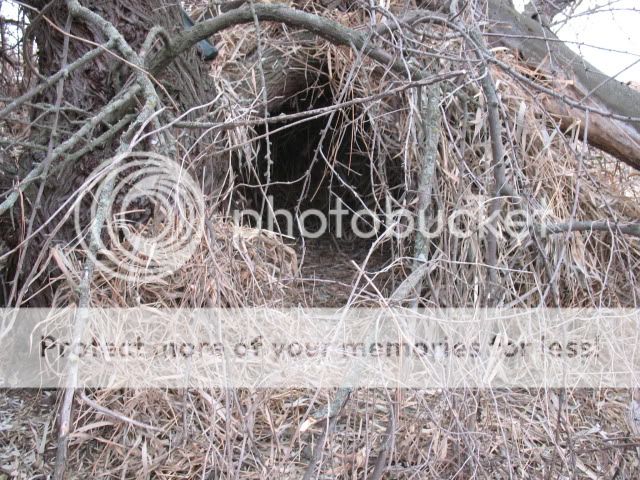

This is my first all natural debris shelter, constructed of only natural components,
and made when weather conditions were close to ideal for winter.
It took myself and my wife 4 hours of non-stop work to complete.
When the door to the shelter is put in place, it gets nice and warm and comfy inside.
If you had the time as others have mentioned, it's a great way to go.
If you are wet and need to get warm right away, constructing this type of
shelter could cost you your life. I would be trying to get a fire going first.
