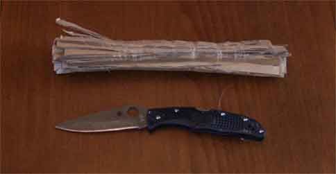

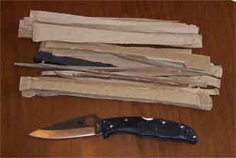

Basic materials :
http://i7.photobucket.com/albums/y269/CliffStamp/Spyderco/endura/fire_bundle_I.jpg
some notes :
-cut thinner and across the ridges to increase burn intensity
-the less wax the higher the intensity
-the tighter the wrap the slower the burn
Intensity and burn time are pretty much inversely proportional. I go for a mix which inbetween, usually cutting the cardboard to give high intensity and more wax for burn time, this gives me the best combination I have seen as there is more material burn so more total heat.
Wrap the cardboard around the rubber, the above just is enough for half as I was testing the differnce it makes. Tied the bundle together, leave the ends loose to allow ease of lighting, and run wax down the center, I use a half a cm wide strip just a drop thick.
http://i7.photobucket.com/albums/y269/CliffStamp/Spyderco/endura/fire_bundle_II.jpg

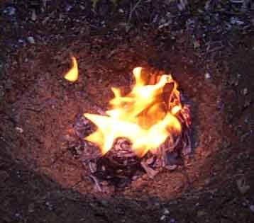

Cut in half and put a tbls spoon of wax on the top, which melts during the burning so the whole thing acts like a big wick. This is a shot of the non-rubber one at 3 minutes into a burn :
http://i7.photobucket.com/albums/y269/CliffStamp/Spyderco/endura/fire_3min.jpg
Without the rubber the times were 4.0 and 3.8 minutes to nothing but embers. With the rubber the times were 7.0 and 6.7 minutes. There was no need to time them, you could see the differnce, even that small strip of rubber burned a long time, you could see it burning as the cardboard fell to ash.
I tested them in high wind as I was also trying to see how they held up there and experimenting with fire pits, a nice piece of hollow bone or pipe is nice here for a draft. Without such high wind the burn times would be significantly longer. These were also not cut cross ridged and too thick a I wanted to compare to earlier burns. I prefer the other way as noted.
