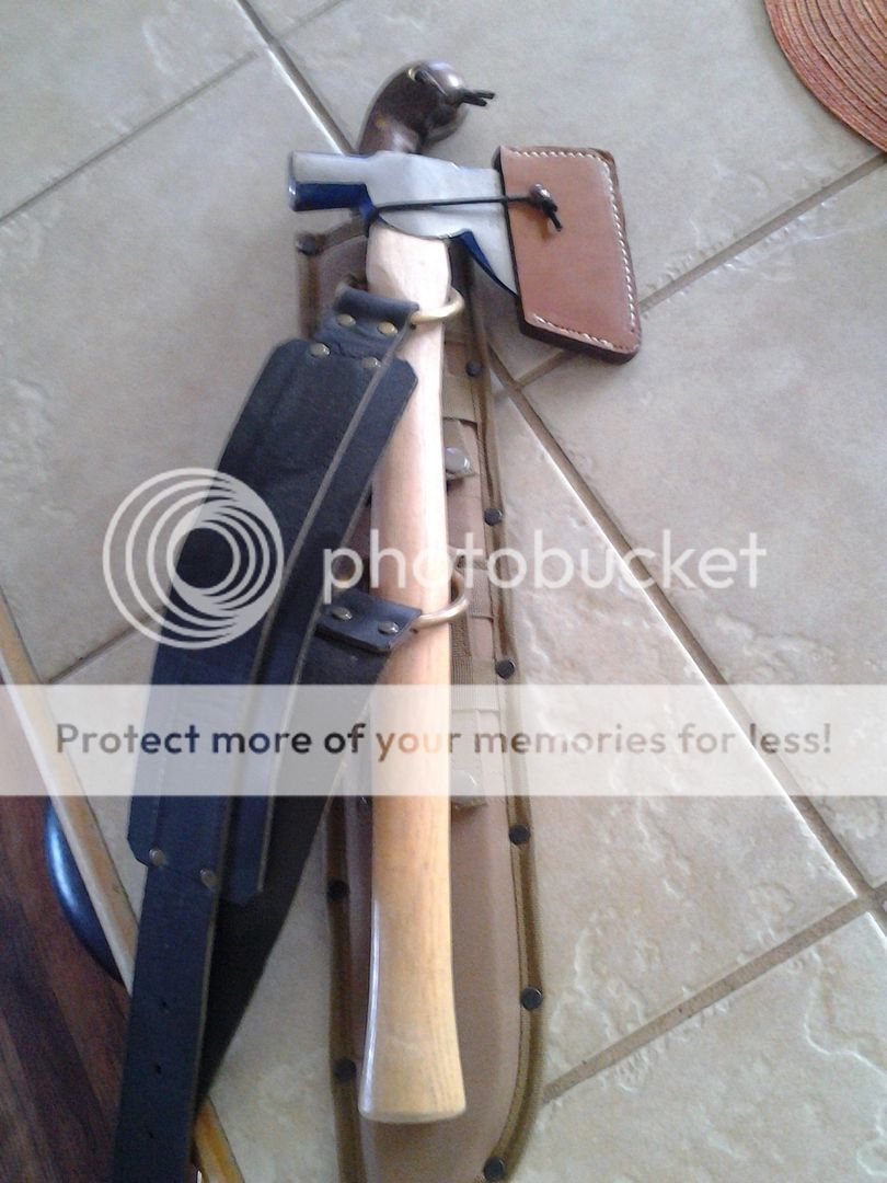

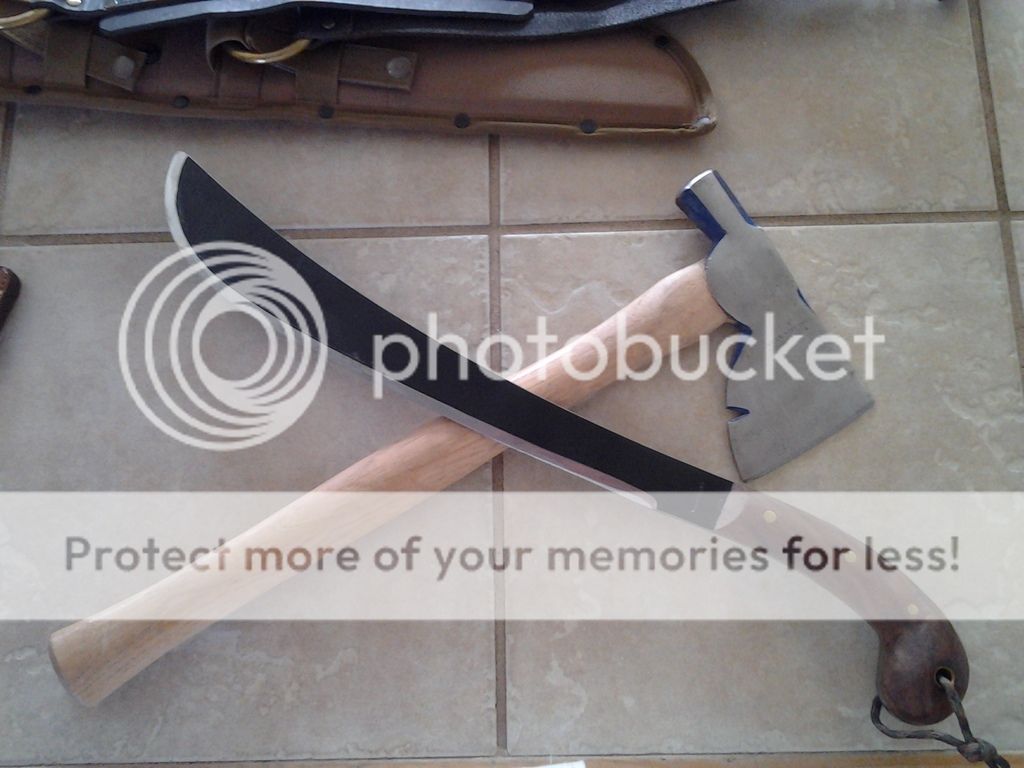

Been at 8000' between Boulder and Estes Park at the base line of Longs Peak in the Elk Meadow Range of Rocky Mountain National Forest nigh on 55 years. I carry this when I venture out. If your going up into the canyon in November, think avalance. Think Ice. Fuzzy Sticks and Kitchen knives are all the rage but Ice falls and Ice kills. And its like that here 8 months a year... :D
Can you say more about how these tools are useful in avalanche terrain? When the topic turns to avalanche gear, I generally think of beacons, probes and shovels. I've not heard anyone discuss the utility of wood chopping tools in that context but I'm not saying there is none. To deal with path making through the post avalanche debris fields, perhaps? Those can be a mess to work trough or around down in a tight valley.
Not debating. Honestly curious.

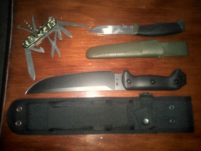

There really is no perfect "one knife fits all", unfortunately; we've all been searching in vain, (and still searching)...
My suggestion, for your "needs/wants" is stretch you budget to $100 even with a slight wiggle room, and buy 3 Knives to suit you, which will handle everything that gets thrown your way on your outdoor adventures;
Kabar bk5 for your deep "camping" endeavors, is a real beast! Called "Magnum Camp knife" for a reason... The 8" blade gives you plenty for chopping, clearing brush, and yet still is a pretty good slicer believe it or not... (And the blade shape is still "aggressive" in the event you would have to fight off a bear or wolf or mtn lion, even if you lose you can leave a lasting mark ;) )
Sheath can be easily attached to a pack or belt, but it is heavy for simple day trips,
So the Mora Companion fits in great for EDC carry, lightweight, easy to carry for those little hikes with the family, or just to carry around town...
Lastly, the Swiss Army Huntsman, with it's smaller thin slicing blade(s) it's perfect for slicing an apple, or whatever "light" tasks come about, and with the saw blade and scissors, can opener and bottle opener, etc. it is a great every day pocket knife to carry, and even on your camping trips or day hikes, will fill in all the gaps your "Knife" alone won't do, (you can find a different swiss army model if you choose, but that is my personal favorite)...
All 3 are easy to sharpen, no frills, and you'll likely never "need" another knife for your journeys; a true pocket knife for EDC, a true "Heavy Duty" blade, and the tweener that fills that gap; If you shop around you can buy all 3 for right around $100...
