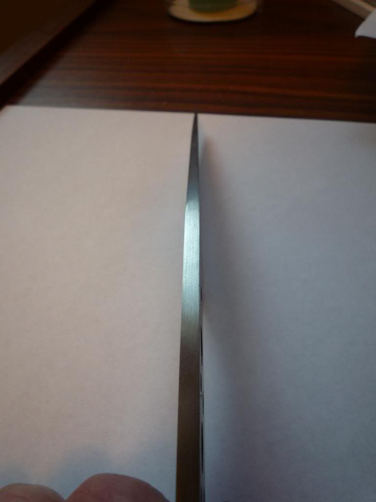

Hi guys, Jason here. I've been reading this forum for quite some time now, and have asked some questions along the way to making my first knife. Looking back in my emails, it looks like I started this blade late January 2008. It's made from 5/32 O1 from Rob and Marilyn up here in Canada. Blade length is around 3.8" and the handle is right around 4".
I cut out the design with a hack saw, and then filed it down smooth. Other than a drill press to drill the holes in the tang, all work was done with files and sand paper. Started the bevels with a coarse Mastercraft file, then when I got the majority of the material off, I bought a Nicholson Mill Bastard file. Man, what a difference a quality file makes! I had heard people talk about Nicholsons, and were they ever right. After filing, I started sanding it. Just working with what I had, I started with 80 then jumped to 180 grit. For handles I'm going to be making up some micarta.
Just looking for some input pre-heat treat. All comments welcome - on design, sanding, plunges, bevels, and anything else you got. Good or bad, give it to me, I can take it all:thumbup:
Here are a bunch of pics:

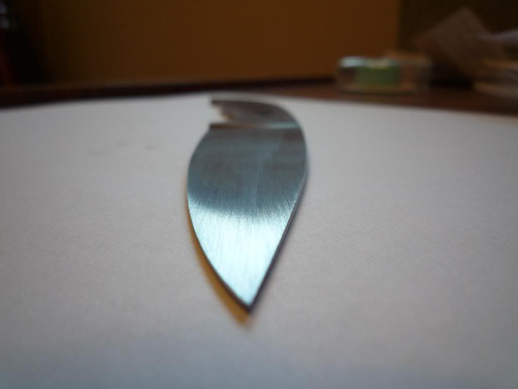

Full flat grind with distal taper.
I left the edge around .027" thick or so. I was told this would be fine for heat treat? I don't have a grinder or anything, so I will be putting on the final edge with sandpaper I suppose.
Thanks for all the help thus far, and any comments/criticisms you can offer!
Jason

You have really been reading and understanding. Looks 10x better than my first at that stage. You may want too round off the plunge a bit so it is not a 90 degree angle. It is a weak point for the blade and will break easier from my understanding.

Thank you for posting pics of the spine and edge! I hate when people don't do that; makes me think they're hiding something. ;) Those plunges are pretty darn close to being even on both sides. I suspect the relatively tight radius in the plunge will be OK on a knife that size. I like the distal taper, too. The overall design looks very handy, although the handle shape isn't what I would choose. Just personal preference.
I notice you laid out the pin/lightening holes in the tang very evenly, that shows craftsmanship and attention to detail. You might want to chamfer them just a bit; I've been told that helps reduce chances of cracking in the quench (although I think there's plenty of steel there so it shouldn't be a big deal). Chamfering does give a bit more area for epoxy to bind to, but that may be a tiny tiny difference in actual use/strength.
My only real b!tch is, your sanding lines are a bit wiggly. That's easily remedied.

Anybody have any suggestions on how I should round out the plunges a bit?

One of the better examples of a file-made knife I've seen, not to mention that it's your first! Great job and excellent attention to detail. As James mentioned, in your final finish, you'll want all scratch lines parallel, but that's easy to accomplish after heat treating and not necessary prior to HT. As for rounding out the plunges, you can pick up a small diameter chainsaw file for that purpose. Be careful not to eat into your spine, though. I would be tempted to finish this one out as is, and try the chainsaw files on your next knife. You can even file in the matching plunges first and then file your primary bevels.

I agree on both points. :thumbup: Look here for a file guide that will help you a lot with your plunges.
The knife looks great. I would run the file down the length of the edge. This probably isn't strictly necessary with O1, but I do it with all knives out of habit.

no arguments about the thickness of the edge but i'd polish it to 400 to prevent stress. Not generally a problem but I did manage to crack a 1084 blade that I'd left at 40 grit on the edge. from the profiling - of course, that was back a while ago when i was trying out brine quenches and I probably would have cracked it anyway.
From the picture, the edge looks to have the filing or grinding perpendicular to the length of the blade. I always make sure that everything on the profile runs lengthwise with the blade to reduce any change of stress risers. In carbon steels that get quenched in fast mediums like brine or oil, you have a chance of getting a crack due to stress risers. The O1 doesn't require quite such a fast oil, but I do it out of habit even with unground blanks that I'm going to heat treat. It takes far less time for me than it does making a new knife.
