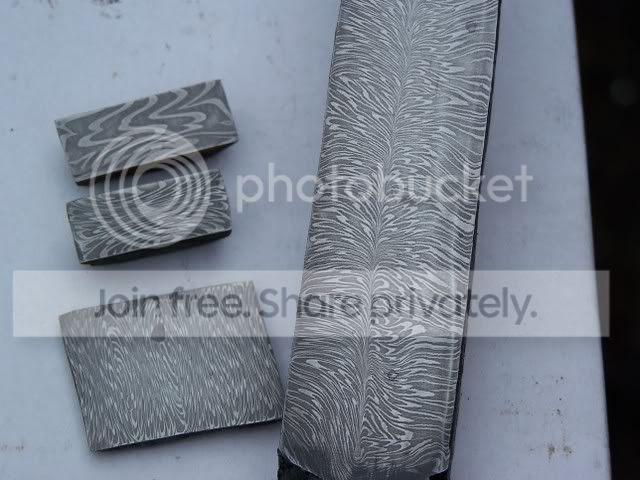

Even though Chuck and Mick both used the same methods of construction and seemingly were both 100 layers, they look quite different. Presumably that is due to differences in drawing out, as Chuck drew his final slices out quite a bit into his blades?
My orig billet was 1.5 wide x 4 tall x 11.5 long. I used 1/4" 1084 and doubled .062 15N20. I forged the billet into the standard W pattern. Folds were done 5 stack. I cut the stack into 5 sections and re-welded. I did this 4 times so 5-25-125-650. When cutting for the feather I pushed through to within .25 of the bottom of the billet. I still had a lot of V left so for the smaller knife I cut a bit off the end to reduce the V effect. After the cut I then essentially cut slices off the loaf, tig welded the seam and dry welded the piece back together.
The [final] billet was 2.5x2.5x4. The first slice I took off did not turn out either. I had to get all the flux and scale out of the center cut. After trying wet welding it, I just cut the seam with the band saw then pressed back together and dry welded. One of those unexpected positives that happen once in a while.
Each piece would make from 1-3 knives depending on the thickness of the slice. i did draw out the final slices quite a bit. The small billet in the photo made one knife, the one shown, which has a 4.5" blade. The larger billet was over 12" long 1.24 wide x .25 thick. Since the billet is being drawn so much the layers do not seem as compact. now that I am totally confused myself I hope it is clearer than mud to you all.

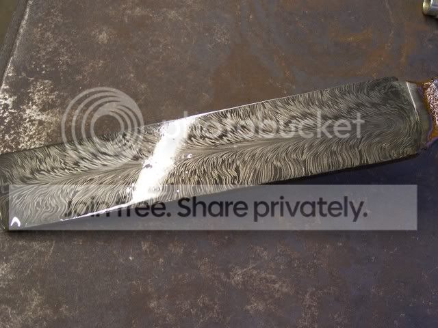

Mick gave me the heads up on this thread, this was the first of my attemps of a feather pattern

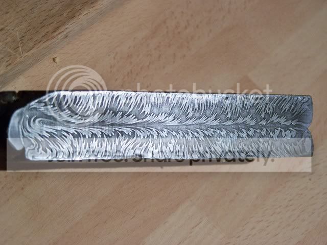

this was my second - called it a "fern pattern" rather than a feather. not made anything out of it yet
and this was my fourth

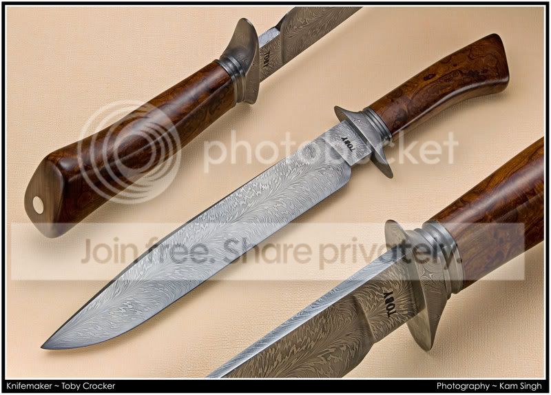

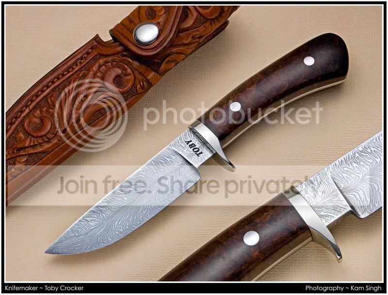

Thats good lookin steel Toby. The two finished knives are awesome man. The 4th picture down has some real depth to it. Looks 3D almost. Thanks for showing them.
Oh hey, first post here? Welcome!
Those are the types of patterns we strive for. Phil I cut down the center then slabbed off the tiles for the blades. Some just use one piece and forge a blade out of that while those with large tools (aarrugh, Tim the tool man Taylor) forge bigger billets.

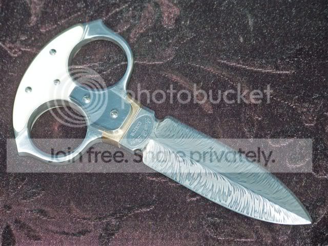

I have shown this around before but I still like it. Its about #3 and came out short so I made a push dagger. The guy that bought this one sent it off to Sam Welsh for engraving and then to Pete Mazur for french grey finishing. I wish I could get a picture of it when Pete is finished. Sorry for this cheapass shot.
Wow Toby, that's GREAT. Not a typical first post. Talk about advanced stuff. I'm liking the look of that sheath too.

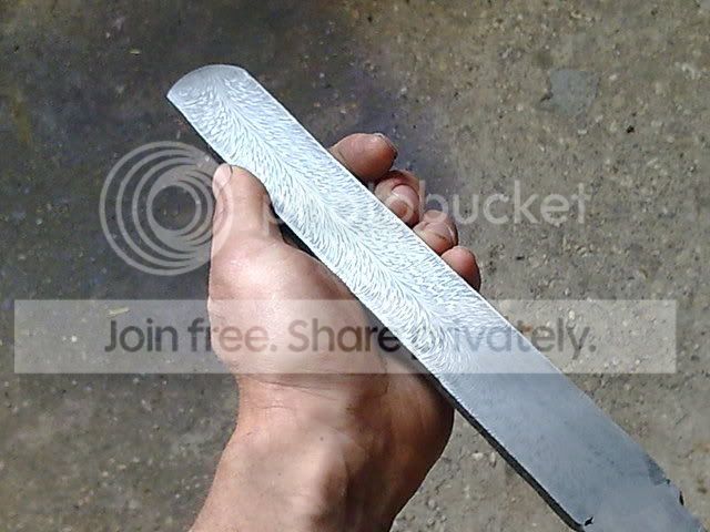

Something that I am wondering is how much of the smeared cut do you grind off? I played around with a billet today and the finished bar has a group of lines equal to the layer count running down the center of the bar. I am not seeing this in the photos posted.
I used a 1/4" cutter that was pretty sharp to make my cut so I am guessing that much of the inside on the photos posted here is ground off before rewelding?

Brian, The cutter needs to be very blunt. I put a radius on the edge of the SS 1/4" plate which would equate to about a 1/8" rad. I did not remove that much material when I cut out the scale from the failed weld. My band Saw has a .032 thick blade. The pattern is made by the drag of the layers down to the flap remaining. If you have a picture of your billet it would help troubleshoot your situation.
That center weld is a tough one to reweld. I dont know why it would be differant than any other weld but somehow its a pain.
I also had real trouble slicing the billet. They say to use a dull chisel with a 1/4" radious on it but my billets would just smash and bend instead of cut so I sharpened it pretty good. The dull chisel would even delam some of the tender welds with that much pressure. My billets werent as big as your 20 pounder and maybe that adds to the tearing and bending.

This is a shot of what I am talking about. notice the band of "lines running down the center of the billet. I am also wondering if it is how I worked out the billet, squeezing too much on the sides.
Please excuse the slag, I did a quick grind and etch. The billet is still a little over 3/8" thick so I didn't get too fancy since it needs to be thinned down yet.

I am seeing a couple of things. It looks almost like you got a couple of layers oriented wrong. I am seeing W's but I am also seeing a lot of straight pattern. Also did your cutter actually cut or did it just create a U. It almost looks like it bent rather than cut the billet or it did drag too much. I had to do my cut very hot, just below welding temps. This also helps prevent tearing the "tender welds". I took my time getting the cutter through, Like 5 heats. You have an interesting looking billet anyway. That is what I like about Damascus, As long as the welds are solid most all have interesting patterns.
