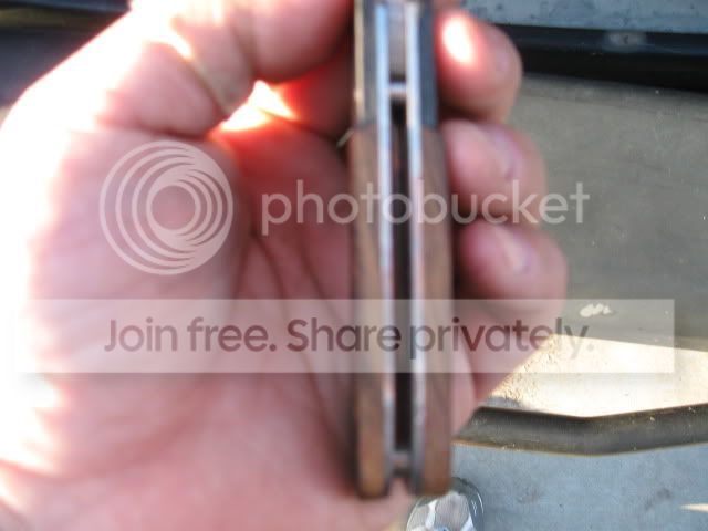

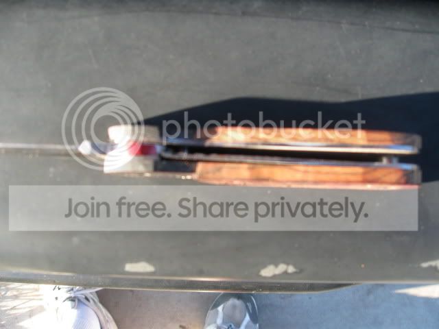

Finally had a little time to do some more work on this guy. Here are some pics. I am worried that I went to low shaping the liner by the blade. The lock groove or whatever it is called is visible. CRAP!!!! Should I scrap it or is this ok?

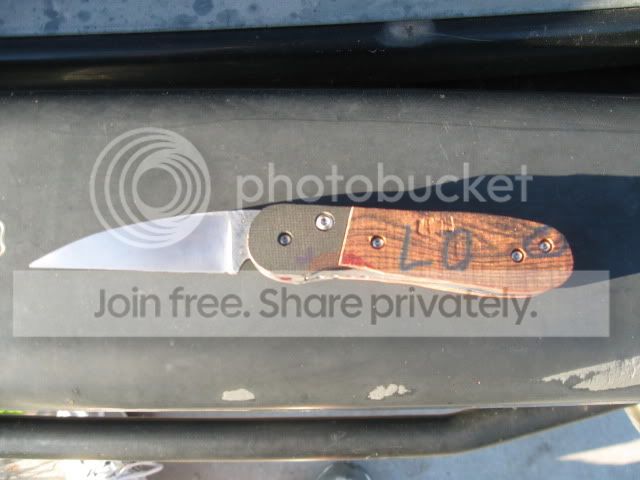

I raise ye thread from the dead for an update. Here is where I left off months ago. I havn't had the nerve to continue. I don't like the blade to handle ratio so I need to stare at it and think a while before I do anything to it. My courage is beginning to build. Any advice?
I think it looks pretty great! Remember, folders will always have a longer handle than blade :D
Just go for it you will learn alot by the time you are finished.
That one looks good and keep at it.
I have scraped alot and only had some that came out good but i have learned on every one that i finished. JRH
I like it Frank!!!!
Once you round off the handles and bolsters the frame won't look near as big as it does now.
Have you ever done this before, rounded off a folder frame?
If not, the best way is to do it slack belt. Start with a 60 grit belt but don't take too much stock off. Then go to a 120 grit and take the handles and bolsters 95% of the way down to the finish. That will leave a little to remove when you're smoothing out the knife with the finer grits.
Hope I didn't jump in and sound like a know it all or anything!!!
You're folder will come out real nice I think!!!
