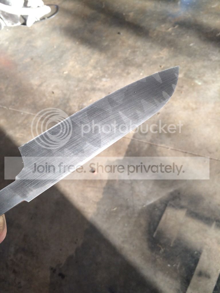

I tried my first go at some San Mai yesterday. It's 15n20 with 1095 core. I need to clean it up, profile, and rough in the bevel this afternoon and see what I have. This is the first I've worked with carbon steel that I will be heat treating. Do I need to normalize it from the laminating process? I will get some pictures up later.

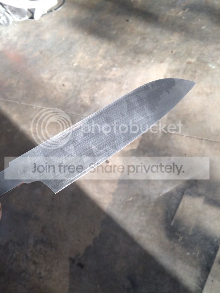

Edit: I did a quick etch after roughing it in and this is what I have. Is It seems I have both steels on the edge. The edge is still .035" or so. I started with 2 pieces of 15n20 on each side of a 1095 core. I'm assuming the darker part is the 1095? So, what went wrong and any tips on what not to do next time?Will this be ok since both steels will harden?
Yes you need to normalize and thermal cycle it before heat treating. Otherwise your grain will be huge from all of the time at welding temperature.

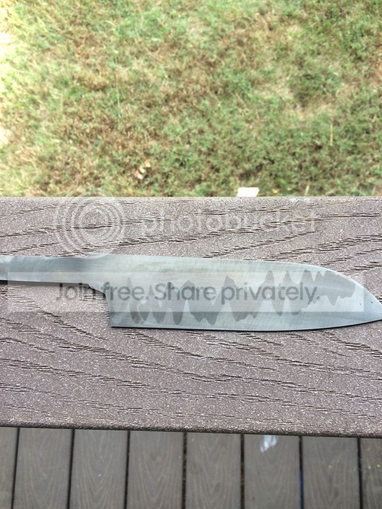

After some more grinding this is where I'm at. Looks like I didn't have the core centered or something. Next time I will use a thinner core and make a taco with the sides and maybe I'll have better luck.
It helps me to count my hammer blows as I'm forging sanmai. If I do 10 on one side I do 10 on the other side. If you do this your core should be centered without much trouble. Before you grind into it make sure you check to see if it is centered...grind the edge free of scale and crap and wipe it with some ferric chloride.
Thanks Jeffery. That makes a lot of sense. I also am going to use stock closer to the length I need so I don't have to stretch it as much. This started at 5" and ended at 10".
What kind of press dies where you using, it looks like you where using aggressive drawing dies. How thick was your core and sides? When using a press you should not have s problem keeping the core in the center as long as the press dies are the same on the top and bottom. I also flip my billet over on the next heat. If you billet comes out of the press with a curve then it's stretching it more on one side then the other. Also make sure when using a press you keep the scale knocked off the billet. The scale will build up creating very thick sections and even though your billet looks flat it's not because the scale. Usually a quick press on the edge will cause the scale to pop off. If not then go to the anvil and give it a once over with the hammer. If that fails the flux it and get it nice and hot and brush it off.

So keep working at it and you will get better. I would still finish that knife, the pattern looks very unique and 15n20 is an amazing steel so don't wory that it's on the edge.
Thanks JT. The billet did curve and yes I was using drawing dies. The core was .125" and the 15n20 was 2 pieces of .100" per side. I am going to finish it anyway because it looks pretty cool. I will try and see if the drawing dies are even and see if I can true them up if not. How much different is welding say 416 and white paper? That's what I would like to try once I figure this out.
