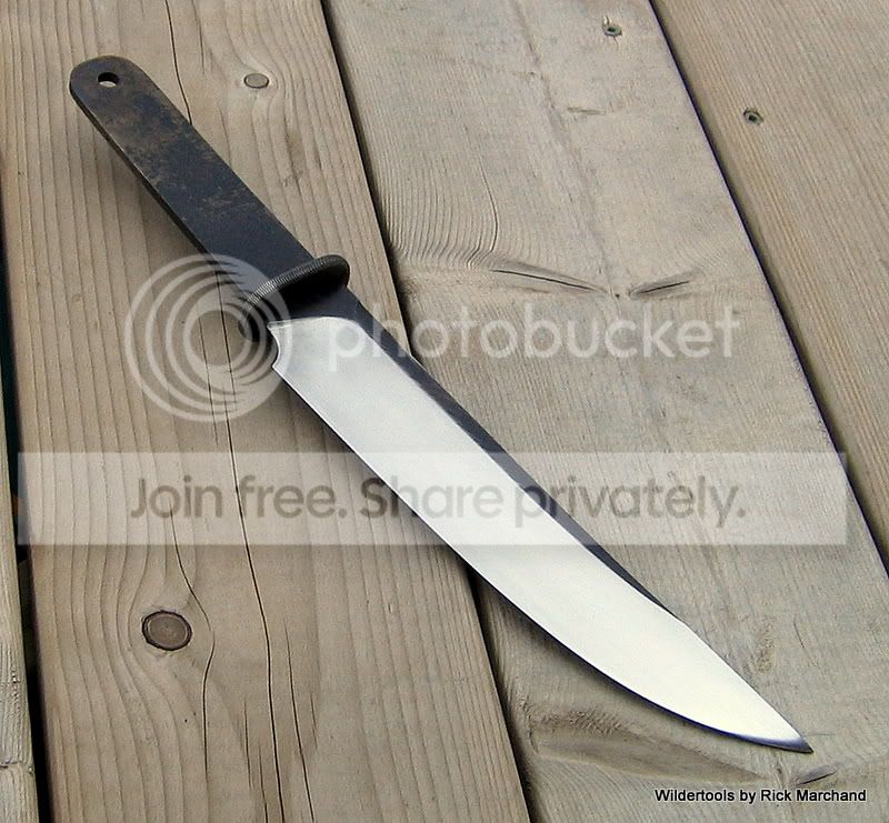

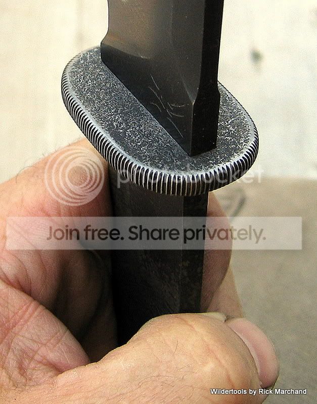

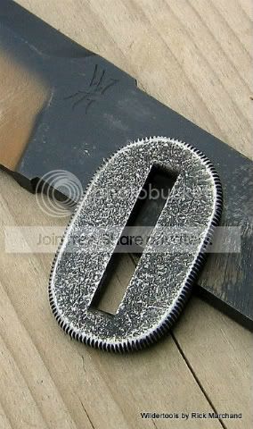

Hey guys.... ya, I know... 4yrs and this is my first attempt.:o Never felt the need for a guard. This one just kinda talked me into it.:thumbup: Not sure the best way but this suit my rather "raw" style. I cut the hole a little undersize and hot fitted it to the tang. It almost seemed too easy. I could imagine it being a PITA if someone was trying for the clean look. I'm just a dirty boy...
Any tip, hints, comments, suggestions, critiques, insults?
Rick

Hot-fitting is cheating! Us stock-removal guys only get one chance to get a fit that good. :mad:
I like a little more shoulder for the guard front to seat up against but it's probably not a huge deal. How you going to seal it up? Solder? JB-Weld? Hemp twine and pine resin? :D
It looks like you made it to very close tolerances, not at all like a "first-timer" is SUPPOSED to do.
But the edge, hmmmmm, I guess you just didn't have time to "properly" finish it, huh? ;-)
How did you cut the serrations? Aren't the serrations supposed to be on the blade? (yea another joke)

Looks good for your style. If that's the forge finish from hot fitting still on the
guard, I'm impressed that you managed to keep it that flat in the fitting.

That thing is a pretty darn good press fit... but I'm planning on using JBweld to seal it up.

That is the finish from the hot fitting. A little fitting, make it flat, a little fitting, make it flat, etc....... I think I went back and forth about five times until it seated properly.

I think the tang shoulders are to small for a seppa, Stacy. Now you have me wondering if I should try my hand a "texturing" a faux seppa in.... hmmmmm.

That will definitely work! Always use something to seal it up no matter how good you think it fits. You will probably squeeze out 99% of the JB-Weld when you assemble the guard but that's OK. It's not there to hold it on, just for that extra assurance moisture can't get under the guard.
