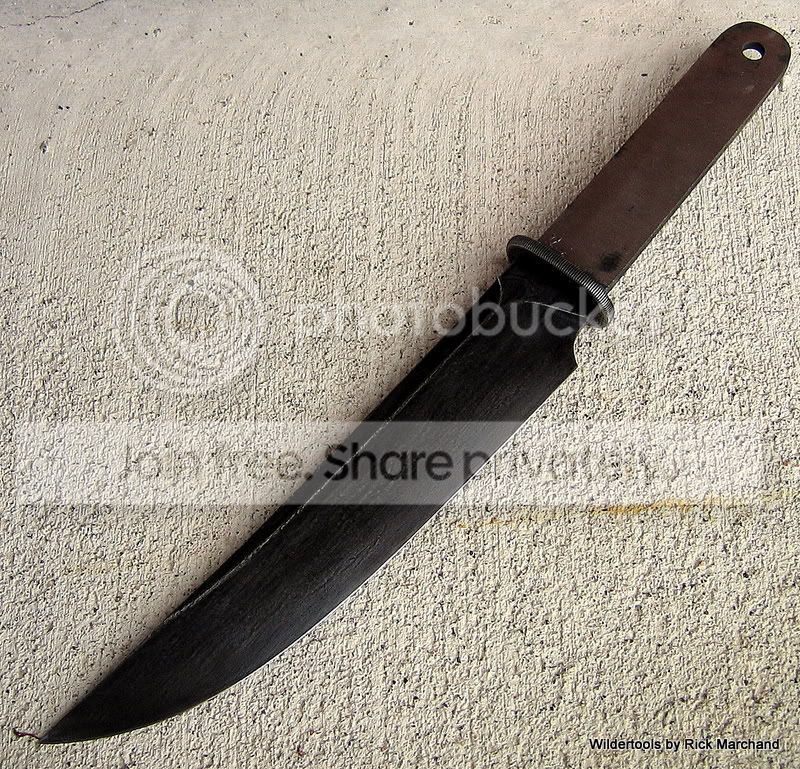

So where is the video of the hot fit? :confused:
You know the rule no pics it didn't happen!:eek::D
Hey that is coming along great, I can't wait to see the finish on this one!:thumbup:
Great idea hot fitting it. And fantastic results. You not only nailed the fit but it's perfectly in line with your style. Great stuff!!
Rick, that is a bang up job for a first try........or a tenth try for that matter!!! As for JB Weld, it is a good thing to use even with a close to perfect fit. The mortal enemy of carbon steel blades, moisture, can wriggle into some very tight spots, ya know.
What did you use to cut the hole before hot fitting?
I did the typical "drill holes along a centerline", then I used a 3/16" (.1875") round chainsaw file to open them up. I didn't bother to square anything up. The shoulder section on the tang was at .220" and it tapered to about .175". The guard slid onto the tang only about an inch and a half at that point. I heated the guard up in my forge, then using a pipe that was crushed down to fit over the tang, I began to hamer it down. It took about five heats and in between I would hammer it flat. I figured I would have some cleaning up to do on the flats but what you see is how it finished. Then I shaped the edges and put the jimping in with a checkering file. It didn't take much brain power or back and forth filing... but probably took just as long to do. From the time I cut the square off, it was just under 2hrs to get to what you see in the pictures.
What I like about this method is that I wouldn't have needed any measuring tools and if something didn't fit right, I would just hammer it back down and have a second go at it.

Haha, looks awesome! Now you have me thinking about doing hot fit guards.....Good idea.

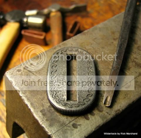

I liked Stacy's suggestion of a seppa. There wasn't enough shoulder on the tang (IMO) to accomodate one, so I did the next best thing (I was capable of). Sam Salvati's decorative punch thread kicked in a little inspiration on this one... I made it out of 5160 cut-off
Rick you make me sick! those are great. I would suggest soldering it on but the solder would make your Dirty Boy knives look even more dirty! I really like the Sam stamping I am really Looking forward to seeing the new guard in place.
That looks great. Love that punch. Hmmm... ideas..
What's with the habakis in the background?
