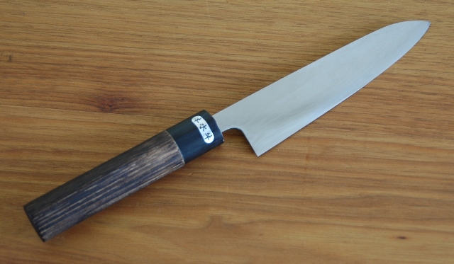

I'm not exactly sure what you want out of a "general purpose" kitchen knife. Decide exactly what you want to use it for and how you want to use it, then make your design accordingly. The shape and dimensions of your design fairly resemble a petty or a funayuki, which are both great knives and could fall under the "general use" category.
Petty:
Funayuki:

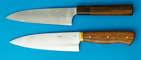

I think the handle of your knife may restrict your ability to hold it the ways you want. If you look at the handles on high-end, custom kitchen knives, they tend to be very simple. Consider these two handles from Master Smith Murray Carter, who is a very highly-regarded maker of kitchen knives:

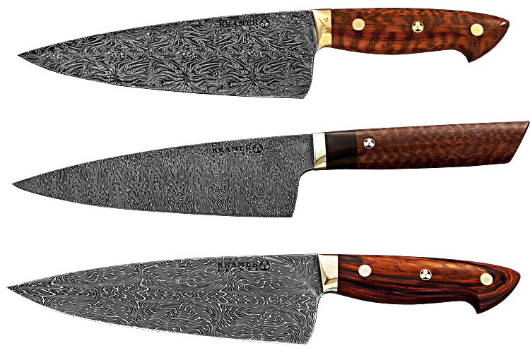

Or these from MS Bob Kramer:
I like the lines on your knives from an aesthetic standpoint, but I think you can do better from a design standpoint.
That said, kitchen knives are not the easiest knives to make, so you may want to go in a different direction for your first knife. If you curved the blade a little bit more, I think your design would be a great hunter or utility knife and would be a fine choice for your first go at it.

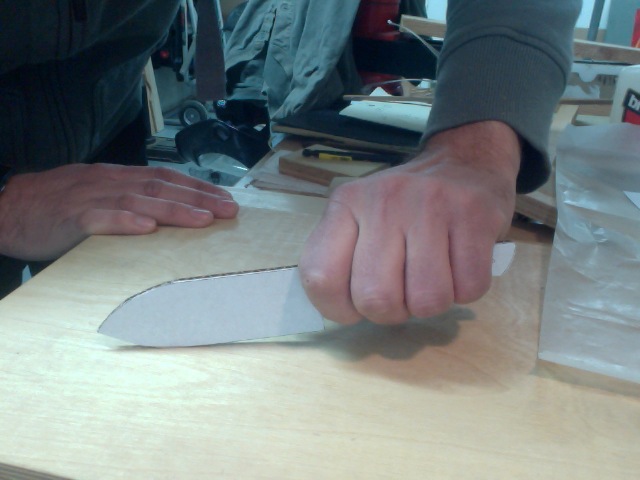

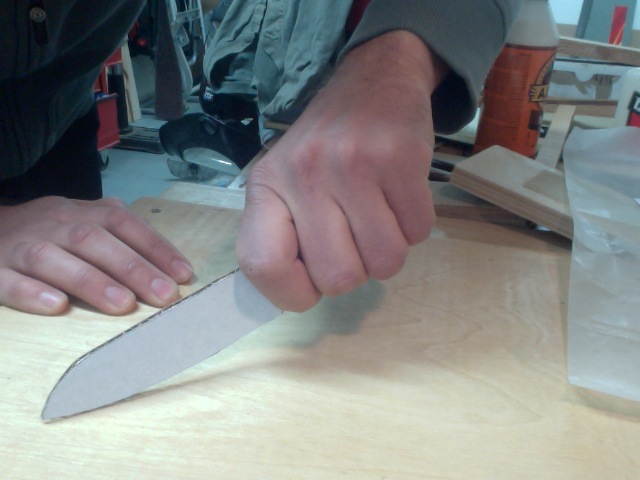

Okay, I made a few modifications to the designs based on comments. I pushed the finger notch forward to improve middle finger ergonomics on one version, and went to a flat handle (and different overall design) on the other version. On both I have made the knife less pointy.
Have a look a the attached drawings and cutout shots. Comments/observations/criticisms and awkward jokes are welcome.
(Pardon the awkward position I'm in for the handheld shots)
Blindrobert, from your photos your hands appear to be sized similar to mine in the average to maybe slightly smaller than average. In my opinion, in both of the revised patterns the handles are too small for you, let alone a bigger guy. From the photos your knives appear to have a 4 to 4 1/2" blade. In my limited experience, both of those knife styles are considerably larger in blade size, likely even twice the size you have them. The scale you have them drawn to doesn't look too bad, maybe try increasing the overall size by 50% and see what you think of them then.
+1 on getting the advice you are beforehand. The first few knives I made, looked good on paper, felt good in the hand when I cut the pattern out, but were a full inch short in the handle when I put the handle scales on.
Good luck,
Chris
Thanks for the feedback, Salolan. My hands are actually quite large - that is, they are very long with average thickness fingers. I wear a size 12-13 ring on my ring finger if that tells you anything.
Yes, what I determined from the cutouts is that the handles need to be at least a half inch longer. I'm going for a smaller version of a knife I already own (made by Global). The idea is similar function in a smaller footprint. I oftent cook for one or two, my kitchen is small and I often work on small cutting boards and the bigger/longer knives aren't well suited to that.
