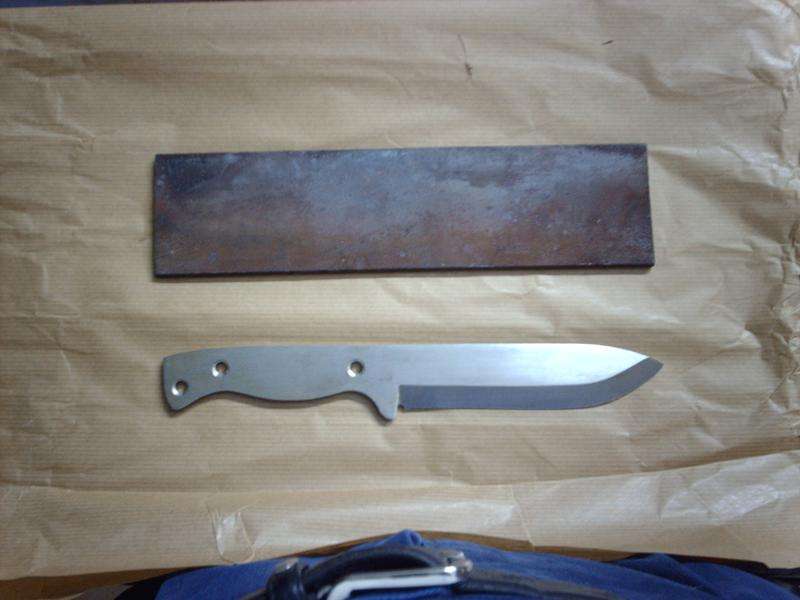

I bought four pieces of 250 x 63 x 5mm steel from leaf springs. The guy I bought them from straightened them for me (more or less) but warned me that they were already heat treated. I had to anneal it.

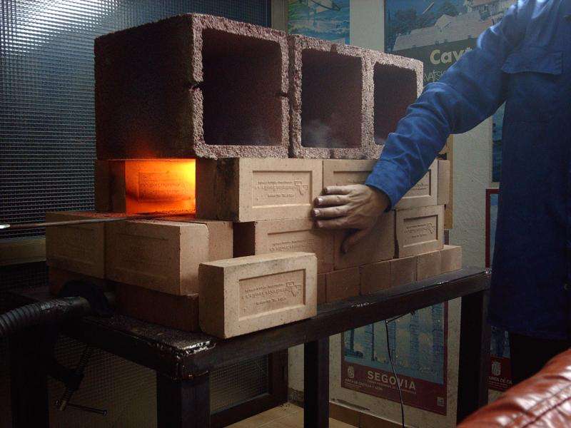

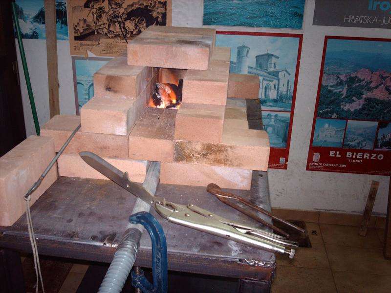

I built a multiple-duty steel workbench out of sheet metal, square tube and angles (it is like 100kg). I had never before welded anything together so don't come to hard on me... I know the welding is pretty crappy.

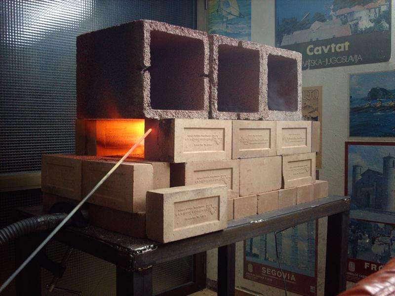

I also got like 65 fire bricks and stacked them to make a forge. I also drilled a like of 4mm holes in a piece of steel pipe and conected it to a hair dryer (yep... my mom found out... I am in big trouble!). That should do the trick.
PICTURES 1, 2 and 3: The forge cranking.

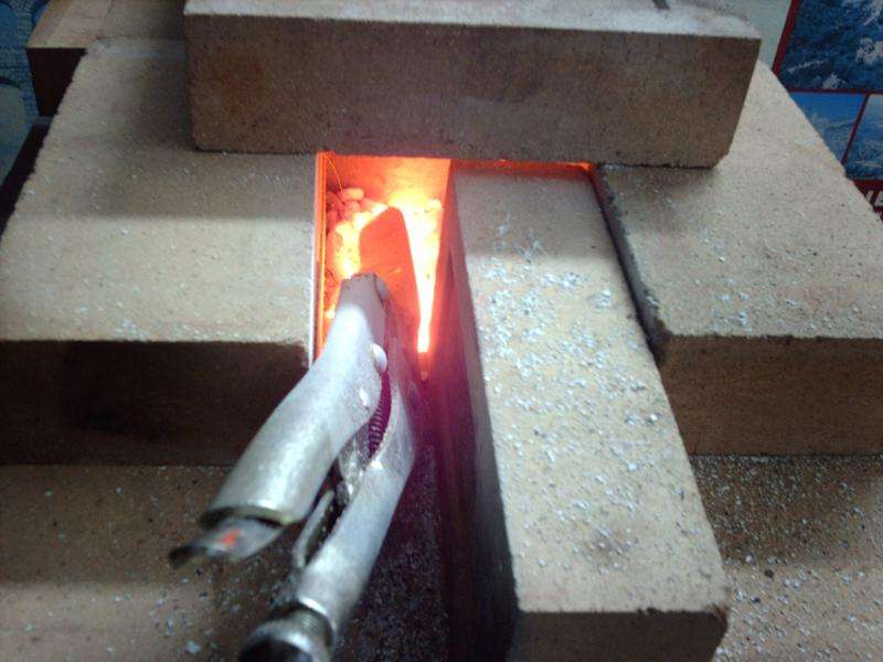

That's a spear from a spear gun I had handy 8I have a lot of them because as soon as it bends, then it doesn't shot true any more). I didn't have a center punch so I sharpened it, heated it to red hot and then quenched it in water. Then I cut it off with the angle grinder and there we go! Brand new center punch for $0. As you can see the fire bricks insulate quite a lot.

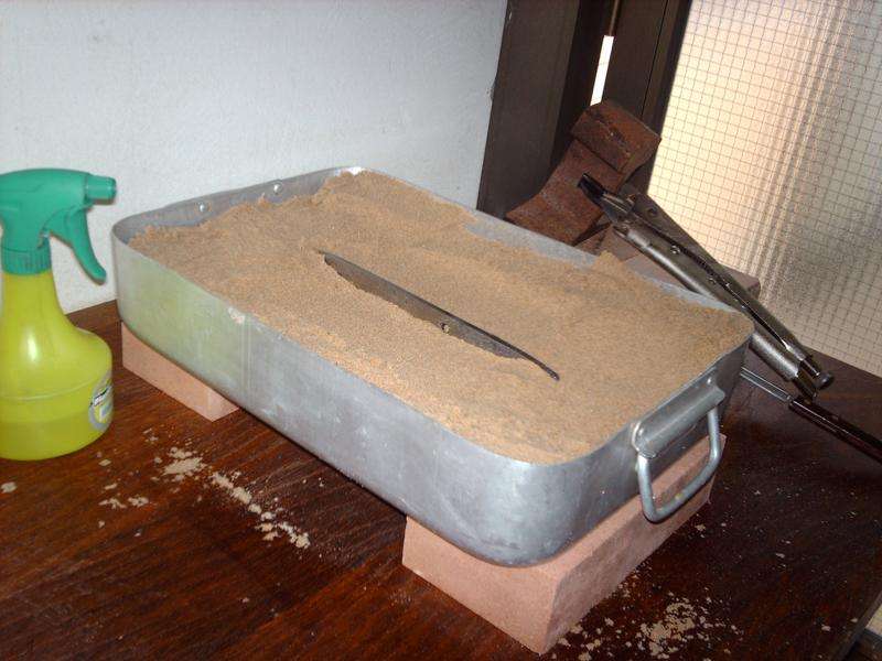

I dumped like 4kg of charcoal in there, ligthed it with some tablets and switched on the hairdryer. Buried the pieces of steel in there and keep the air going for 30 minutes. Then I put some more fire bricks on the only opening of the forge, switch the hairdryer off and went to bed.
12 hours later I still couldn't touch the bricks without gloves. I had coals still red hot inside. I opened it a little bit and waited for it to cool off by itself.

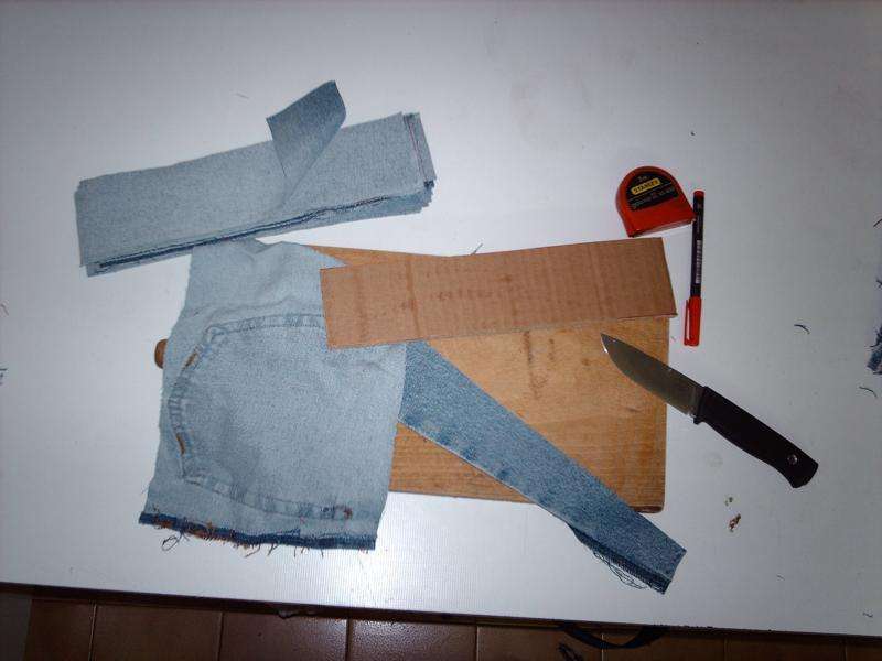

While I was waiting for the steel to cool off I made another slab of micarta. I have a lot denim left so once again it was going to be blue denim canvas micarta.
PICTURE 4: Cutting denim strips.
I found out that 14 strips from regular jeans are plenty thick for my purposes. The cleaner the edges, the less you will have to trim after unmolding the slab. My F1 gives me much neater edges than any scissors at home.

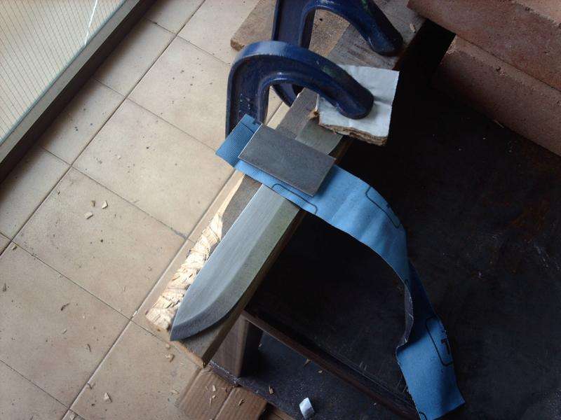

Once you have that done it is time to cut the bevels. Following some forumites advice I stuck to a scandi grind.
To do so I built a rig for the blade and the file ala GreenPete.
PICTURES 7, 8 AND 9: The rig and the intended use.
As you can see the picture of the blade there does not correspond to my first knife. I didn't take any pictures of it while doing it so I am using the pictures from another blade (I am working on it right now, full flat bevels already cut... sweet! :D)
The main idea here is to keep an even angle. It is going to get screwed up in the tip but try to minimize it keeping the file square to the blade. You can rough them out with the angle grinder and then use the file... otherwise it is going to take hours. Firs do it with a rough file and then get rid of as many scratches as possible with the fine one. That will make your life easier when you attemp to polish it with sandpaper.
Once you are happy with the bevel on one side... don't take the rig out of the bench vice! Just loosen the screws that attach the blade to the rig and drive it in from the other side. That way you will have both bevels with the very same angle.
Some tutorials say that you should leave the edge like 1mm thick or so to prevent it from burning when doing the heat treat but I guess that's just for anything but scandis. If you do that in a scandi grind knife you will have to spend endless hours trying to wear down the bevels to make a sharp edge.

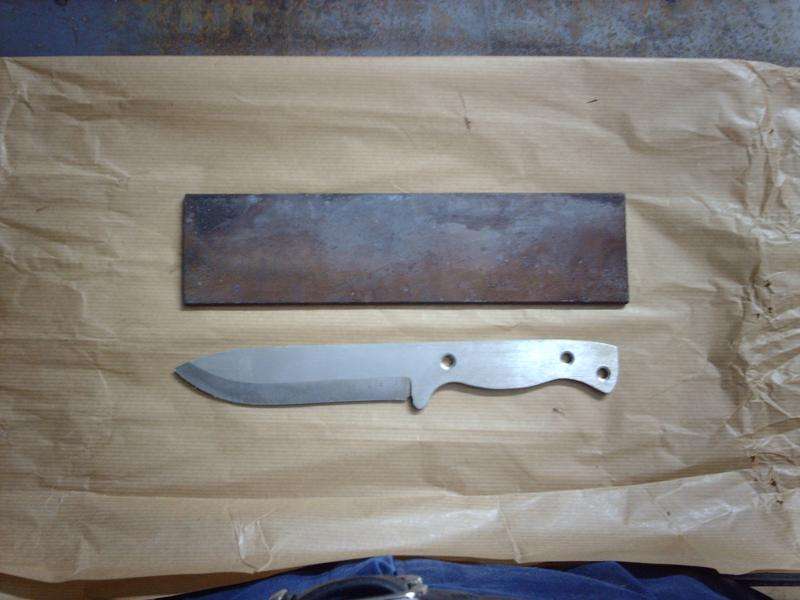

Once the bevels were cut and I was happy with them... it was time to get rid of that nasty black scale that covered the whole blade. I started to get at it with 220 (yeah... call me stupid...) and didn't see any progress.
Few hours later I found out about draw filing! Oh boy! I got rid of that nasty crust in no time. Now I had to deal with deep file scratches but at least this started looking like a knife.
I sanded it by hand up to 400 grit but didn't touch the bevels at all. I am planning to give it a good sharpening session once I get my 10" DMT (coarse/fine).
This is what I got before heat treating it
PICTURES 10 AND 11: The blade and a piece of leaf spring equal to the one I made it out of.

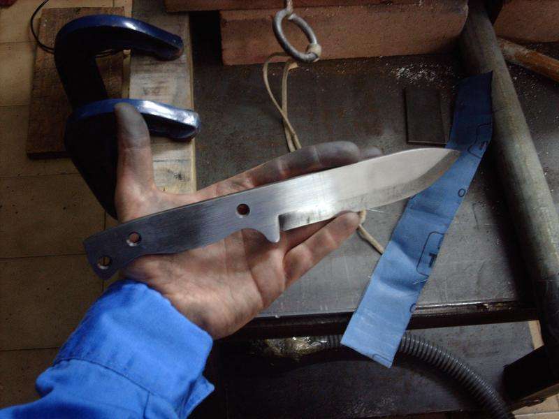

HEAT TREAT

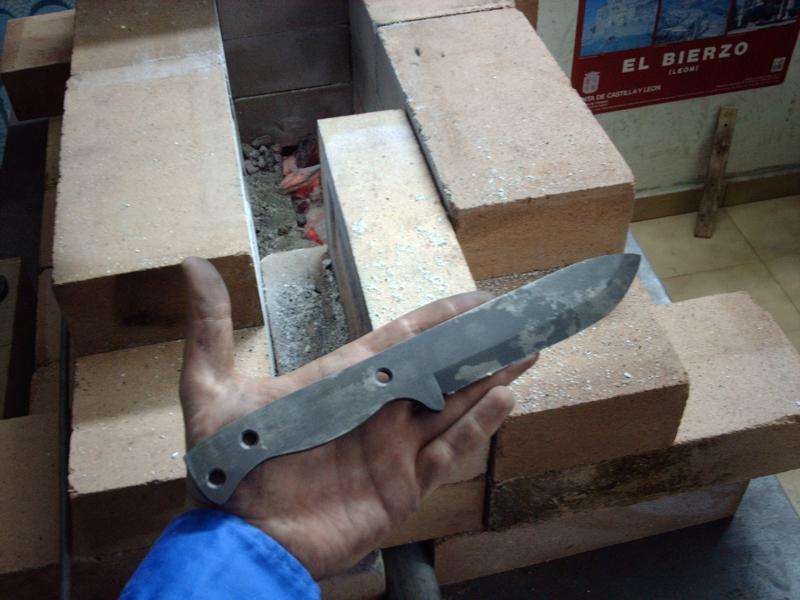

I got a galon of used motor oil and a suitable tin can. I got everthing set and brought it to red hot.
PICTURE 12: Everything set for heat treating the blade.
PICTURE 13: Blade red hot (can't tell by the picture, just trust me). I also checked for non magnetic with a magnet.
PICTURE 14: Giving it some more heat (this is 5160 and I read somewhere that you have to heat this steel a little above non magnetic for the best heat treat).
I read in a few sites that you are supposed to quench only one third of the blade (the edge) untill the flames from the oil are gone and then fully submerge it untill the smoke is gone. Once you are done take it off and let it cool in open air.
The problem is that I read that AFTER doing my heat treat. I just got it red hot and fully submerged it in the nasty engine oil for a while (10 minutes or so). Then I cleaned up with a scotch brite pad and some detergent.
This is what I got
PICTURE 15: Hardened blade.
The first thing I did after heat treating it was checking for hardness. I tried to file it and I couldn't. The file just skipped on the blade ... on the whole blade to be fair. It was hard, that's a fact. I sanded it again to 500 grit and got it ready for tempering.
PICTURE 16: Blade all cleaned up ready for tempering.

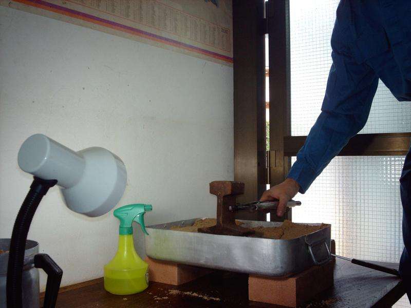

I also read somwhere that you could temper the spine of a knife touching it for a while with something that was red hot. The only substantial metal slab I had there was a piece of a railroad so I did it like this.
PICTURE 17: The setup.
I didn't want the edge to get too hot and I didn't have any clay. I live like 50m away from the beach so I just went there, got some sand and dunk the blade in it. I also wetted it to make sure it cooled my blade propetly.
PICTURE 18: The procces.
I kept moving the piece of rail road to make sure I heated the full length of the spine. After doing so I let it cool off by itself. Once it was cold to the touch I tried to file the spine and... I scratched it good (next time I will be more gentle...)

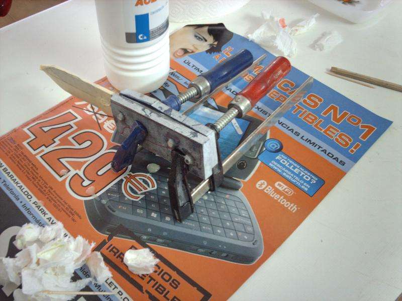

DRILLING AND GLUEING THE HANDLE
Now that the blade was fully heat treated (my way... it can be done way better) it was time to finish it and glue on the handle slabs.
PICTURES 19 AND 20: Finishing the blade up to 500 grit (satin finish)
I didn't have much time so I didn't even rough out the shape of the handle. I just cut two pieces and drilled them using the blade as a template. I shaped and finished the front of the handle slabs.
I was using 6mm pins and drilled the blade with a 6mm drill (countersink with 8mm drill bit) bit but I drilled the micarta slabs with a 6,1mm drill bit. That should give me enough clearance to allow some epoxi to get between the micarta and the pin for a stronger bond. That will also eliminate any strain on the handle slabs preventing cracking. If anyone is going to use 1/4" drill bits, try to get a 6,4mm euro drill bit for your handles.
I used Araldit Standar. This is a 72h epoxi with a 60 minutes pot life. Enough for what I need. This is pretty much what every knife maker uses here in Spain.
PICTURE 21: Glued handles waiting to cure.

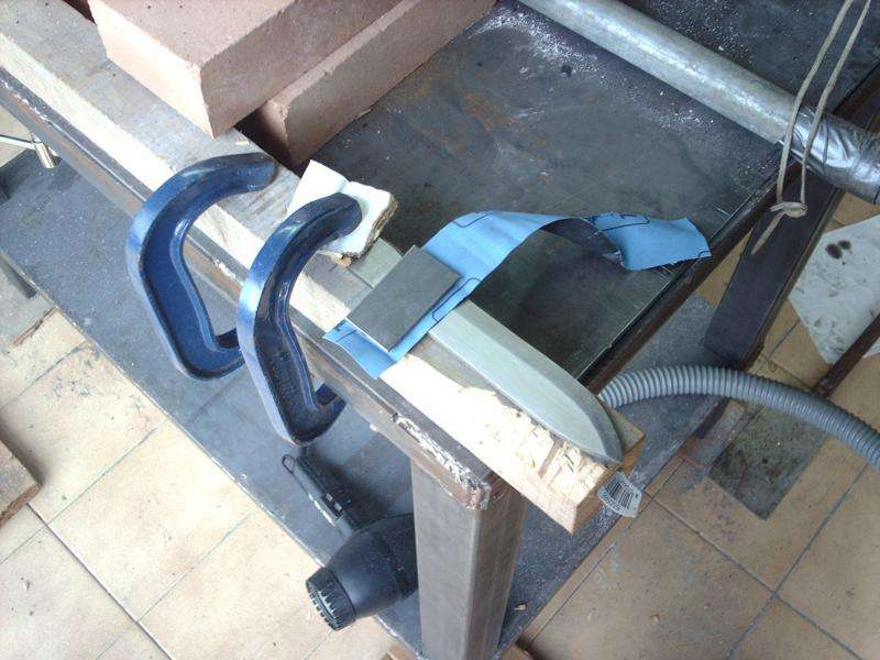

My blade was not perfectly flat (leaf springs are not precision flat ground stock by any means) so I didn't clamp it too tight allowing the epoxi to fill in the small (less than 0,5mm) gap.
I used the chisel shaped wooden stick with the acetone wetted paper cuts to clean up the excess epoxy on the blade in front of the handle. It didn't work out as expected and when I went back at it for finishing it off there was a thin layer of epoxy there. Just scracthed it with my nail and got rid of it but in the procces I scratched the blade.
