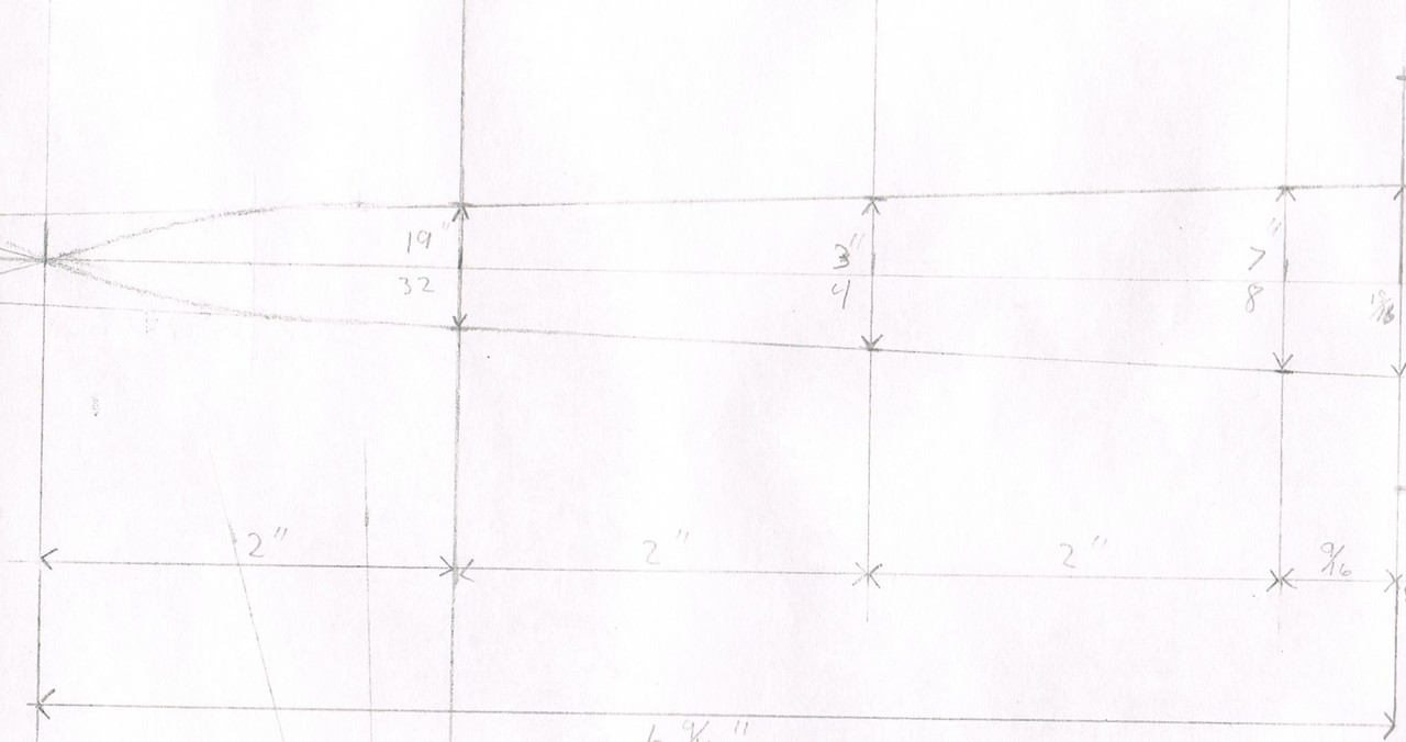

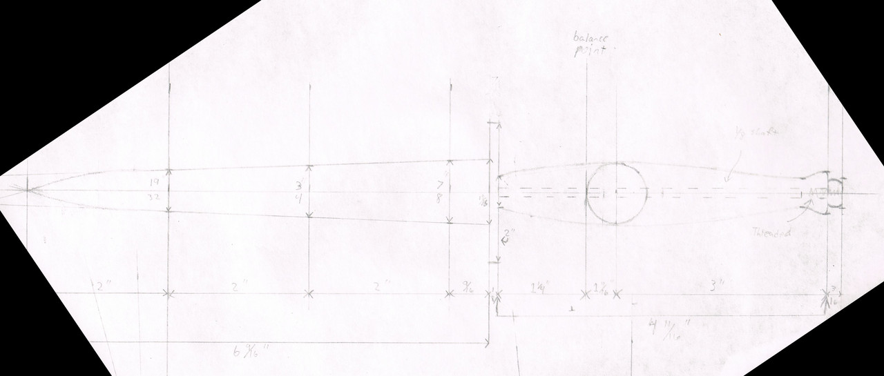

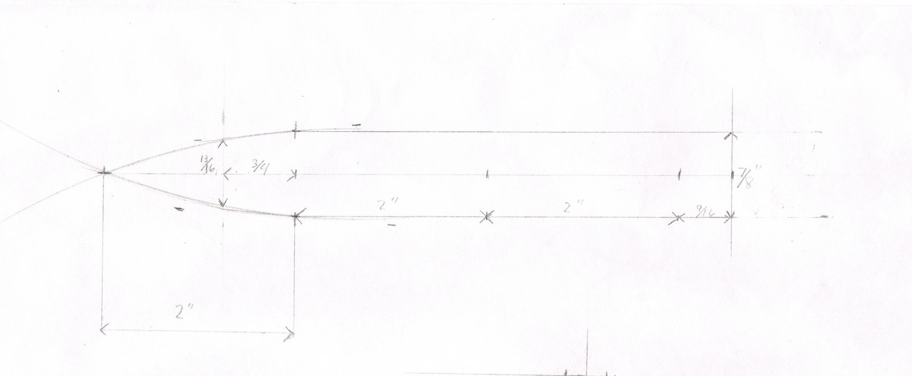

OK, got some pictures for yall. lonepine got me thinking about blade designs, and this is what I've recently scratched onto paper. Which looks better to you guys?
The tapered blade is the original Sykes blade, and the non tapered one is the knew blade design. Should I stick with a 7/8" wide blade, or should I go smaller.or bigger?
I really don't know much except for an article or two I've read, but it seems to me that a narrower blade will penetrate better (point first) than a wider blade. If I recall correctly, one of the reasons the Sykes/Fairbain was the size and shape it was was to fit between ribs and long enough to reach vital organs.
Personally I like the looks of the Sykes/Fairebain. Strengthen the tang and flatten the handle some.
I just remembered another problem with the Sykes/Fairebain. The handle, especially when made of metal would get slippery when whet, and being round in shape meant you couldn't tell the orientation of the blade if it was dark.
