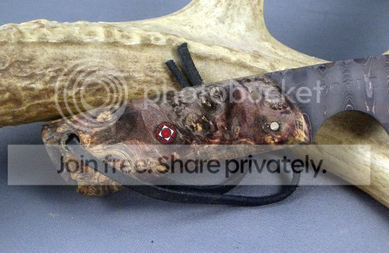

I see what you're saying, I didn't picture your pins in the bottom drawing as being for your bolsters. I make a lot of knives,(like the one in the picture) that have two small pins up front, in the wooden handle, so I guess that is what I saw when I looked at it. It is also a pretty easy way to go if you aren't set on bolsters.
I stand corrected, your pin placement should be fine then. I would still extend the ricasso out a bit though.
Got a picture of the whole knife? That is beautiful from what I see of it!
