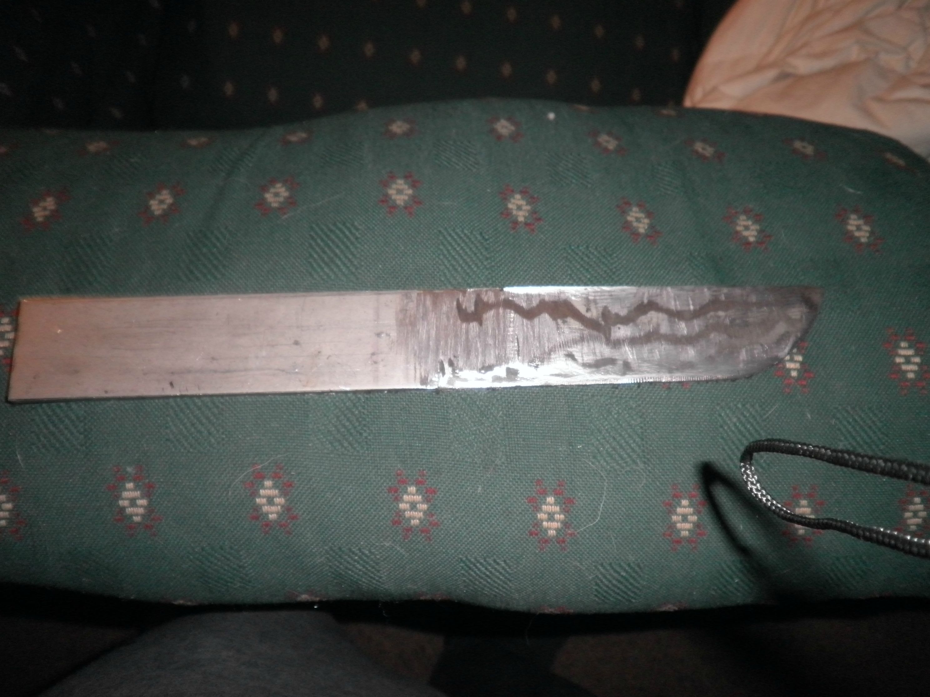

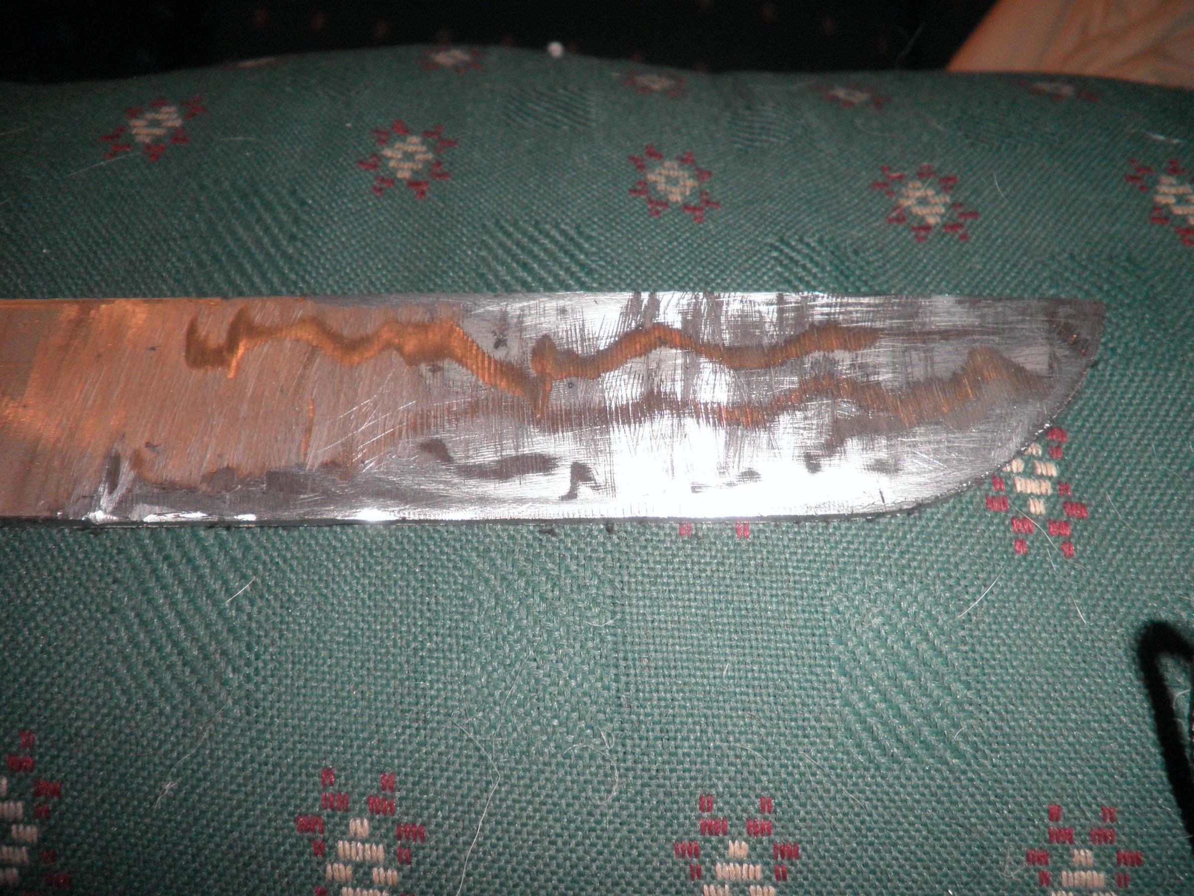

Got so much respect for you guys now omg its so painfully slow filing. espcially because I suck at it lol.
[/IMG]
I have to ask :D ( colon,D)
Are you clamping/bolting that to a work board as described in the instructions you read?
Are you clamping something across the blank to define the plunge line?
Are you filing in full strokes and then lifting the file on the return ?......or sawing the file back and forth ( Don't do that!).
It might be a good idea to knock the sharp corners off the butt to keep from scratching yourself.
What file are you using? (You should be using a bastard cut mill file)
Final comment - Don't try and make a knife in your bedroom :( ( colon,open paren)
