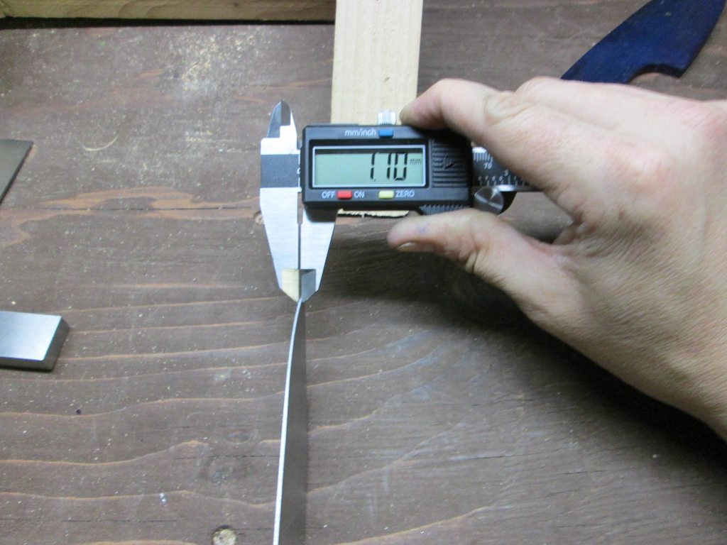

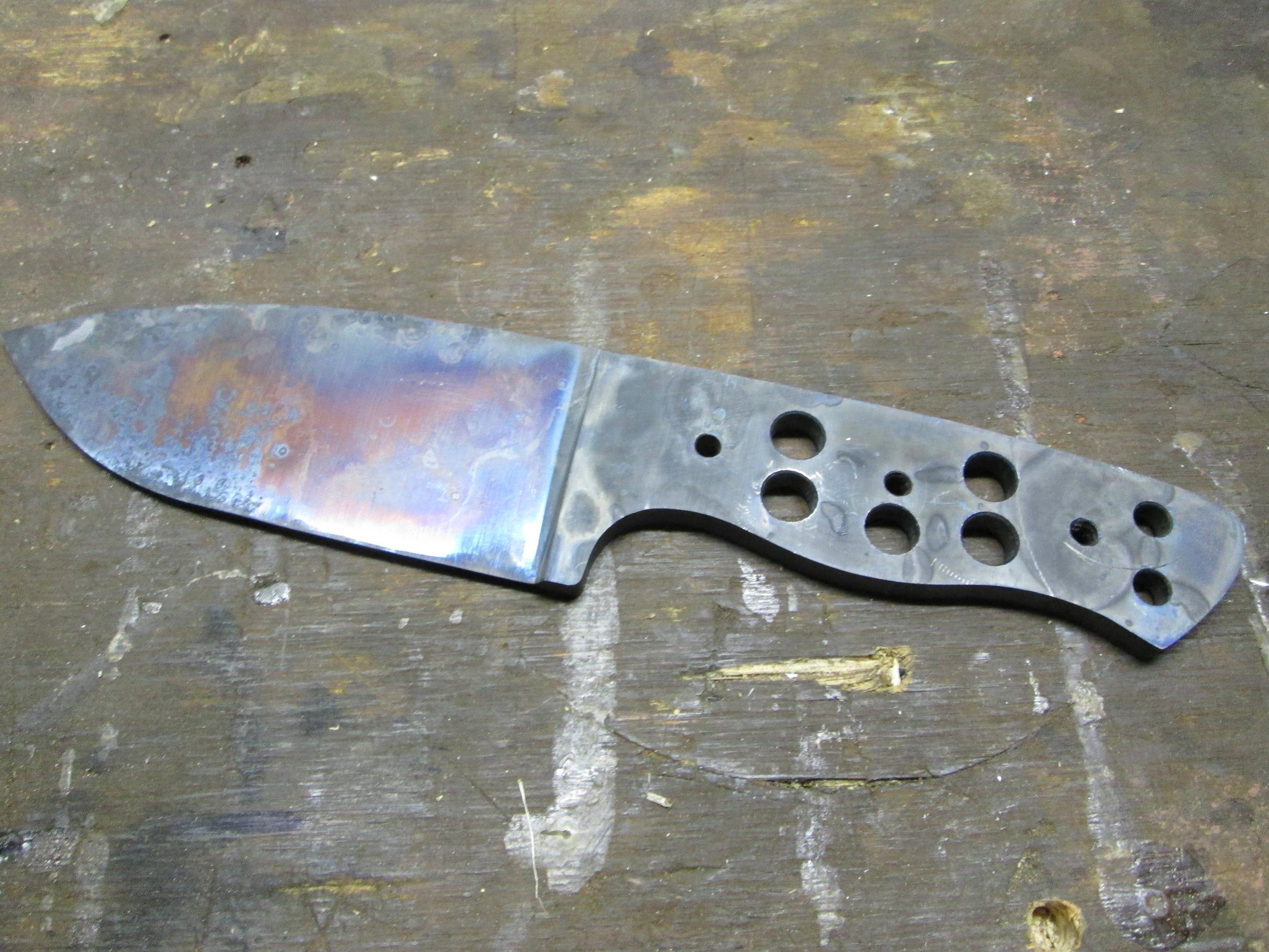

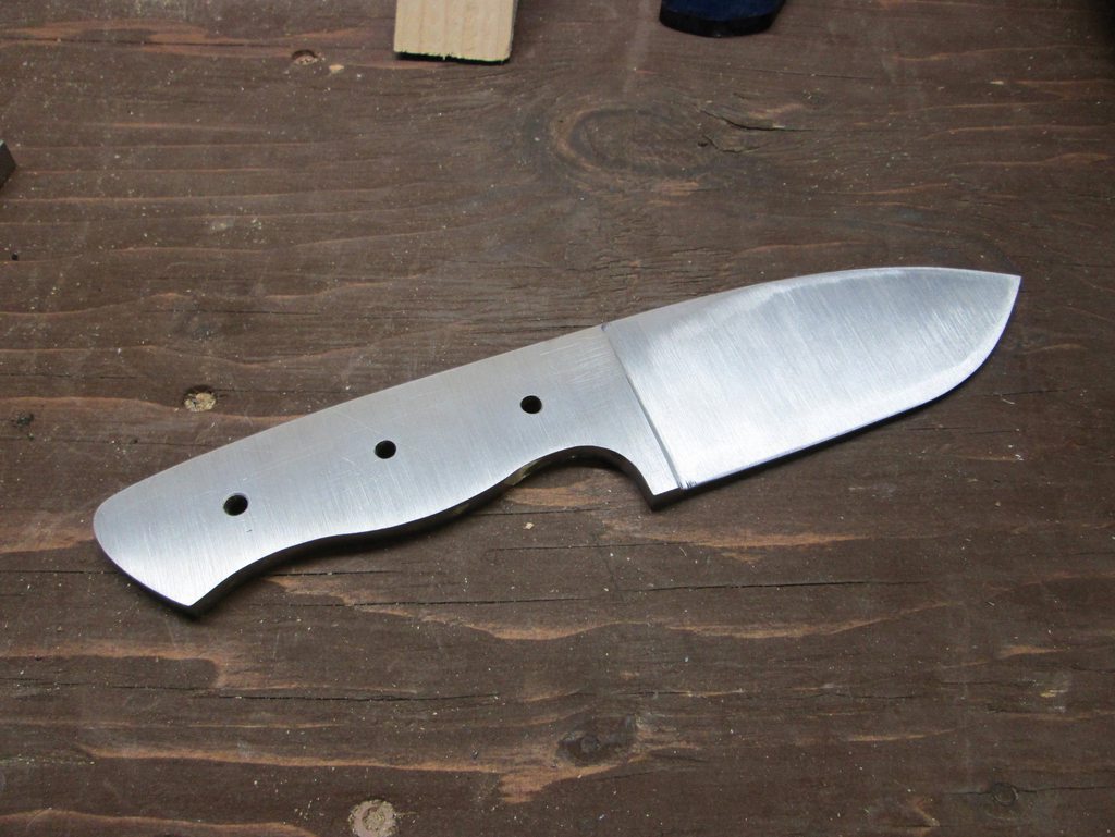

First knife and I would love some advice and tips so I can improve for the next one.
Steel is 1084, 1/4" thick, and finished to 220 grit.
I kind of messed up my Ricasso.
The edge thickness consistence stayed pretty good I think.
Now I just need to get the thing heat treated... Any takers? ;)
I know 1084 is an easy heat treat but I don't want to mess up my first knife you know.
Thanks

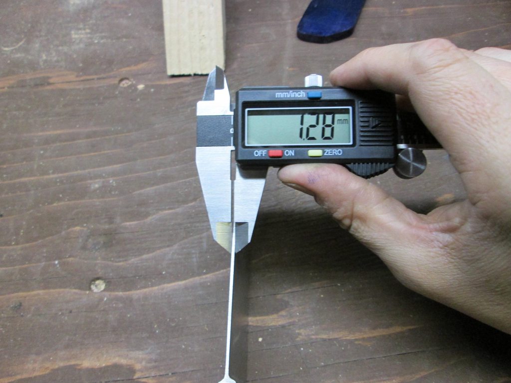

Personally, I'd thin out that edge just a little more before h.t., .050" is a little thick.
Wow, that things a tank!
Looks very good for a first, that's for sure.

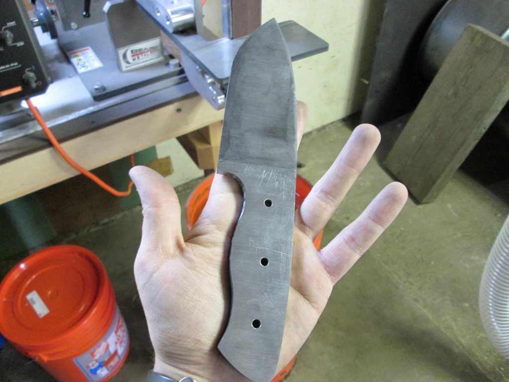

Thanks, I thought that 1.00 was that goal but I can easily take it some some more, I thought that there was risk of it warp in heat treat if it was that thin.
Yeah, .040" is the standard for that steel.
I just like to take it down a little closer is all. Just personal preference.
The only time I've had a problem with the edge warping was when I took a knife made of 52100 down to about .020".
You'll have some grinding to do after h.t. anyway, to remove de-carb, so leaving it thick is alright, if that's what you want to do.
Somewhere between .75mm and 1mm is about right.

Just a recommendation from just completing my first few knives, but try to get out all of the deep scratches and grooves prior to HT. They will be a lot harder to remove post HT.

I agree with leifjl. Take it down alittle more. It will save you lots of time in the end. Please post a pic of the finished product. Great workmanship. Here is my first one I ever created.

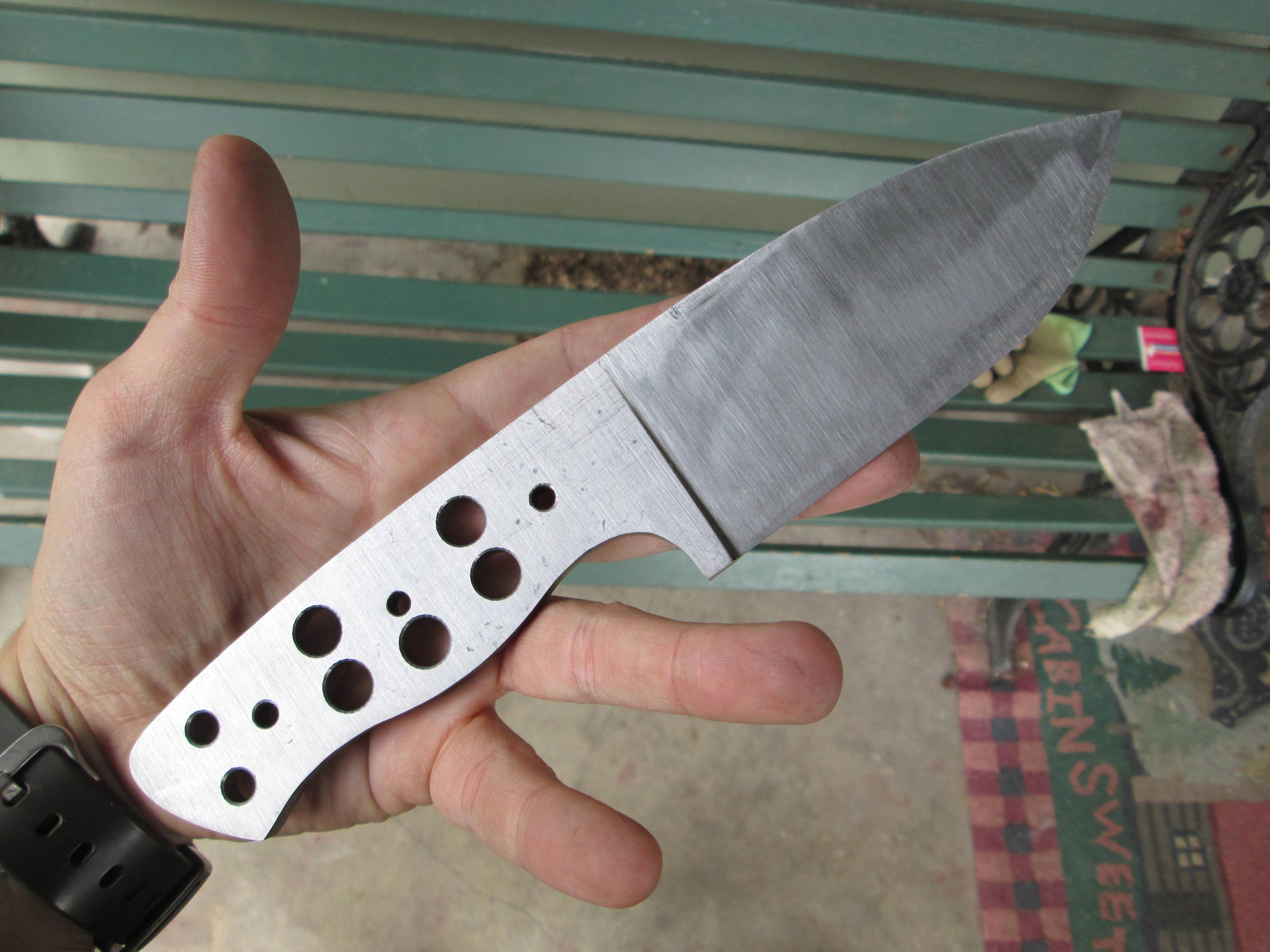

.8's perfect, imo. Lightening up that handle was a good call too.
As Sgtjohn said, Its going to be exponentially harder to finish after h.t., so try to get as much of that out of the way as possible.

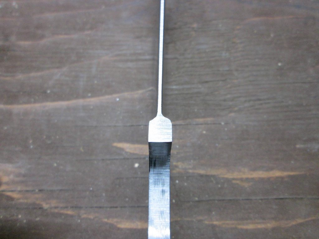

You have a sharp angle where the vinger coil ends and the ricasso starts.
Personaly I´d round that edge
Thanks I am going to work on getting some of those out today.
Now that you bring that up it sounds like a good idea to me as well, I think ill do just that.
Cool. Thinning that edge after heat treat would be a pain and you would increase the risk of burning out the hardness. I sent you a PM about the heat treat.
