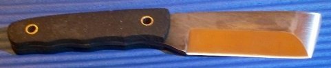

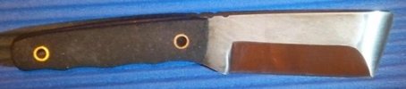

I finished this one up today. It is not the first one I have ground, but it is my first finished heat treated knife!
It is 1/8" thick, just under 7" long. The handle material is horse stall mat and the tubes are stainless. It is hard to tell from the photos but the knife has a black ferric chloride patina with polished bevels. Chisel grind.
Any criticism or comments are appreciated.

Daniel,
Congrats on number 1, are you going to keep the knife?
Did you do the heat treating? just curious?:)
And what made you pick the handle material? As nothing wrong with it, just wondering why you used it?:)
Look froward to seeing many more..... :D:thumbup:
TA
Daniel,
Congrats on number 1, are you going to keep the knife? Yes, got to keep #1.Did you do the heat treating? just curious?:) Sure did, I used a digitally controlled kiln and quenched in heated canola oil.
And what made you pick the handle material? As nothing wrong with it, just wondering why you used it?:) I have always wanted to use it, it is really grippy and feels great in the hand. I plan on using mostly G10 in the future but the stall mat seems like great stuff.
Look froward to seeing many more..... :D:thumbup: Thanks!

Nice Job. you went with a fairly difficult Grind In my opinion... Seems you ARE a knifemaker!
I have never heard of Horse stall mat being used as handle material, how does it compare to Neoprene?
Thanks! :D
Here's some links about the stall mat, I heard it was first used in cutting competitions because of its grippy feel.
http://www.bladeforums.com/forums/showthread.php?t=741746&highlight=horse+stall+mat
http://www.bladeforums.com/forums/showthread.php?t=670436&highlight=horse+stall+mat
http://www.bladeforums.com/forums/showthread.php?t=618513&highlight=horse+stall+mat
It doesn't stain your hands at all, smells kind of good in a car tire kind of way :D , cleans belts as it grinds, and has a great feel.
I have g10 but the feel of this stuff is great, I had to try it first. I have never worked with neoprene but as far as feel goes this is much stiffer than the neoprene I have felt, it has more grip to it as well.
Looks good to me! I'm a huge fan of the chisel grind and I'd have to say that Jon Graham would probably approve too.

Thanks! I just looked up Jon Graham, his Razel model looks a lot like this! :D It goes to show how hard it is to make something truly original. Thank you Taylor for mentioning Jon Graham, I'm now a fan.
