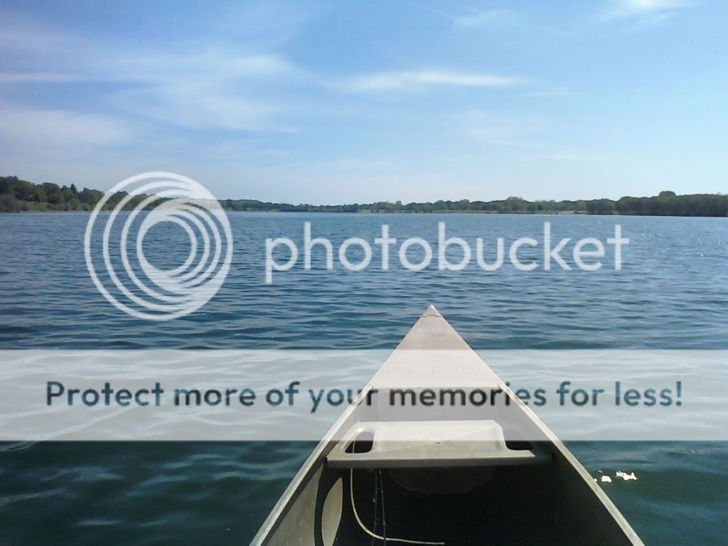

I bought this canoe from a friend of mine this past winter. This is the first time I've had it out. I added the bass boat seat to it.
Wanted to see how she'd do, not sure adding the seat, center of balance and all. But it did great, did some fishing by myself, seen a lot of big fish under the water but did not catch any. My wife and daughter came up later and we all went out to see how the canoe would handle with all of us, a little more unstable but fine. Then my wife left and me and my daughter went around the lake (185 acers). What a great day, my daughters first time in a canoe. She loved it so much I didn't think we were ever going to get back to shore.
I had never fished from a canoe...why did I wait so long...It was so fun and peaceful.

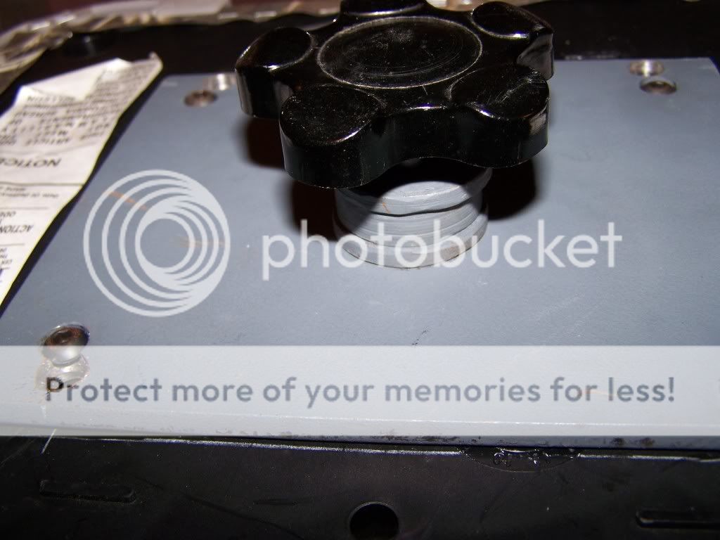

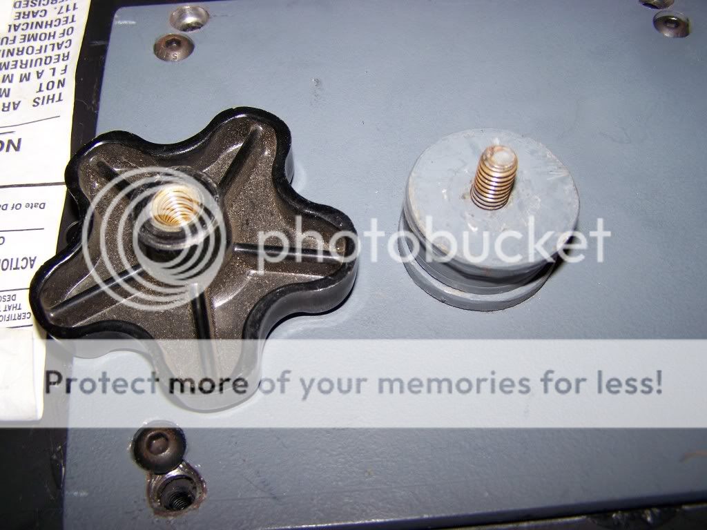

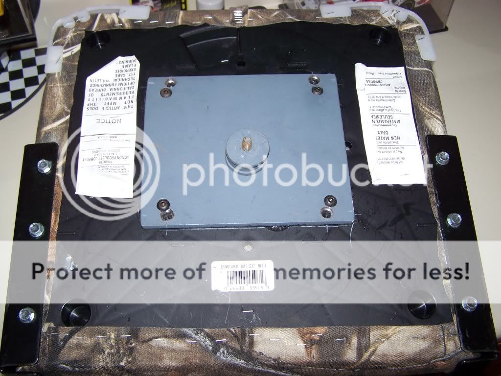

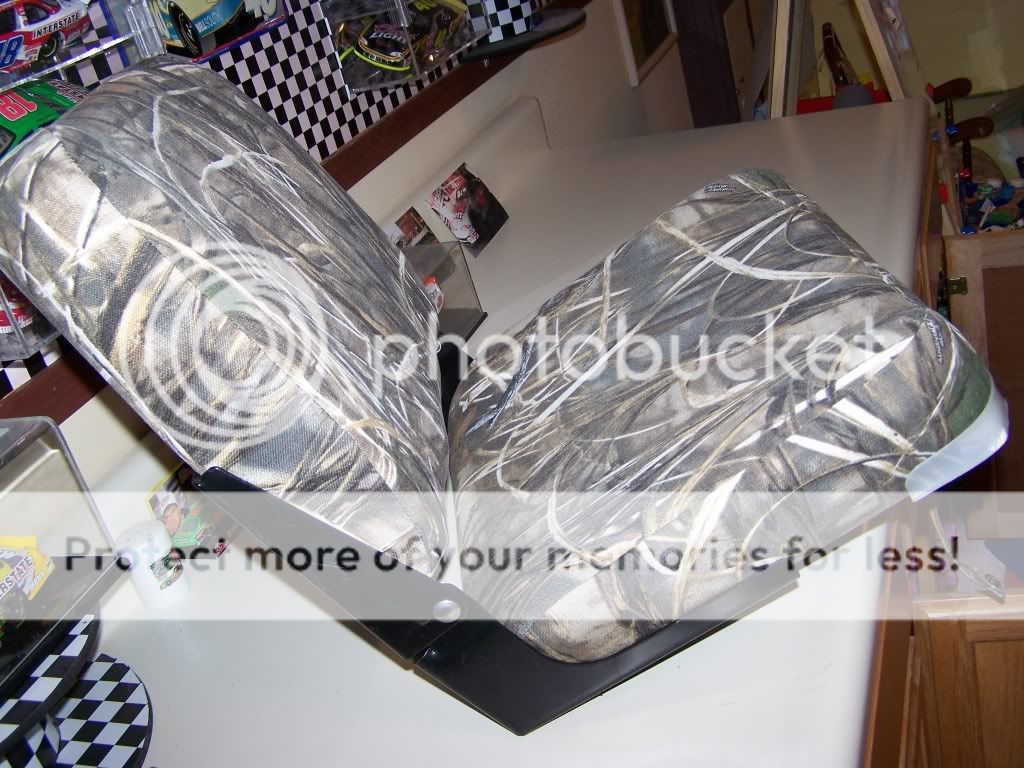

I got the seat at Gander Mountain during the winter, I think I paid 35.00 It was on sale promotional thing.
I took a piece of 1/4 x 6 x 6 strap drilled and tapped the center, then threaded a 5/16 bolt ground off the head, welded the bolt then ground almost flat again. drilled four through holes to line up with the seat mounts, then realized i drilled the wrong four holes thus the extra set of holes. (check twice drill once ):D. I used 1/4x20 button head screws, slightly recessed to hold the plate. I used hole saw blanks as spacers, depending wether I have the seat mounted in the front (just me) or rear (with the family). On my aluminum canoe the bench seats have a hole for drainage, I put the bolt through that hole and then use the hand knob (that I had lying around) to secure it to the boat.. It works great, very firm, no movement, extremely comfy.
