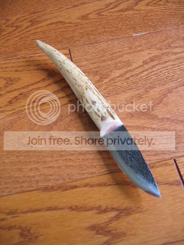

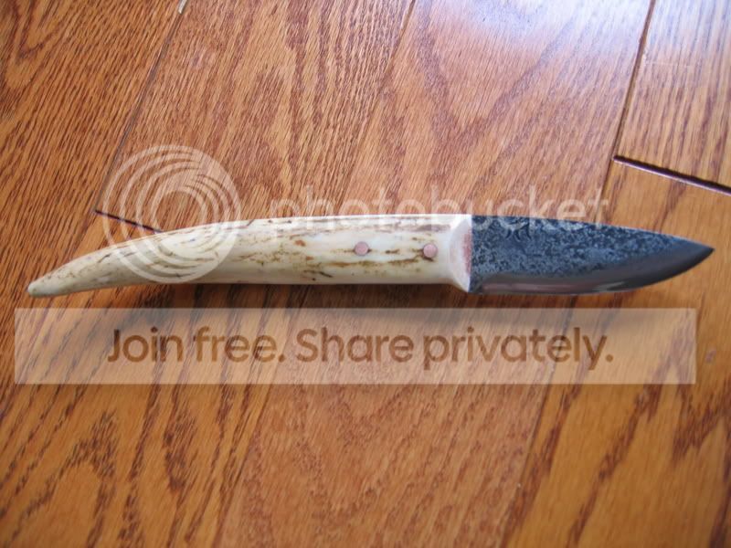

Here's my first shot at a patch knife. I've always loved the look of an antler handle....
Rick

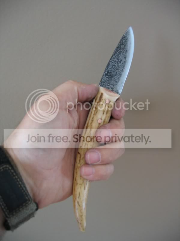

looks good, i like the long handle and the copper pins are a nice touch.
i don't need a long blade, but the handles that come with short blades are always too small...this solves the problem nicely.

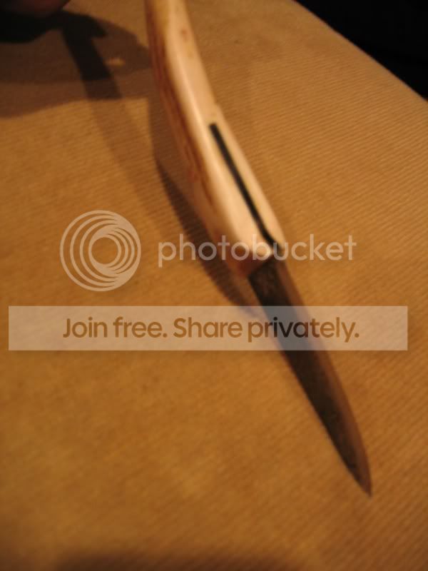

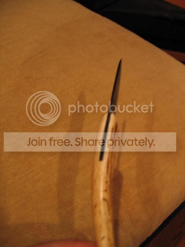

how did you fix the blade in the antler besides the pins, if at all? did you boil and shove the tang into the antler, or drill it out etc?
also curious about the thicknes...a spine photo would be good if you don't mind...
Excellent work, you are getting pretty good Bro.

Thanks for the compliments, Guys...
Si...
I cut a slot in the antler and filed it to a proper fit... Then I loaded it with epoxy and pinned it in. There are almost no gaps in the fit... It turned out better than expected, for sure. The spine is roughly 3/32" thick.
Sorry for the fuzzy pics... no natural light at 11:30pm... lol
Most of my patches are 1/16 or 3/32. I love the way the handle fits, and the shape of the antler.
Nice!
that came out great man...:thumbup: i've always liked antler tine knives.. they always seem to conform to the hand just perfectly...
That's a great looking handle. Nothing beats micarta/g-10 for me, but recently I'm starting to appreciate the looks of natural handles a lot more.
