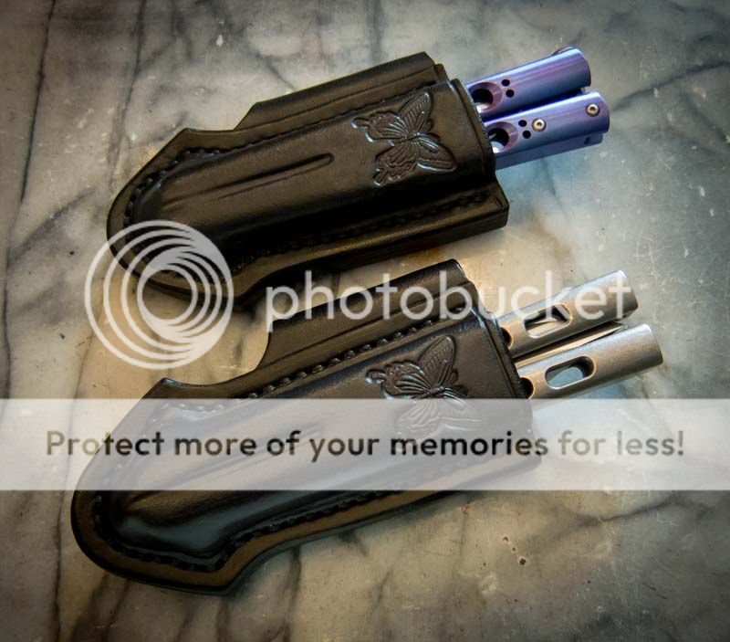

Actually two or really three, as I was doing three bali sheaths at the same time, all three were finished up about the same time, need to photograph the other one, as it has a neat skull and cross bones on it, but here are two of the sheath for the start of this year, might be a big year for Bali sheaths I'm thinking.
One is for a nice blue anodized BM4x series knife and the other is for a Mike Snody latchless bowie, which has a chiseledged grind, if I had a Mike Snody $ embossing that would have been even neater but, I didn't and the fellow wanted the butterfly which is a nice embossing too.
(pardon the pic as I was against the clock to get these in the mail this morning)

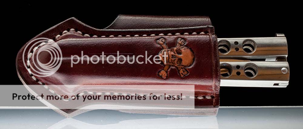

And here's a shot of the third one, was able to get a better shot of this since it didn't leave today
R_Sheath.jpg~original

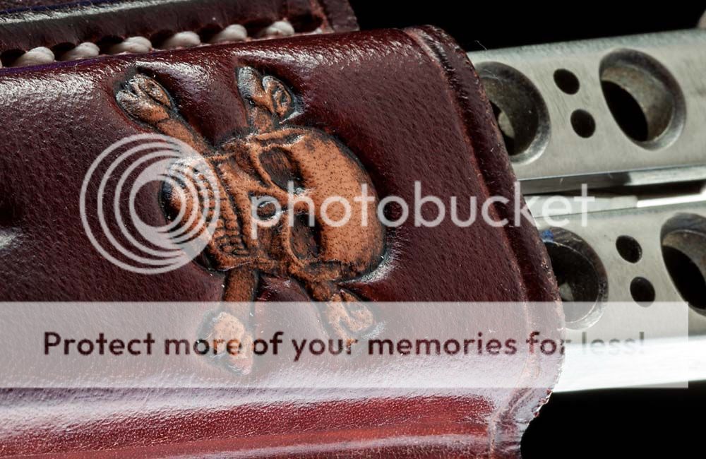

He wanted the Skull and Crossbones, and wanted a contrasting embossing from the burgundy sheath, so it's lighter than the sheath, basically the leather colour, but I used Fiebings Highlighter, you apply that to the embossing once it's dry, carefully dab off the excess and it leaves darkness in the impression from the embossing, this was embossed nice and deep using my C-clamp method for the embossing which helps provide a crisp emboss image as well as helps to lessen any bounce or double strike from the usual maul method.

Nice work G2, really love your Skull and Crossbones, tried that stamp a few times, but we don't get good resist products down here in SA.
Gary your work is simply insipring. If I'd tried that I'm sure I'd of had a mahogany streak right down the center of the skull! Your close up pics are really cool too.
You guys are too kind, really appreciate it, photography is one if my major passions too.
As to the skull & crossbones, I don't use any resist on that, I've heard that some people use that but I've never had any. On this I just carefully use a very small artist paint brush to 'paint' the dye around the embossing, once the dye has dried, that's important because when you apply the Hi Liter you have to dab it off and using a damp paper towel you could mess up the surrounding dye'd area.
Fiebings Hi Liter is the stuff I use to bring out the detail in the embossing.
