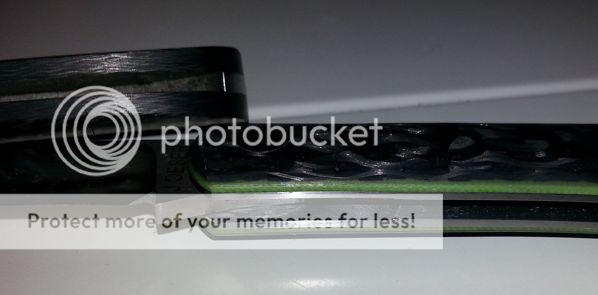

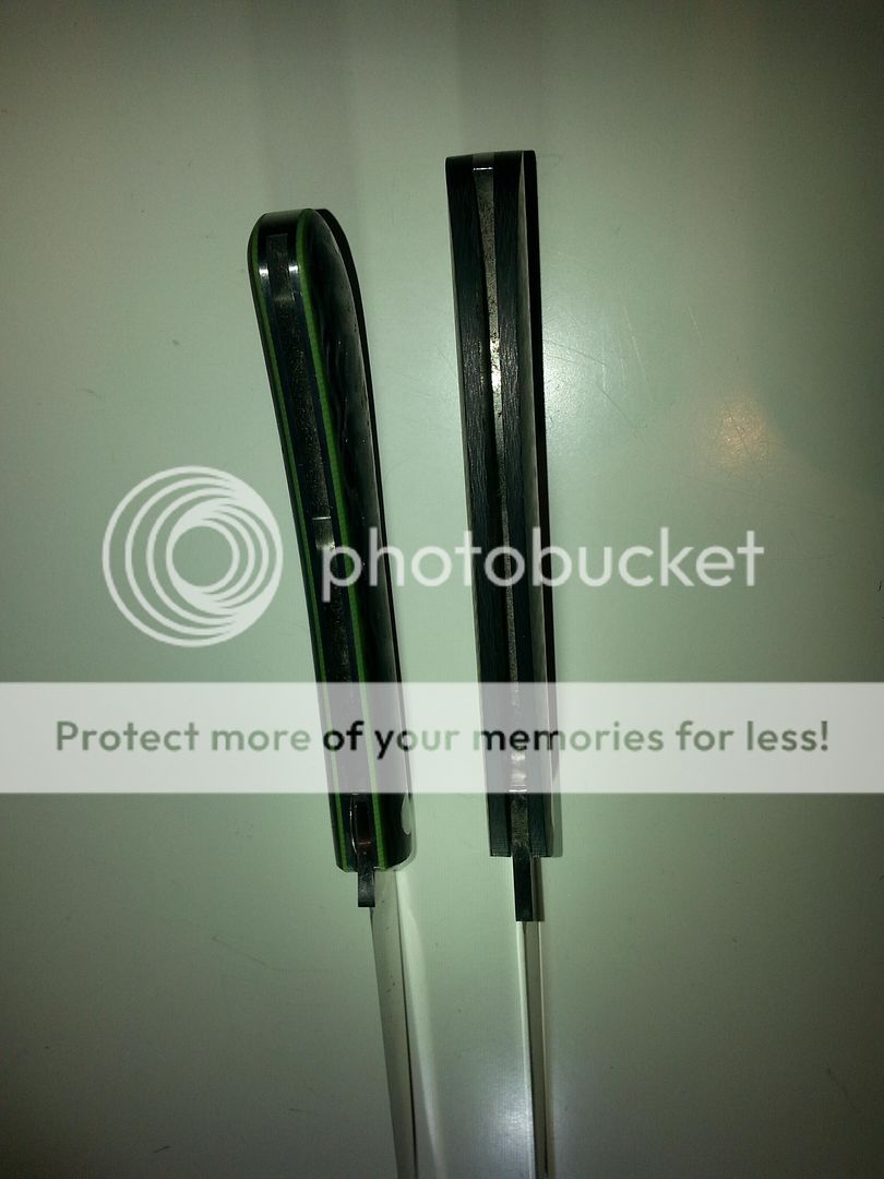

I have a John Lloyd linerless carbon fiber wharncliffe - super light but still strong! Shown with a similarly sized Oeser with liners - definitely a weight and rigidity difference for a similarly sized knife Photos added
