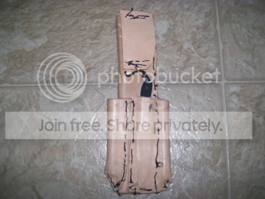

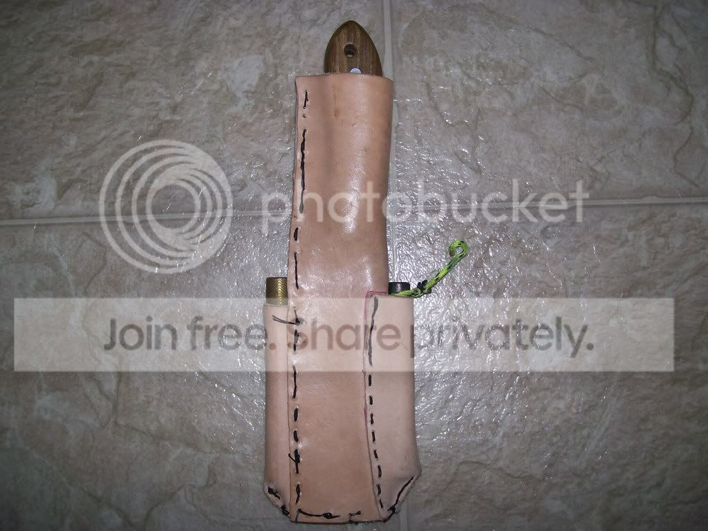

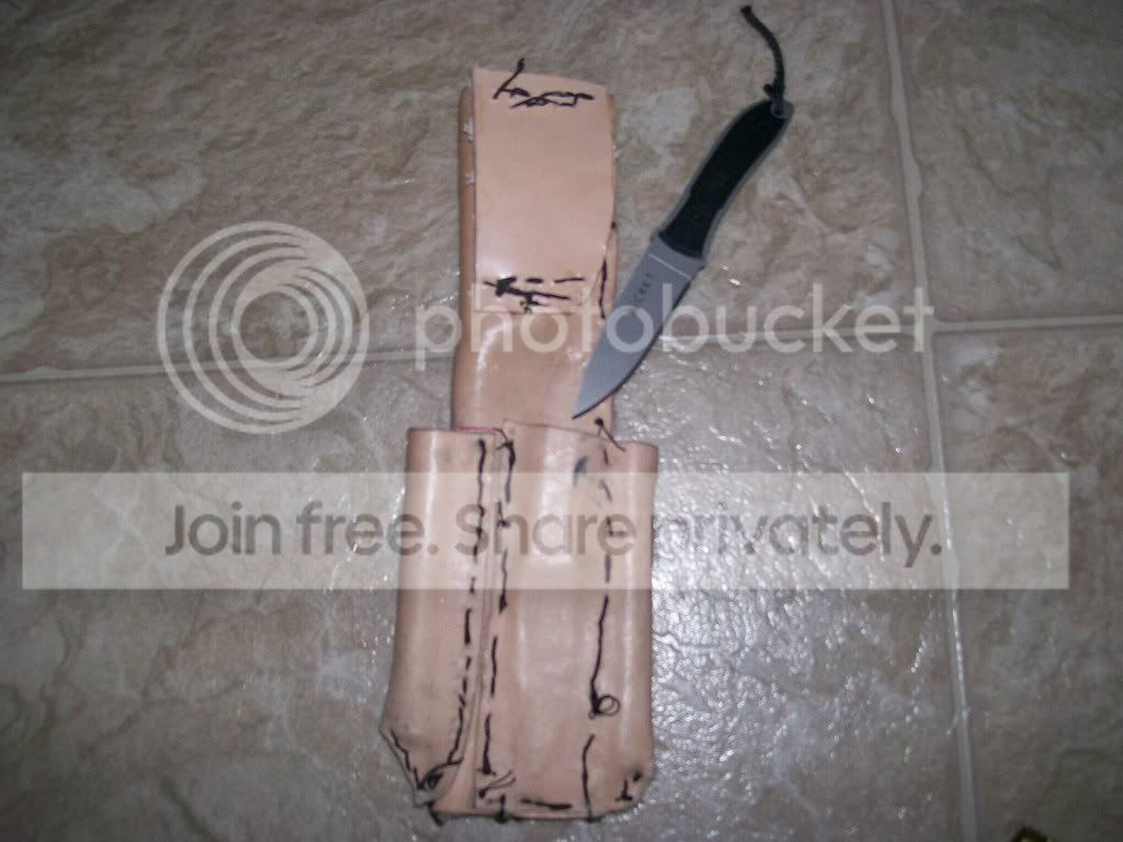

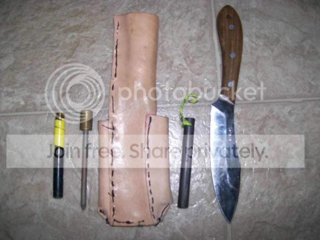

Hi Falch Welcome to the forums. I just made a sheath not two weeks ago for my Grohmann # 4 survival it is a deep pouch style with a few addtions to it for some suvival goodies. It is rough. But It is my second one. Here is a few pics front and back and the suvival goodies.
I really do not have much advise but to try making it and if it does not work the way you want it to try again. I used a drill for making the holes and fishing line for the stiching.

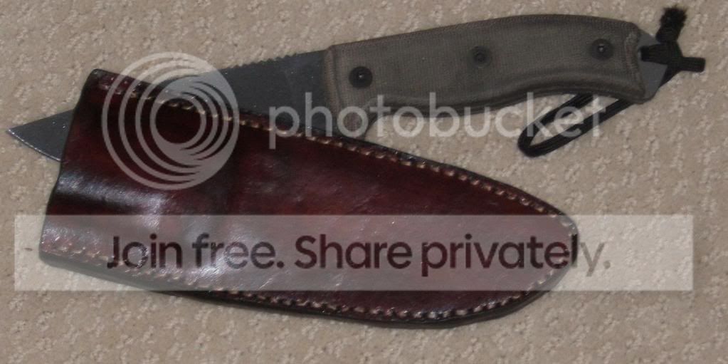

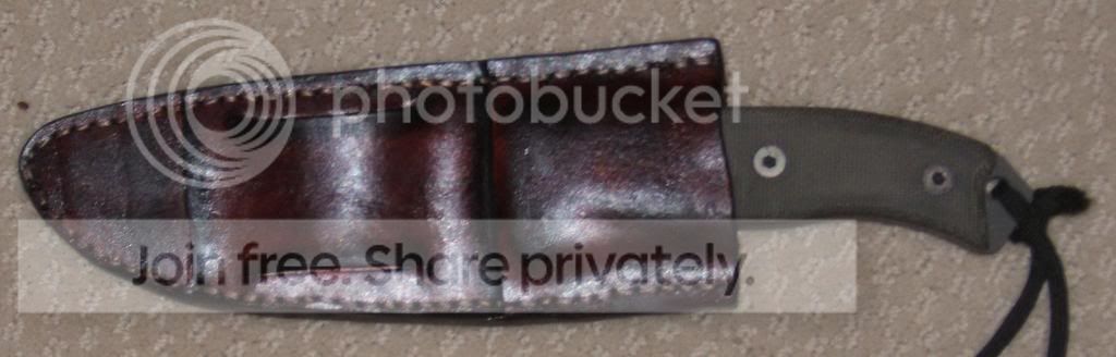

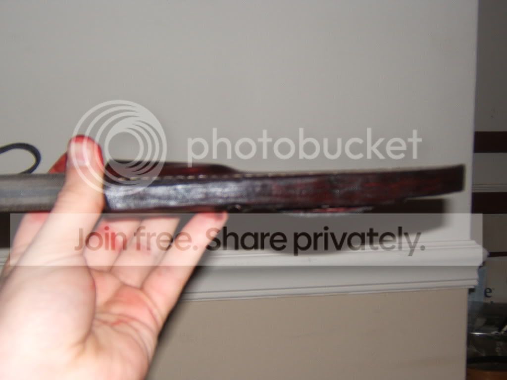

here is my first complete for my rat-5. i did as much research as i could online first. luckily i went to tandy leather and the manager was a big help just telling me the basics of leather working. i made a test sheath that i never completed just to see what would happen, drilling holes, staining, size fit, etc. i found out read fast that the dremel is a great tool to have. good for sanding edges (inside and out) and drilling holes (real small bit). anyway here she is. ladies and gents: large marge.
dont worry, just leather dye.
