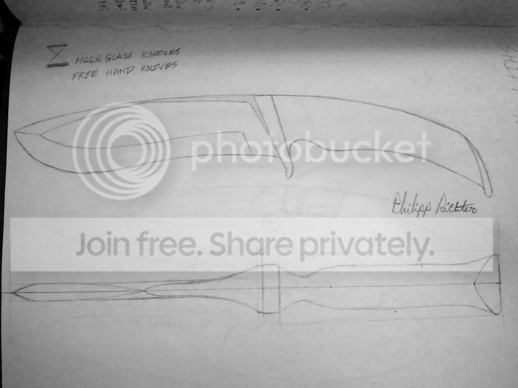

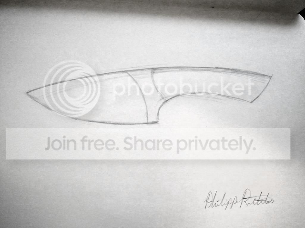

Here are my preliminary sketches
Knife 1
Knife 2
These knives are being constructed through stock removal (hacksaw and file) out of 5160 from Jantz knife supply. Once I've gotten comfortable with this steel I might try some 52100 for the next set, but I'm going to use up the bar I have.

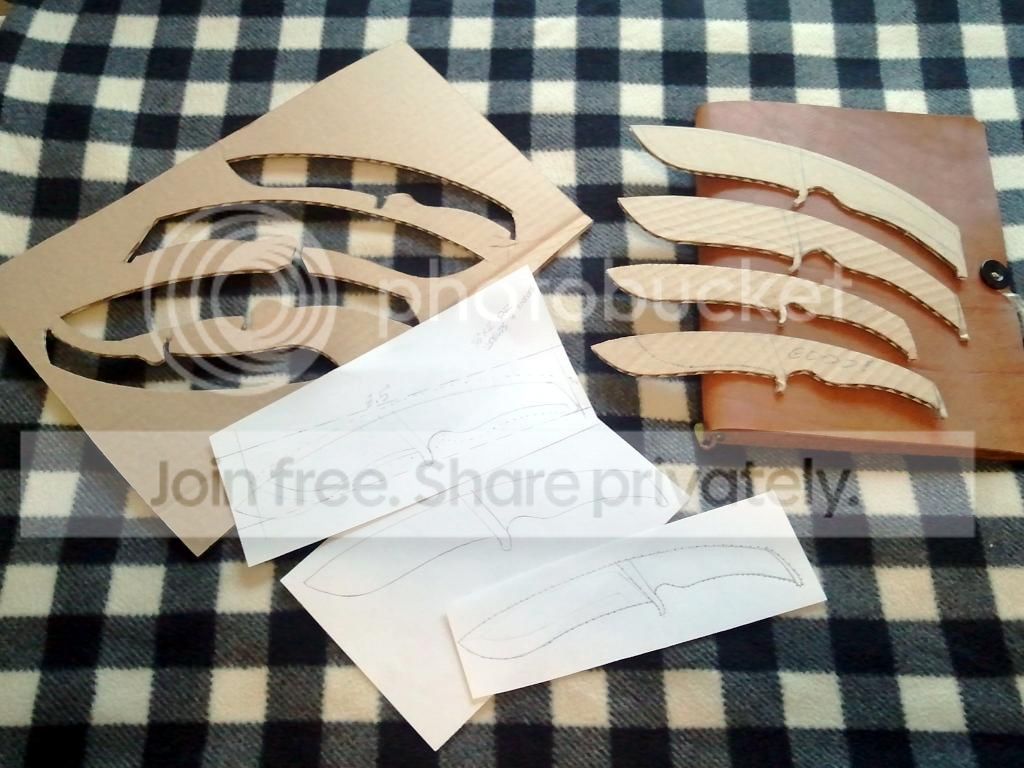

Here are my knives going from sketch to cardboard to metal blank:
Knife 1
Knife 2

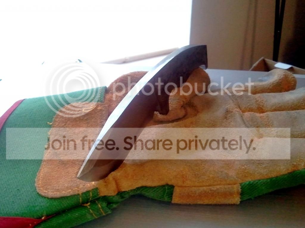

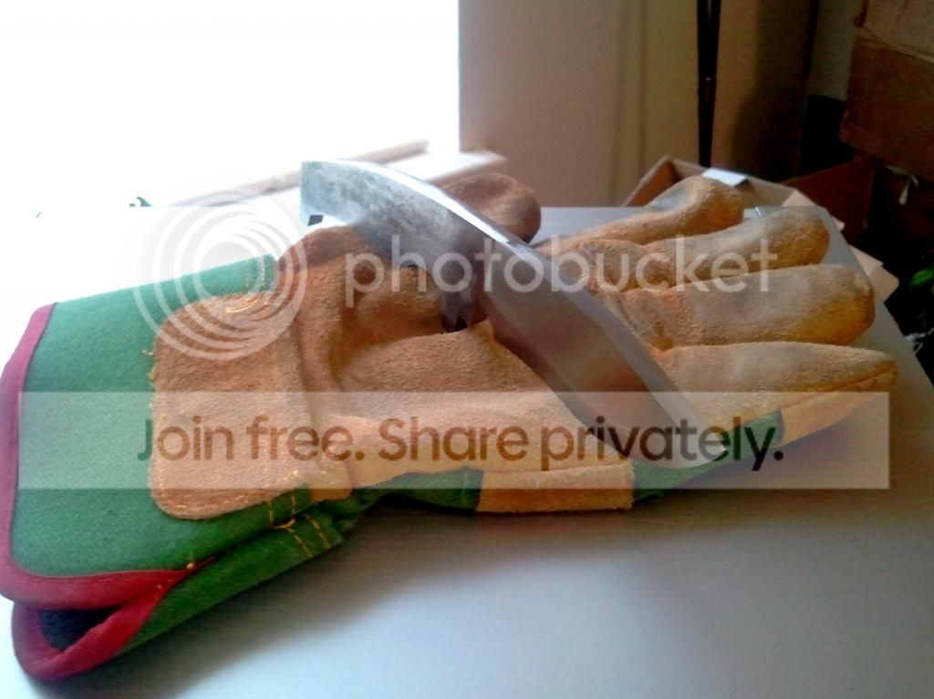

Some more pics of Knife 1
At this point I've cut the bevels and cleaned up the outline.
I didn't have a good scribing tool handy, so I used my dremel to cut a shallow (and ugly) line over my sharpie guide lines. I need to get some dykem layout fluid for my next round because the sharpie marks tend to rub off after a while. Maybe I'll get a refillable felt tip marker and fill it with dykem.

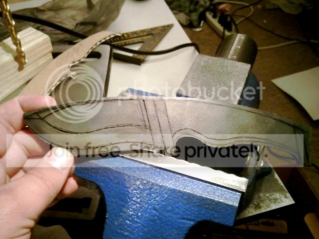

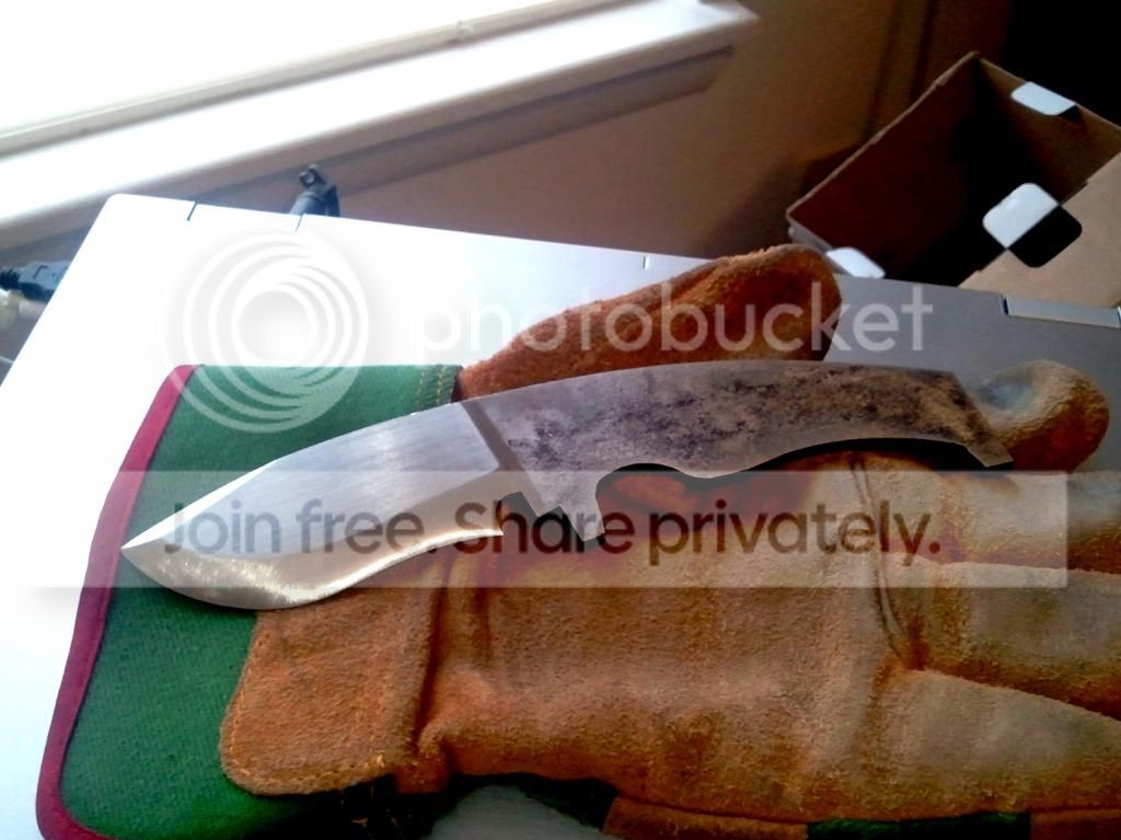

Pics from knife 2

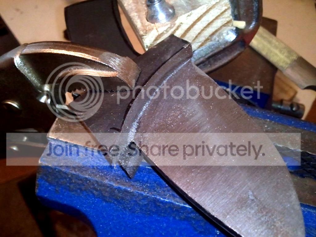

You can see the scribe lines from a drill bit (tip from bladsmth on another thread). I also attempted to curve the plunge lines using a piece of scrap as a file guide. Using a half-round file (modified with safe edges) I tried nibbling at the plunge. Sadly, the tiny amount of file surface area the I could wrangle in there was small and though it worked I wasn't getting anywhere fast. So, knife 2 will have straight plunges now. I will try to bring the curved plunges back later down the road when I have the right tools.
I think I will also remove any mill scale before cutting bevels in the future. That dark top layer seems pretty hard because my file would skate for a few strokes before biting in- probably no good for file longevity.

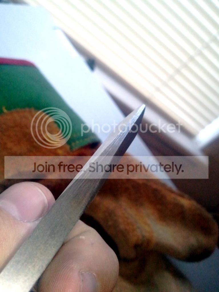

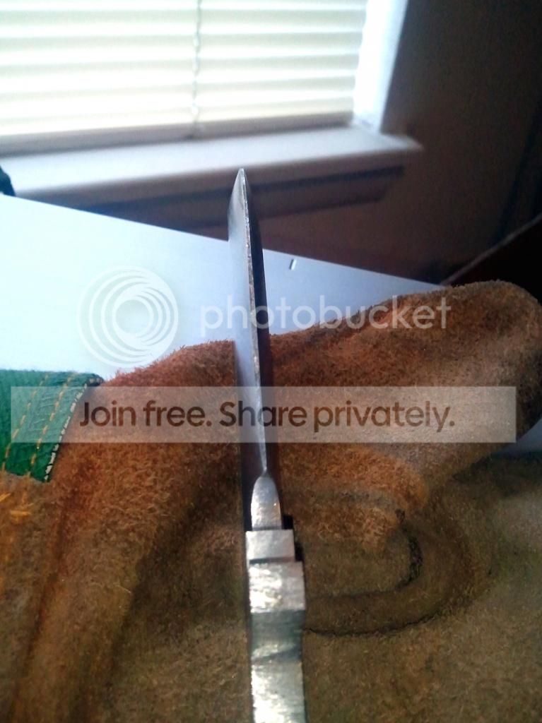

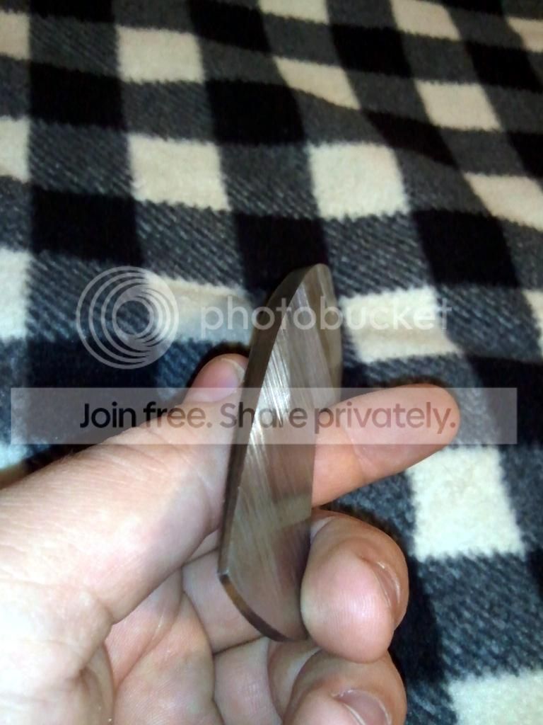

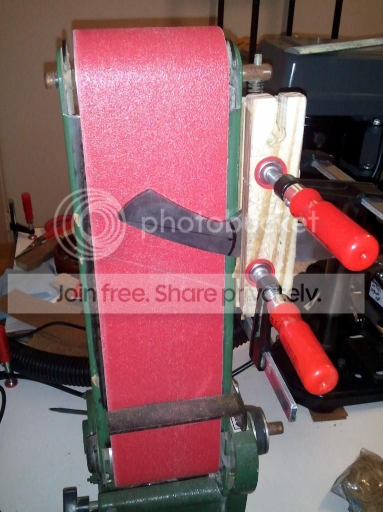

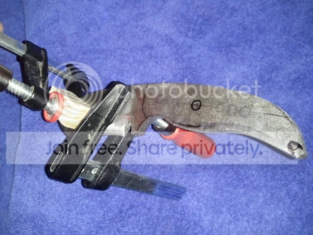

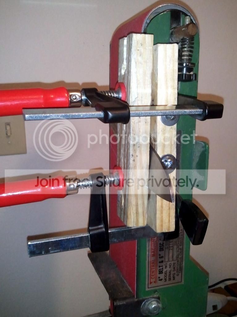

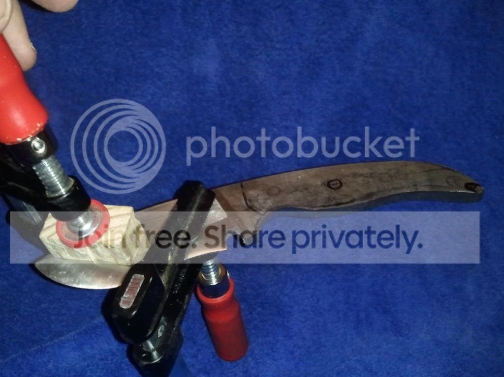

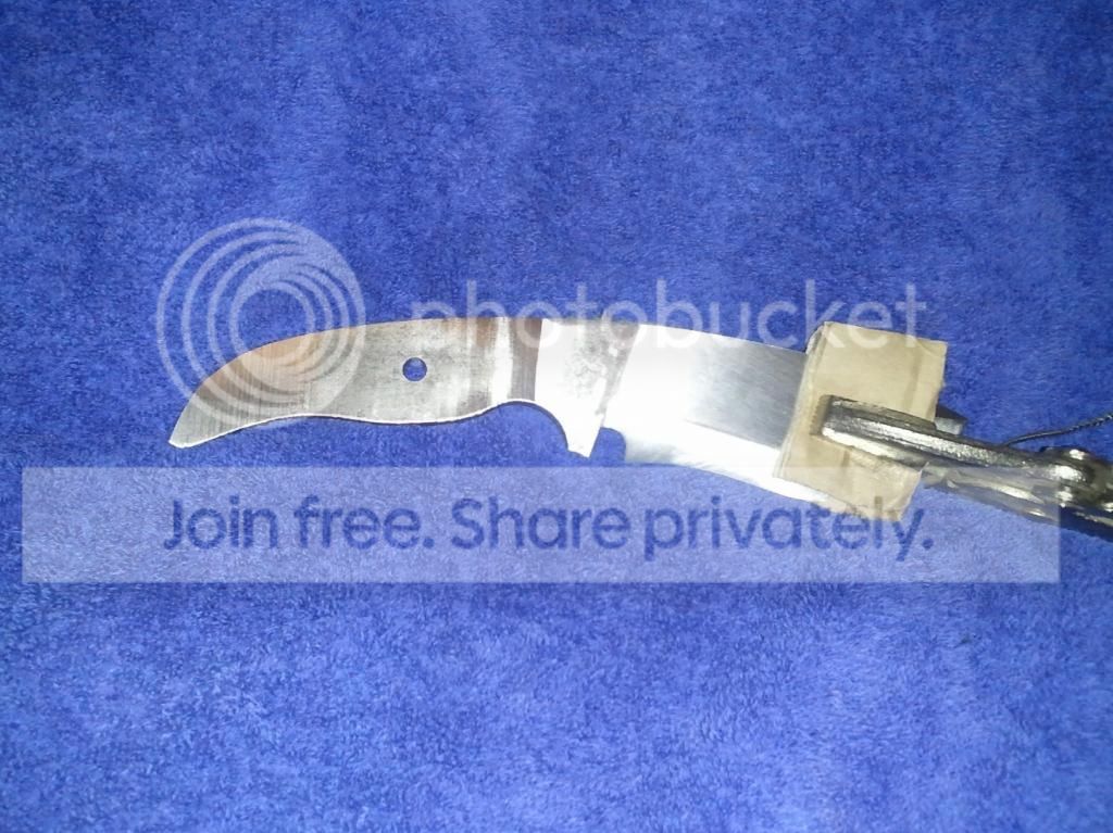

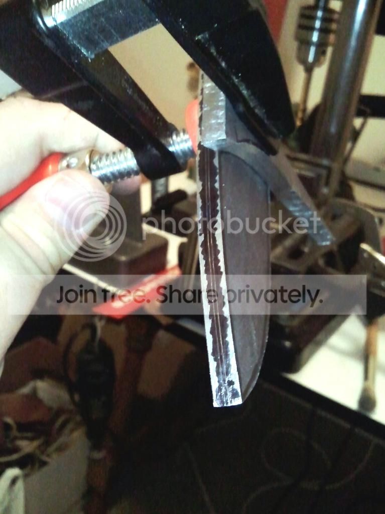

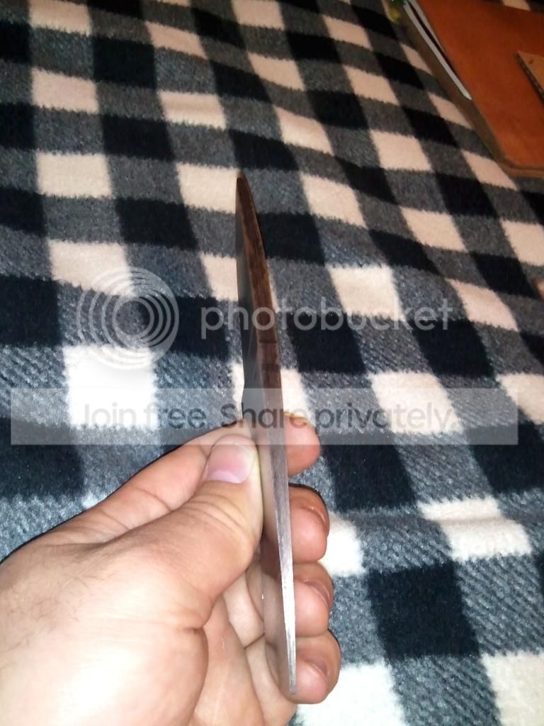

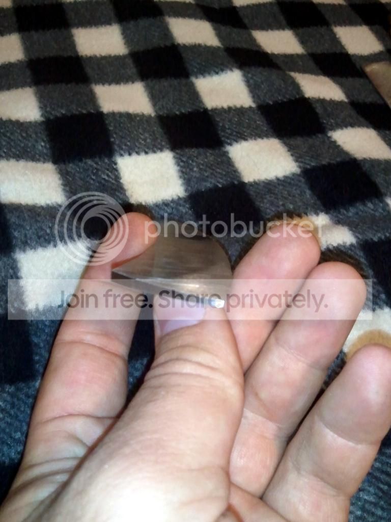

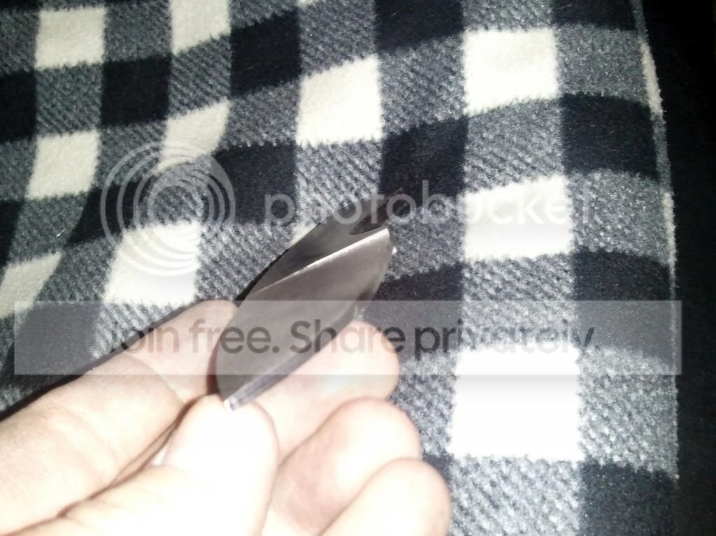

I added the tang taper on knife 2 last night and I think it looks pretty good!

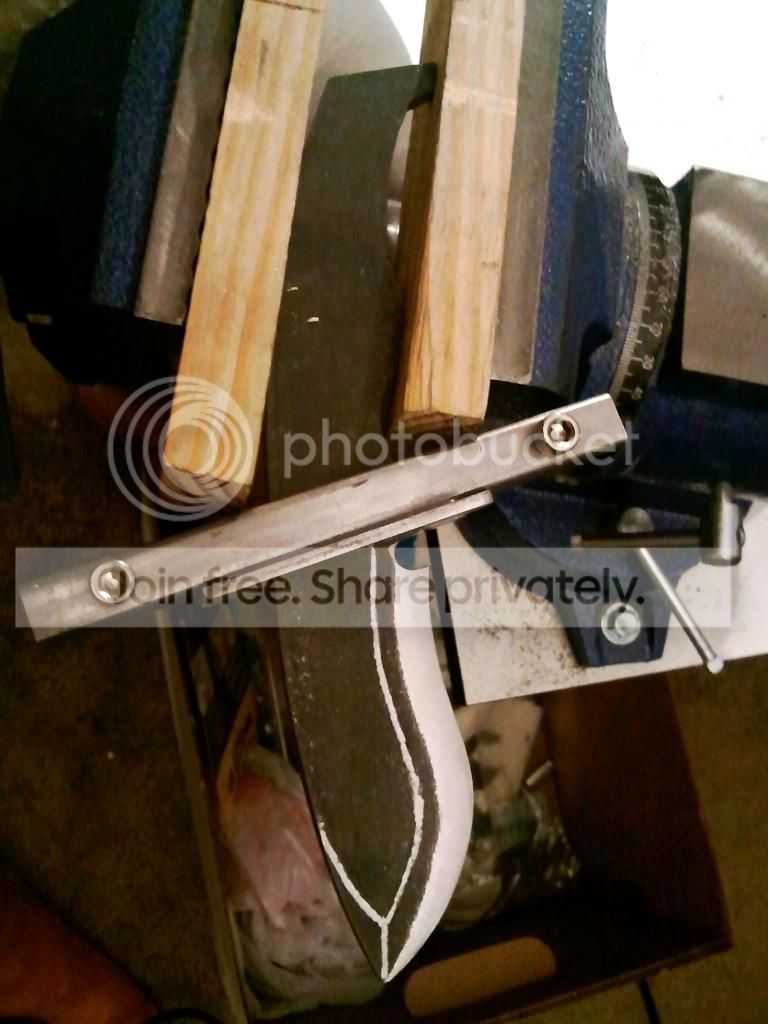

I started out with a silly wood clamping jig that I bolted to my belt sander. I would clamp in the knife and then apply pressure on the tang. I was using the flat ricasso as the fulcrum point, but the results were uneven. So, I converted the clamping jig to a shelf extension and clamped the knife blade in visegrips for leverage, still using the ricasso as my fulcrum point. That fixed her right up!
There's also a bit of a compound taper leading from the tip of the butt that I really like- it adds to the asymmetrical aesthetic, I think.

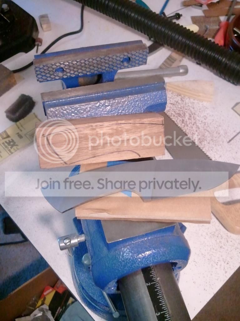

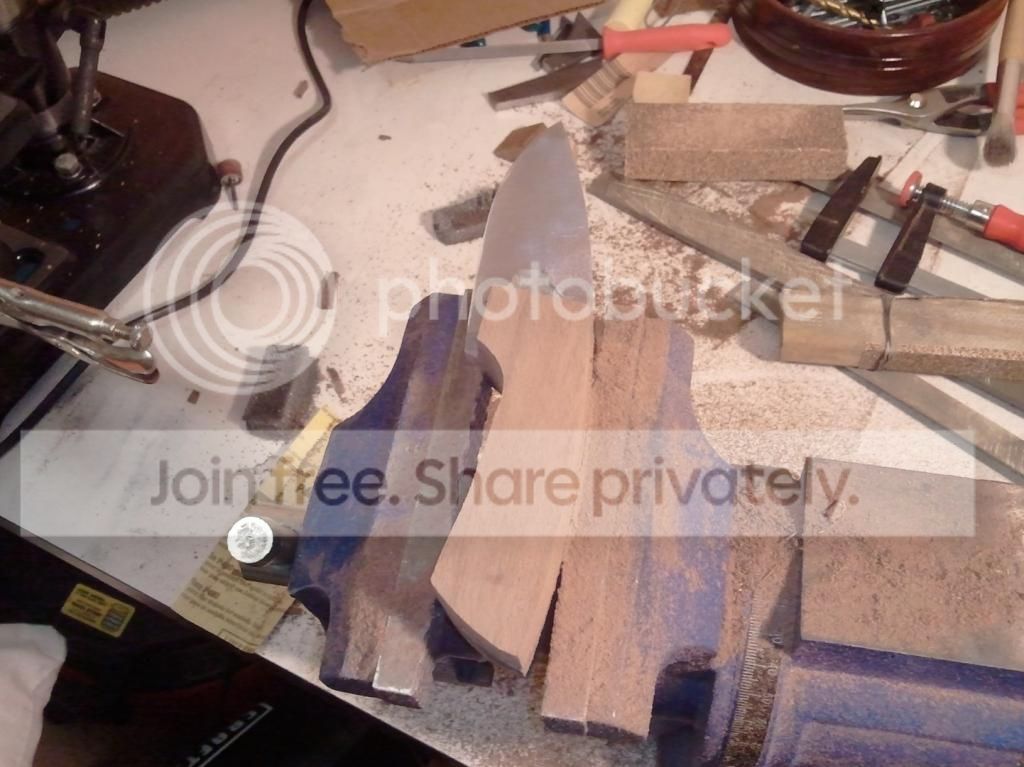

Blade and tang tapers for #2 are finished now. Blade is at 400 grit finish. Now to shape a handle and drill pin holes.
I don't have the money on hand for a really nice handle, but I do have some black walnut, so I'll figure out the shape I want in that and change later if I score some nice material. If I get some really nice handle material, I'll probable add some shiny bolsters, as well.

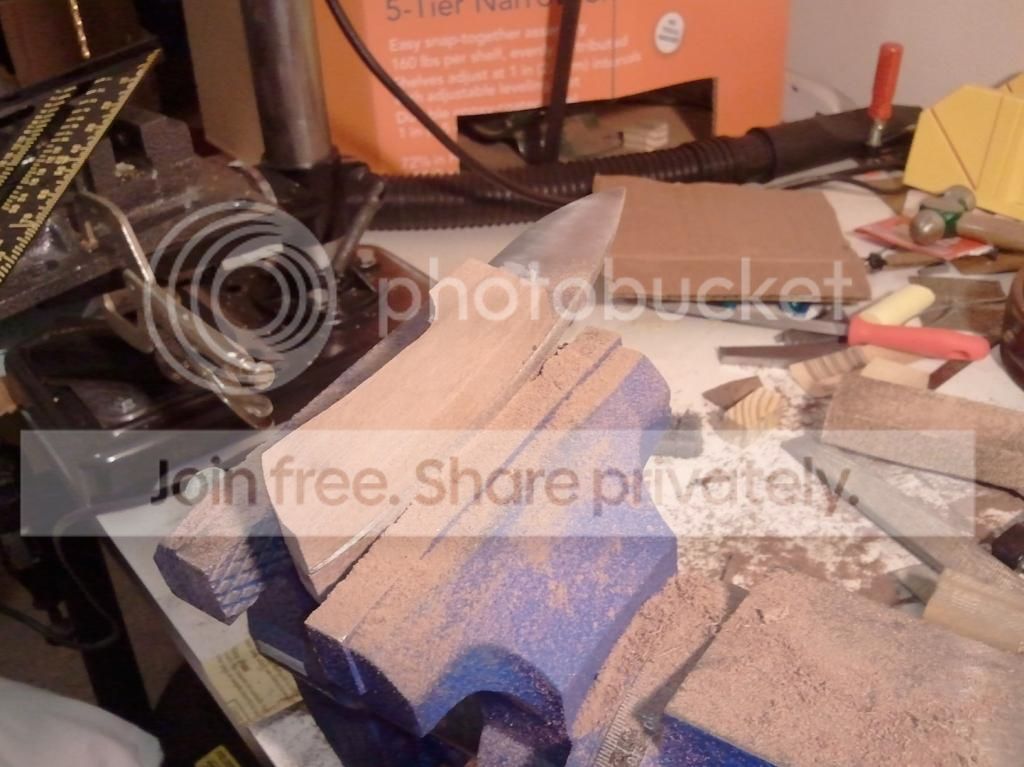

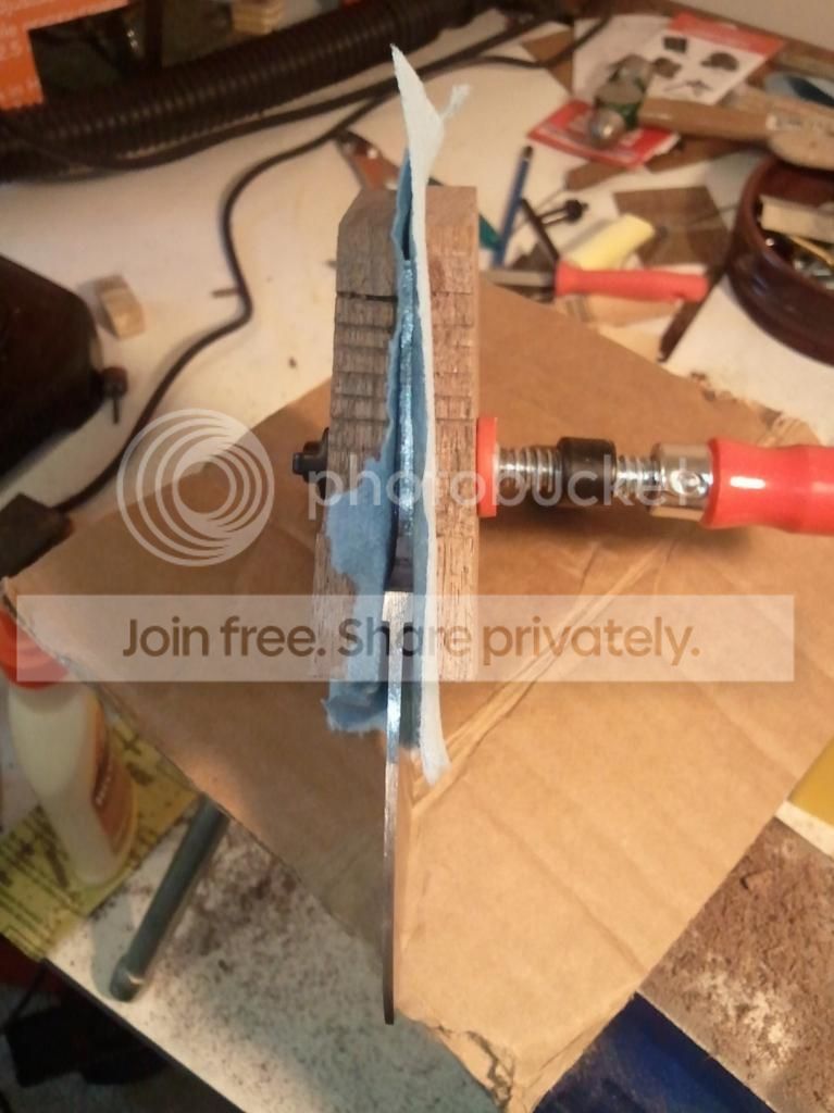

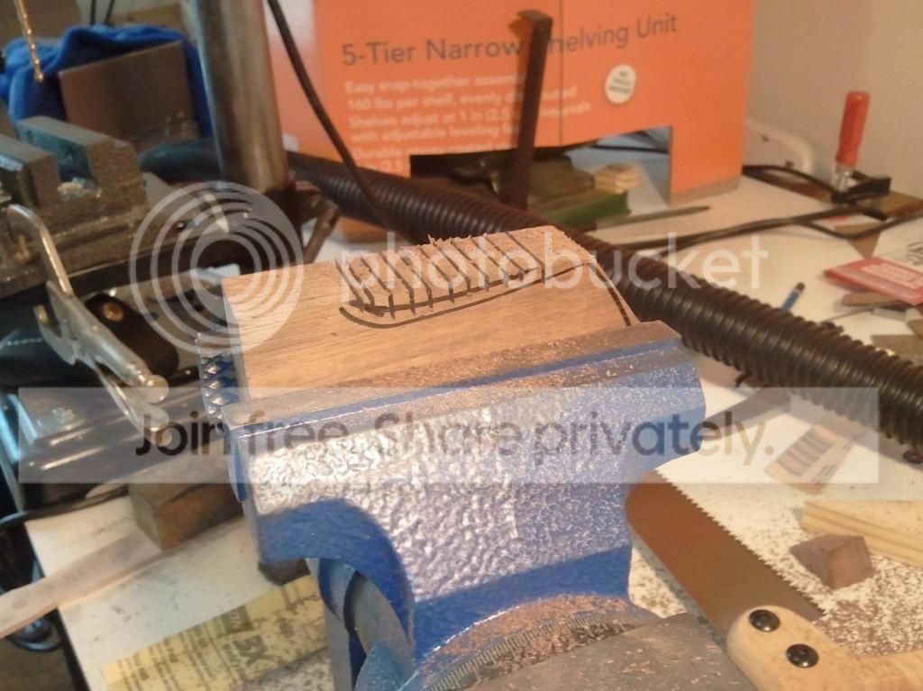

I nibbled off the big portions with a hand saw and chisel, then cleaned up the profile with sand paper and a little belt sanding. I'll drill the holes while the scales are still flat before giving the handle its ovoid cross section.
The scales are attached with a temporary bond (shop towel soaked in wood glue - cleans up with water) so they'll come off with a tap before I take the blade to temper. One only needs light clamping or hand pressure to keep the wood from dislodging during shaping.

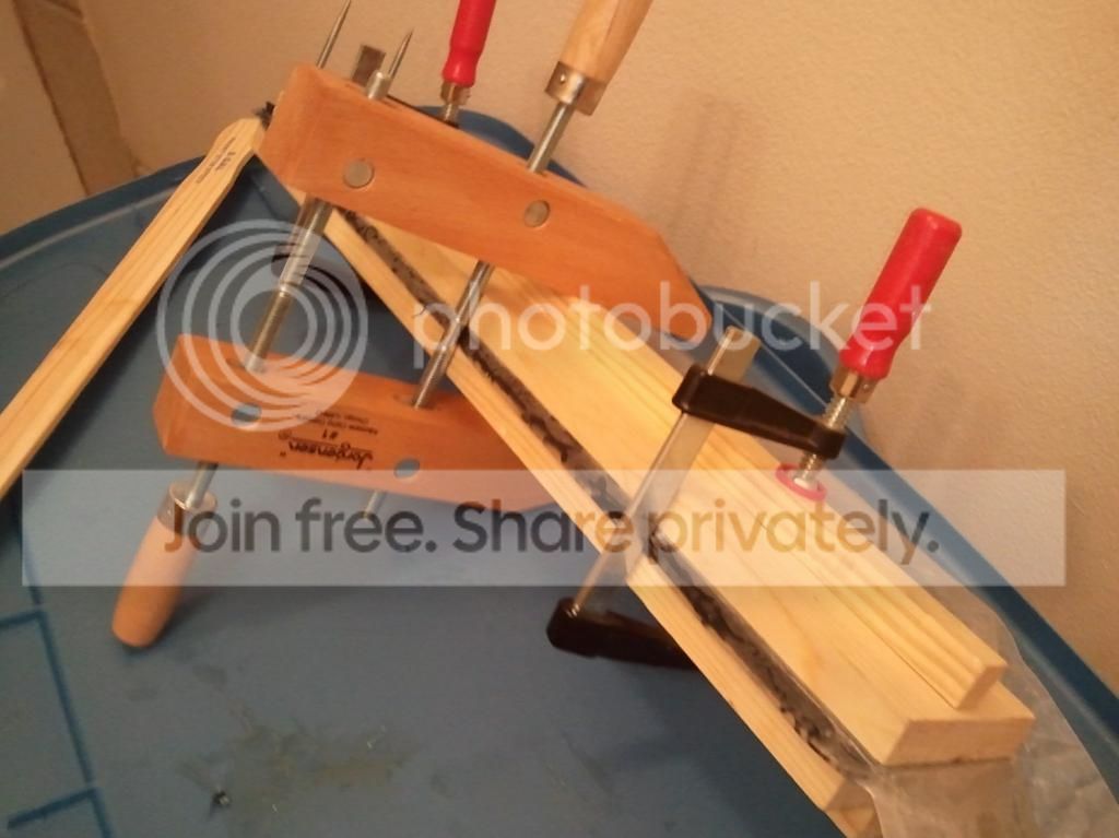

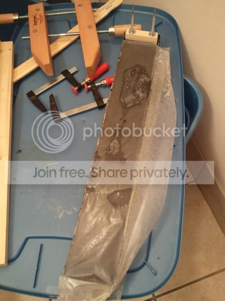

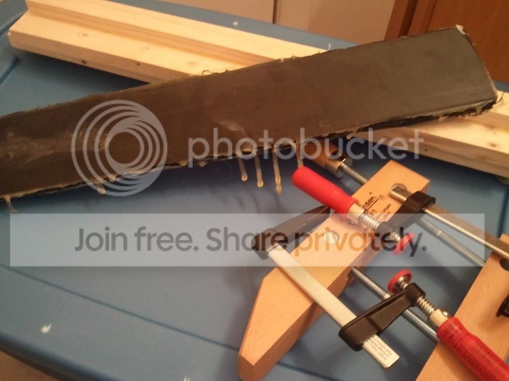

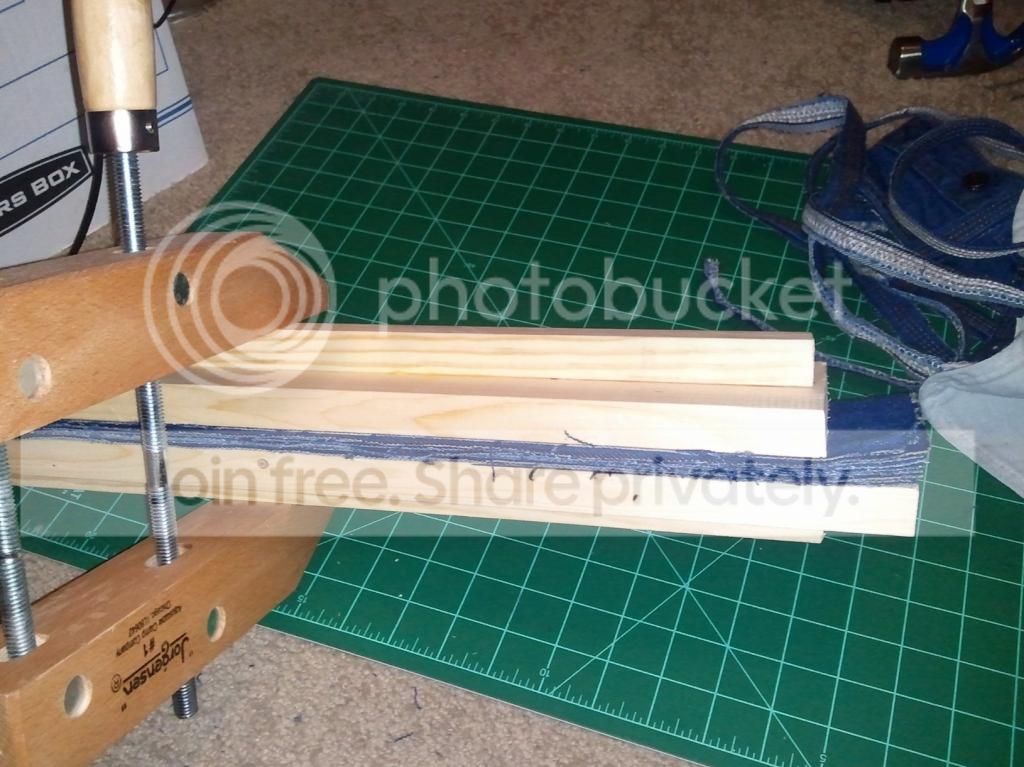

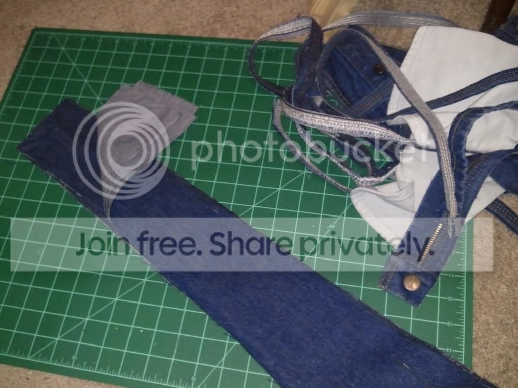

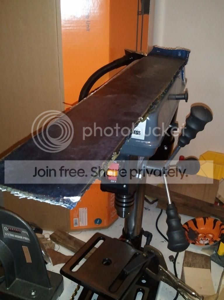

So, this is probably old hat to you guys, but I had a go at laying denim micarta yesterday. Here we go!
Roughly 4" x 24" strips of blue jeans material.
Strips stacked, clamped and skewered into my new micarta jig. The strips are going to be held down at one end while the jig is open and I am introducing the resin.
I laid a wax paper liner underneath the stack with enough hanging out to fold over the top before the clamp is set. I added a stick of 3/4" wood to either side of the jig to spread the force from the clamps, creating an I-beam like effect
The end result. The micarta plank is very rigid while the runners coming off the edge are flexible, so I think I got the resin/hardener ratio about right.
That's all for now :) My next post will cover either wood stabilizing or making of mosaic pins.
Thanks for looking!
When I do my jeancarta, I wrap the jean/epoxy in wax paper, and lay it on a piece of 14x14x3/4" steel, and place 2 plates on top of it, then let it sit overnight. Works great, and I find gravity provides really even clamping pressure. :)
When I do my jeancarta, I wrap the jean/epoxy in wax paper, and lay it on a piece of 14x14x3/4" steel, and plave 2 plates on top of it, then let it sit overnight. Works great, and I find gravity provides really even clamping pressure. :)
I would imagine! That's some heavy stuff. If you center everything it should come out nice, I bet. I was really surprised how little the micarta seemed to compress, although it was starting to gel
up when I compressed it.

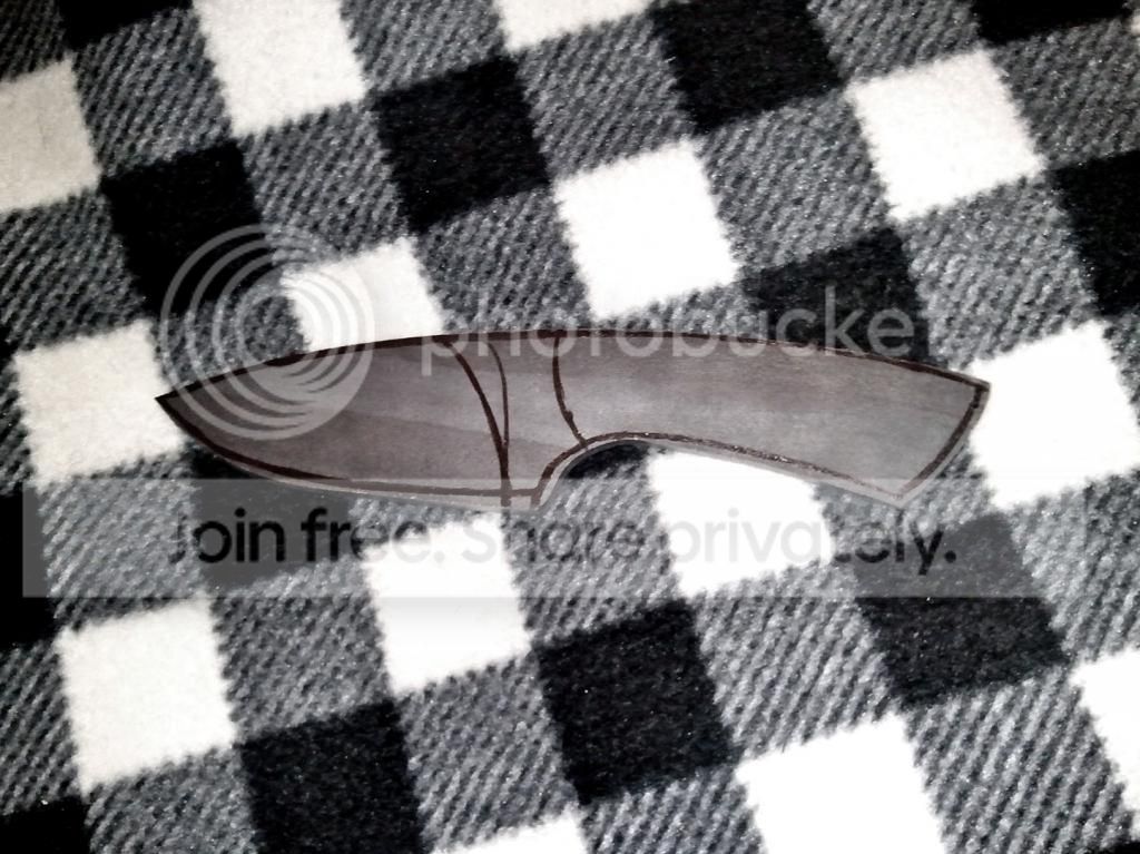

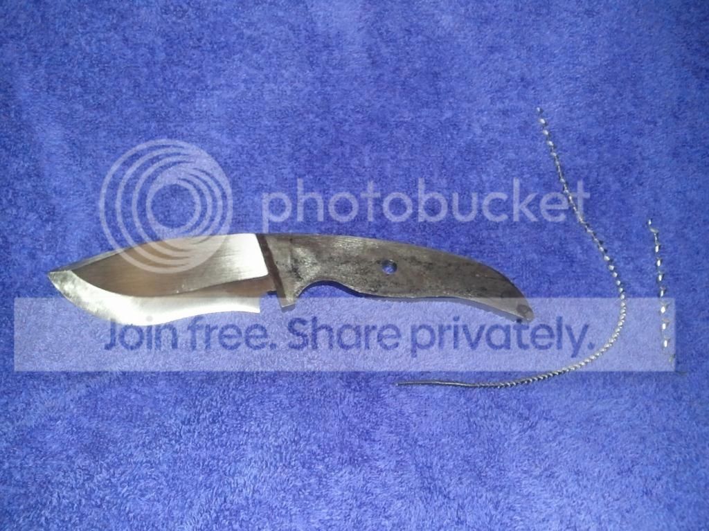

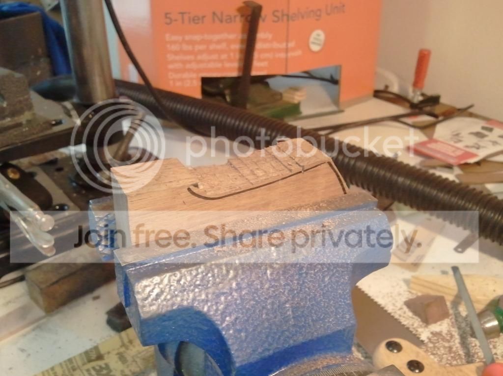

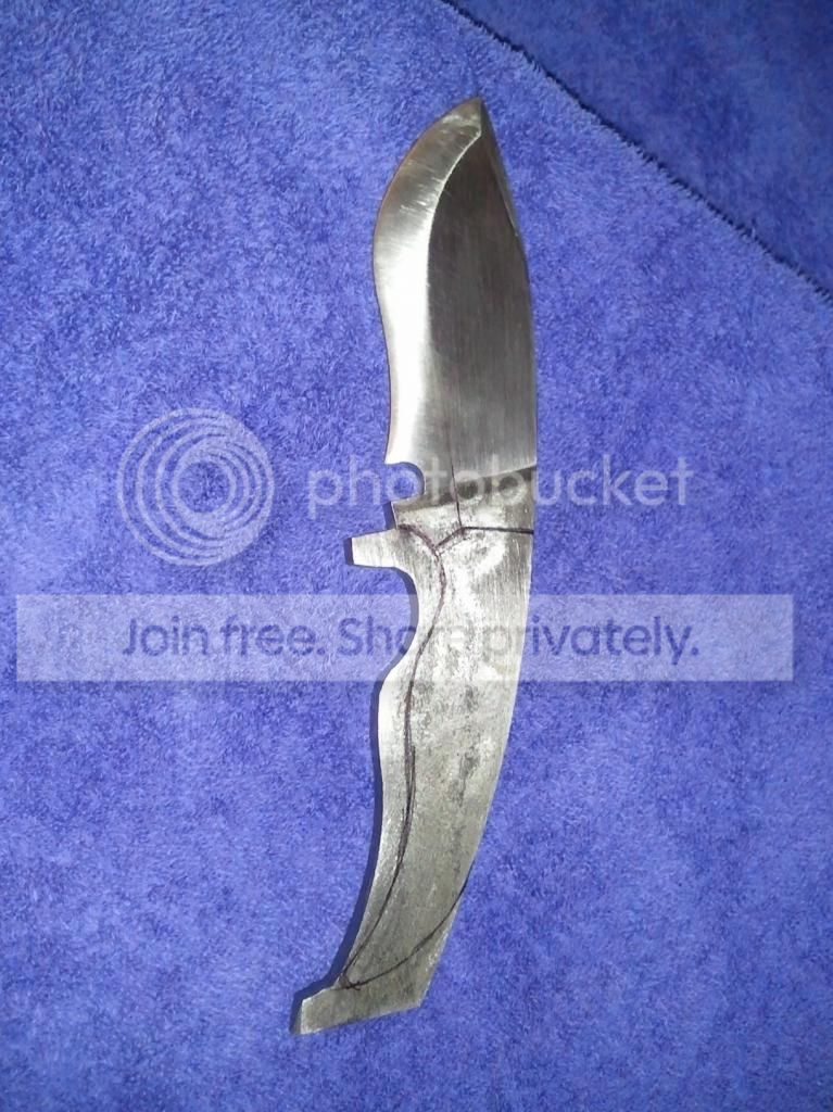

I got back into knife #1. The blade was playing second-fiddle to the handle, so I updated the layout. The original handle design is more appropriate for a longer blade, IMO.
Here is the new handle shape. Btw, I'm loving my 12" Simmonds MultiKut right now. This would have taken forever to hog down with my Nicholson file.
I'm also adding a hidden lanyard hole, but I'll cut that after I have the tang tapered and the scales shaped.
Drilled the pin hole before starting the tang taper
I'm going to put in a single mosaic pin - 1/4" copper tube around a 1/16" copper rod centered in a field of red-dyed epoxy. This will combine with the denim micarta that I made earlier in the thread. Cheers!
Thanks, leifjl. What do you think about the hidden lanyard hole? It just occurred to me that trying to hide the lanyard hole under the scales at that narrow point I've marked may create a difficult threading situation. I could bull through it, but my customer might be a little frustrated with replacement lanyards down the road. Not to mention, the remaining thin tabs of handle material would probably chip away at that spot.
Should I clip the scales and reveal the lanyard hole or maybe move the hidden hole up to the apex of the hump on the back end of the handle? Thanks for the input.:)
