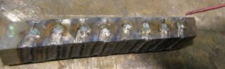

attachment.php
weld into rectangle bar
attachment.php
cut tiles at angle tack weld with mig
attachment.php
weld the face and sides with tig
attachment.php
leave a port to add WD40 one at time spray and welg with mig
attachment.php

David, stupid question but you're adding WD40 between the tiles? To help burn out oxygen or something? Sorry, not much experience with the fancy damascus.

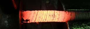

attachment.php
forge edge stock down to round leave ends square.
attachment.php
twist tight
attachment.php
forge to size
attachment.php
etch tile bar to show welds
attachment.php
grind out welds. yes the wd40 is to burn up the oxygen
