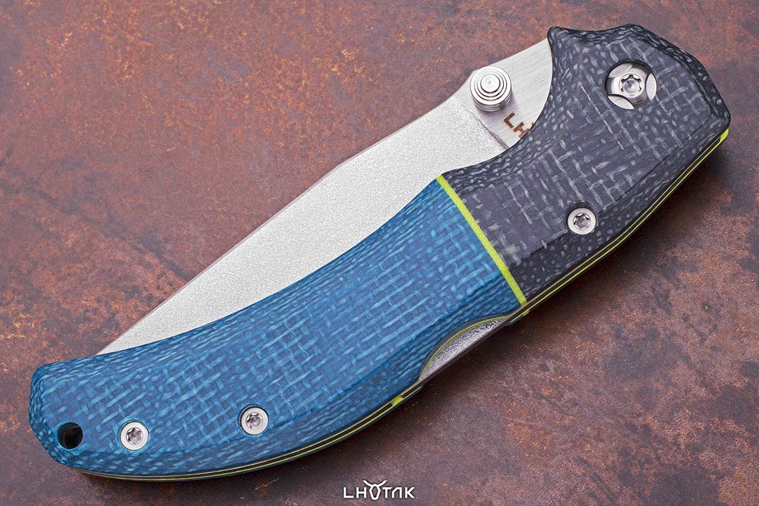

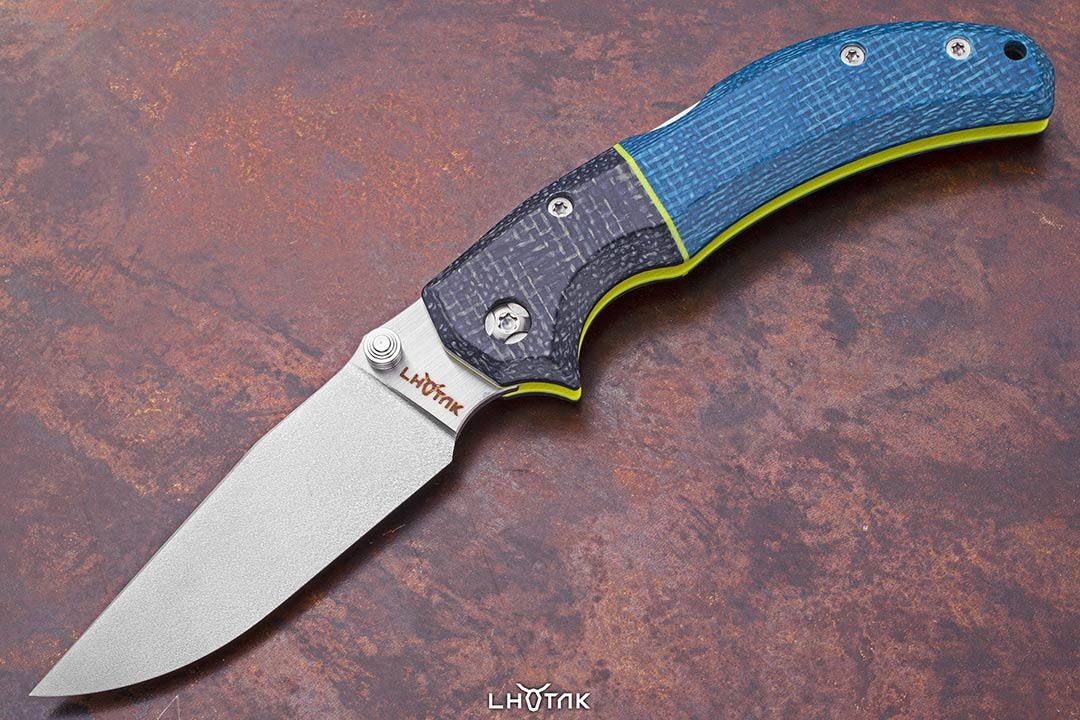

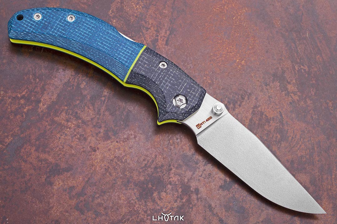

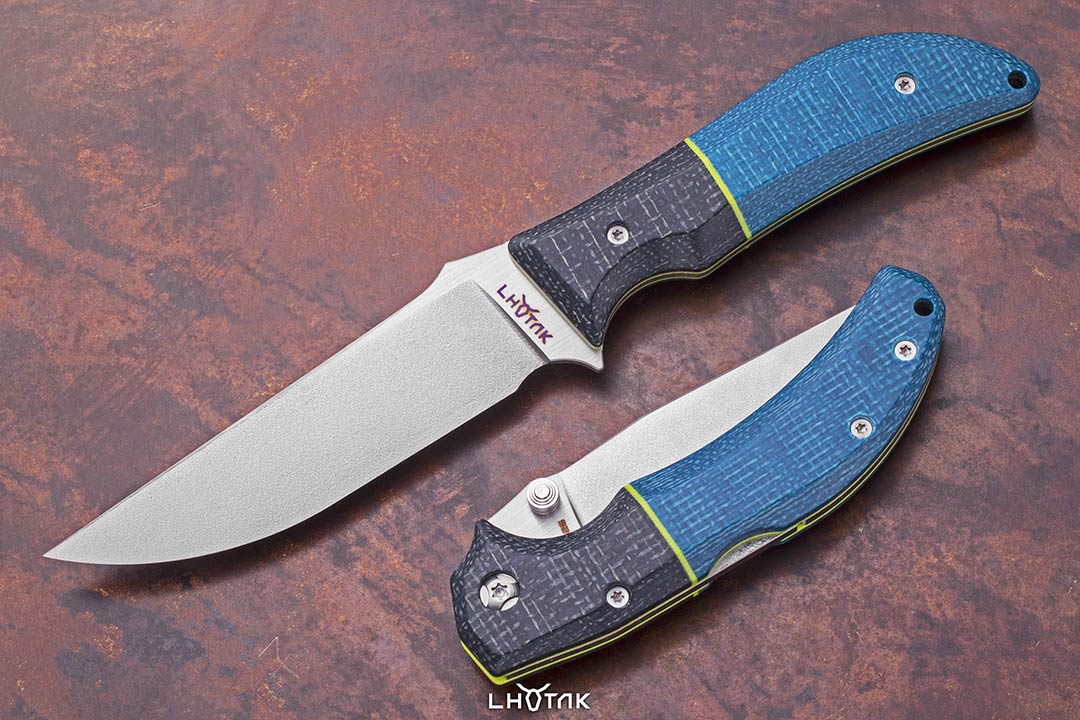

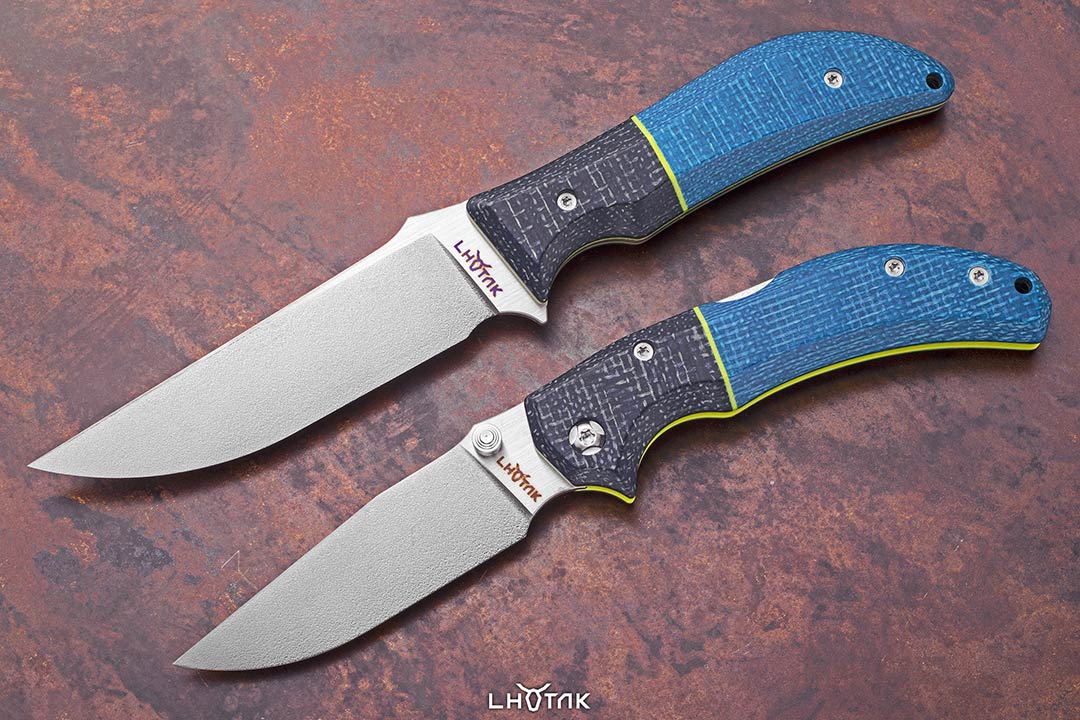

A combo i made. Both heat treated ATI 425 Titanium with Black and Blue Micarta handle and yellow G10 spacer and liner. All other metal parts/fittings are 6AL4V except for phos. bronze washer and bronze bushings on the Folder.
OAL is 8.6" fixed, 7.8" older.
Blade is 4.3" fixed, 3.1" folder.
Weight is 3.35 oz fixed, 2.54 oz folder.

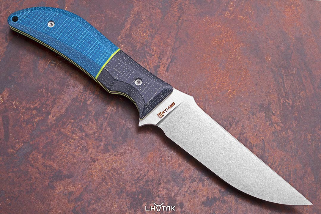

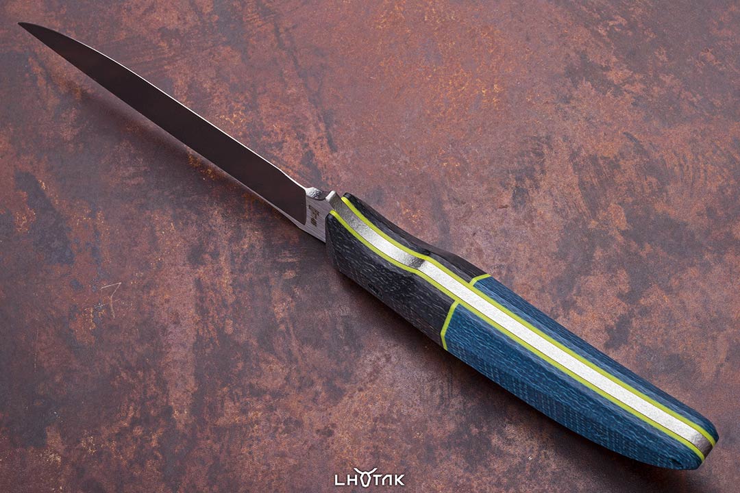

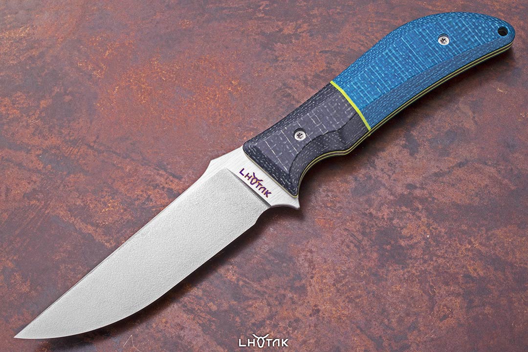

Individiual shots of the fixed:

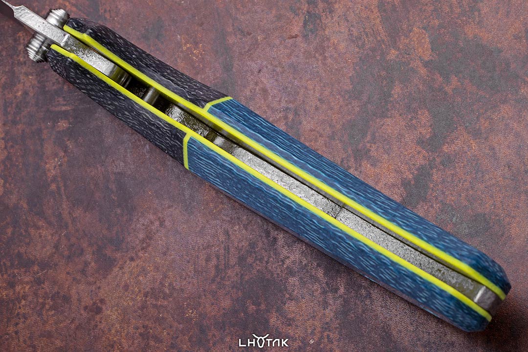

And the folder:
