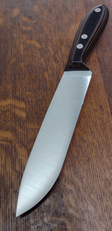

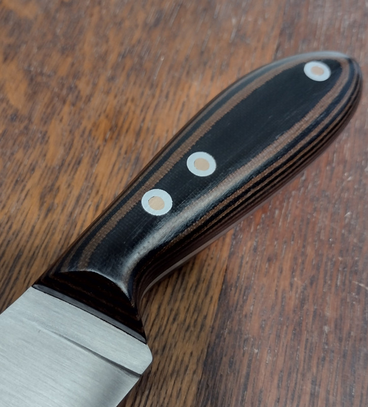

Thank You!!! That means Alot. I'm trying to make it look nice
It's not quite done yet..... :)
I still have to clean up the face of the blade a tiny bit, sharpen, makers mark, and sheath......
I think it's turned out really well. It has my original, full-size LongPaw handle, and handmade Googly-eyes hardware....haha!
I'm working on a name, it is a slicely thin grind field knife. Kinda a French Trade....
I going to call it "Trophy Hunter"
*I'm thinking of sending it to the Exchange, afterwards, because I already have one too simular

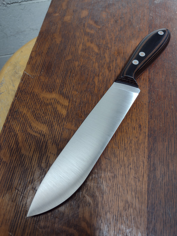

It sure is purty!😉
