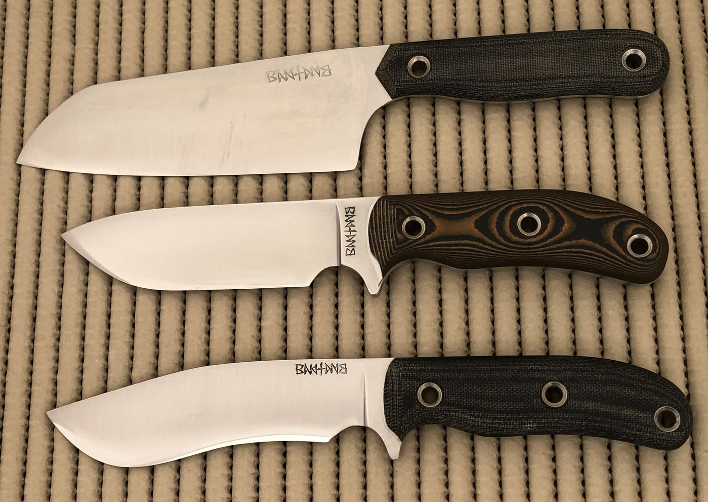

Cleaning/oiling time![]()
Coming from You, that means A Ton, Thank You!!!
And.....brass, it's hidden under the Chilli
I added it for bling, and balance.
It Really did turn out great, but it wasn't easy. Being so Hard, I kept grinding and grinding, it didn't seem to budge. It kicked my butt!
And since Idk how to make kitchen knives, or even know what a good kitchen knife Is?...... I had a steep learning curve. And I was probably four months slow/late according to what I wanted.
but the end justified it, I'm glad I didn't give up!
But, id be happy if my progress is baby steps. Haha, I wanna keep my prices down.
One of the best slicers I’ve ever used. Keeper for sure.
