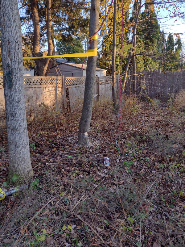

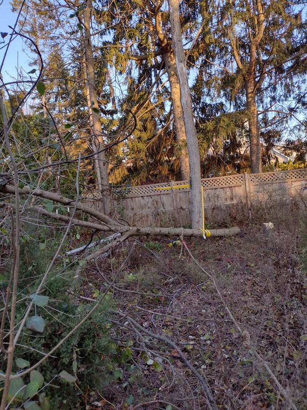

I lifted up my ratchet wench (...) Clocks me in the head....harder than I wanted.

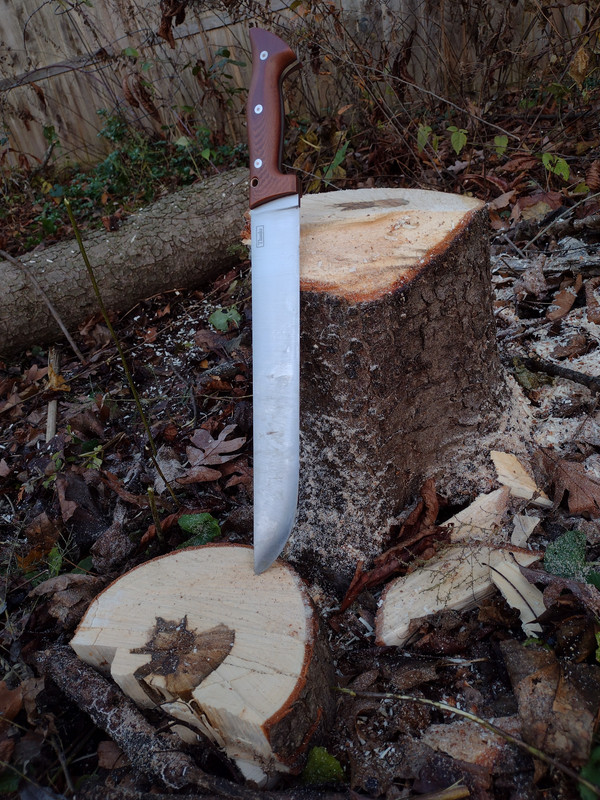

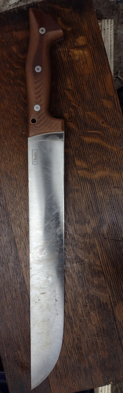

Sorry the wrench got you, but you can’t just put photos like that with no specs on that chopper! Looks awesome!

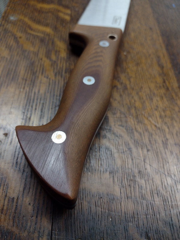

Heal quickly. I love your designs and hope to get one in my hands.I showed it off before. It's my take on a more traditional handle design. Bowie -like.
I have a Wheeler, and I tried to learn from his blade. I added a palm heel feature into my handle. I've never done that before. It was a proof of concept. A learning experience for me....Also I have my AEB-L at 62HRC for this beater. I wanted to see how tough that steel is, That hard.
I might keep doing that hardness for choppers in this steel, for others.
I'm surprised how Good it is.
-this is the Best chopper I own. I think it can hold its own. It's better every time I use it.
I call this model/handle design... "No Sizzle"
I like making Very basic looking knives. Their is a saying, "You don't sell the steak, you sell the Sizzle."
Well, I got No sizzle....... :0. I'm Boring......I like it that way.
Perfect, to me means not having more unnecessary elements to a design.
Less, is More.

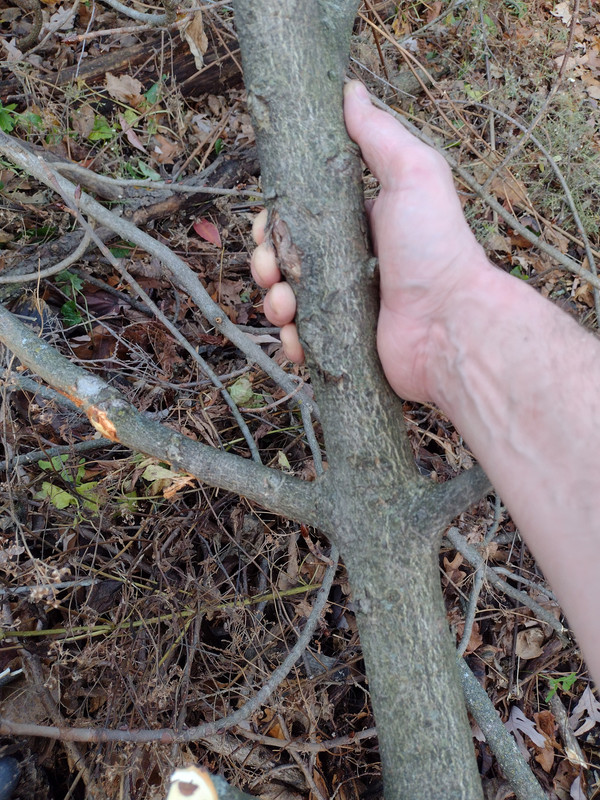

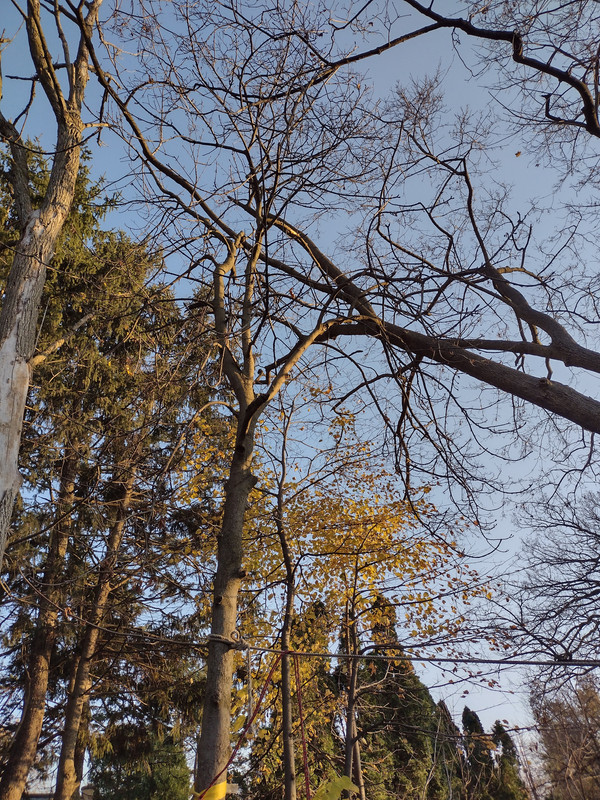

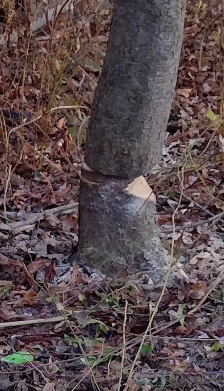

Looks like a maple of some type based on the smoother upper bark and crackled bottom section. I see......I think Mother Nature was getting me back for cutting her tree down....
I didn't want to, but needed to clear out that area.
It was a neat tree too, idk what it was?
You make a hand and a half version of that, I’m down.
26.3 ounces
Almost 14" Blade AEB-L Bos treated 62 HRC
20.062" overall length
2" height flat/convex grind.
Approx. 0.193" thick spine
Natural linen micarta, chili pepper, and black Vulcan liners. Handmade aluminum and bronze hardware. Front flared tubing.
Cuts like a Tank. No edge damage.
The pinky area is Very comfortable.
My next ones I cut out are Insane.
