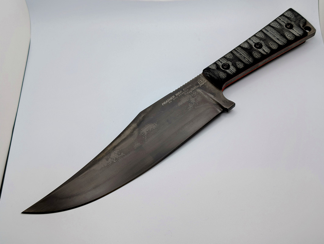

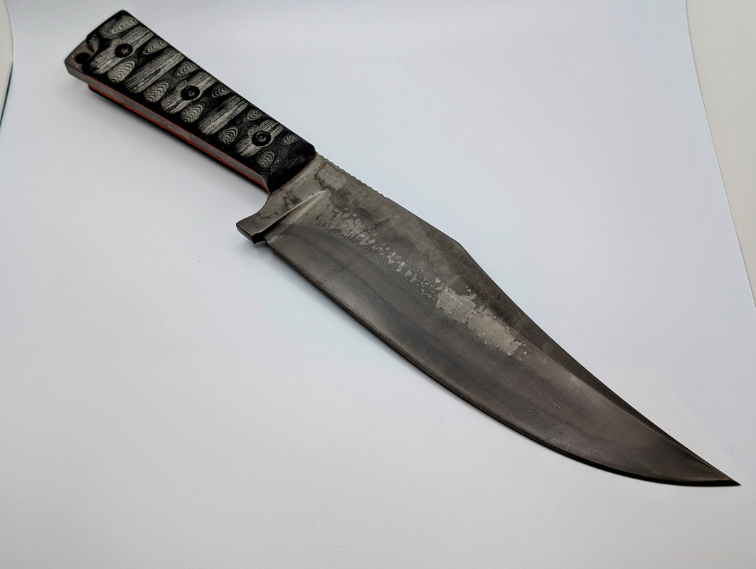

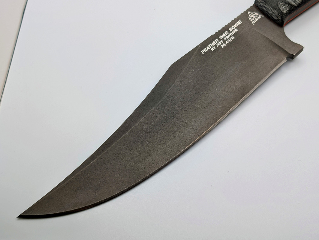

Stripped and refinished my TOPS Prather War Bowie. Took me a few days.

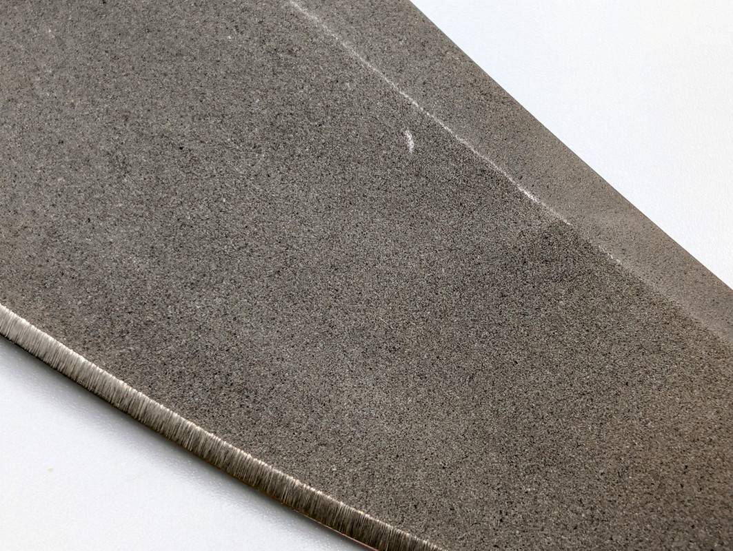

Applied paint stripper, then scrubbed with acetone. These are media blasted and have an extremely rough finish. I figured that would be a major rust factor, not to mention worse cutting physics.

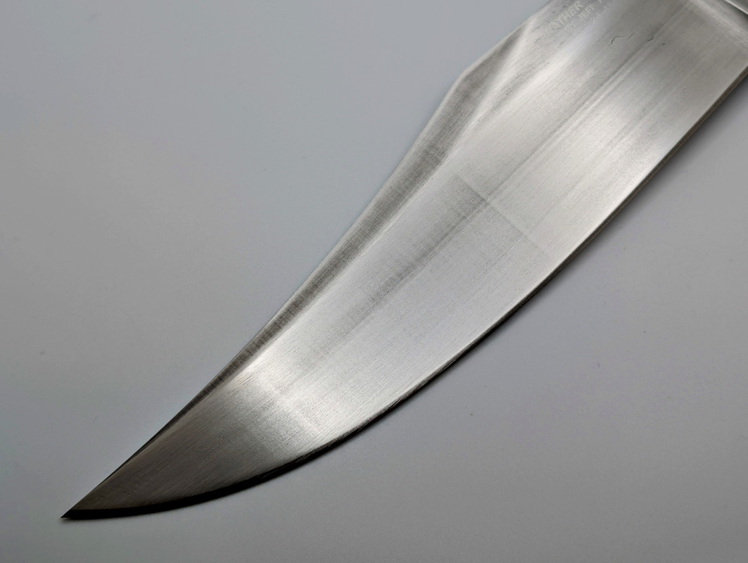

Initially sanded with 320. You can see some of the rough grinds underneath. This picture makes it appear better than it was.
Re-started sanding with 80 up to 400 and then soaked in vinegar for 8 hours. I find it really interesting that it brought out the hamon. Even though I scrubbed the knife with alcohol first, the patina didn't take to well in a couple of spots. I like it better now!
