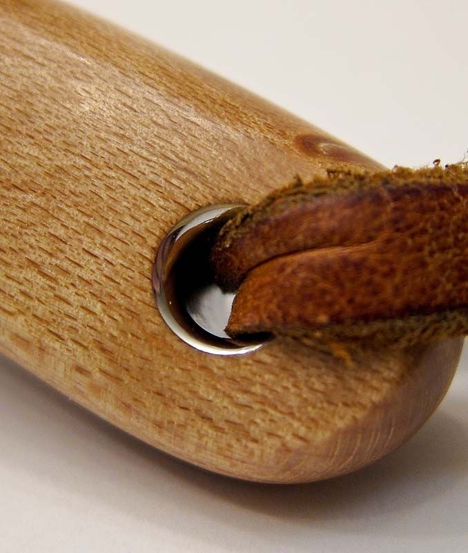

Tim Wright is one smart dude and just a little bit anal ;) but in a good way, his work is about as flawless as I have seen,
here's an of sample of how he did the lanyard hole on this small knife
