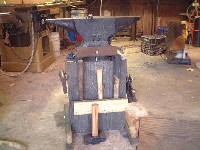

I tripped over this one in an antique store....I had to buy it :D
The ratchet straps came off after the liquid nails set up.

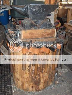

Heres mine.... Doesnt move an inch. I drove wedges under the sides of the stump and its been in the same spot ever since no matter how hard i hit it.
Anvil is a 200 pound Peter Wright

Joe, Did you just use the Liquid Nails where the anvil joins the 4X4's? Both the anvils I have set up at this time rang horrible before I went with the construction adhisive althought I used the adhisive to hold the bases together as well. On my Made in Sweden anvil the base is stacked 1' square 3/4" plywood pieces that were glued and then nailed individually with ring shank nails. Then I glued the anvil to the base. With the Trenton that I set up over the weekend it sets on 6X6's that run vertically. The 6X6's were glued and then bolted together. After I had the base made I then glued the anvil and the lag bolted it to the 6X6's. I went with the cheapest construction adhisive Home Depot had and I'm not sure if I had gone with maybe Liquid Nails it would have done more. The Trenton will let out alittle ring if struck on the horn or heal but the noise for both when struck on the face is a low thud.
