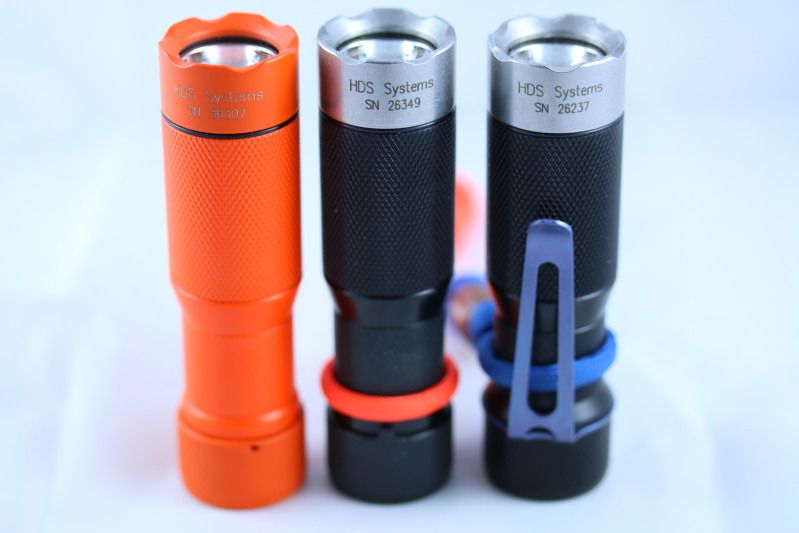

I love my two HDS Rotary Flashlights. Got some new matching bling for them.
325 now? He's inching his way up the "lumen ladder"..... I do like the Orange cherakote though. (Resist)
Resistance is Futile...;)
If I get time tonight, I'll try to get some beam shots. The hot spot is almost double in size of the 250, but the spill is very similar. The 325 is actually warmer in tint than the 250.
Here's the bidness end.
325 on top...250 on bottom

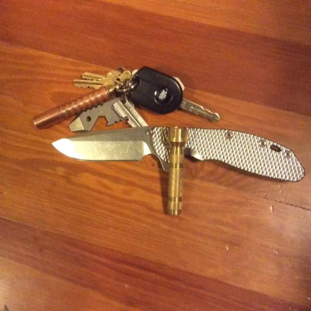

Here are a couple of back-ups to the back-up, AAA and 10440. The copper one (Prometheus) has a pretty slick quick connect. The brass is a Peak Eiger.
