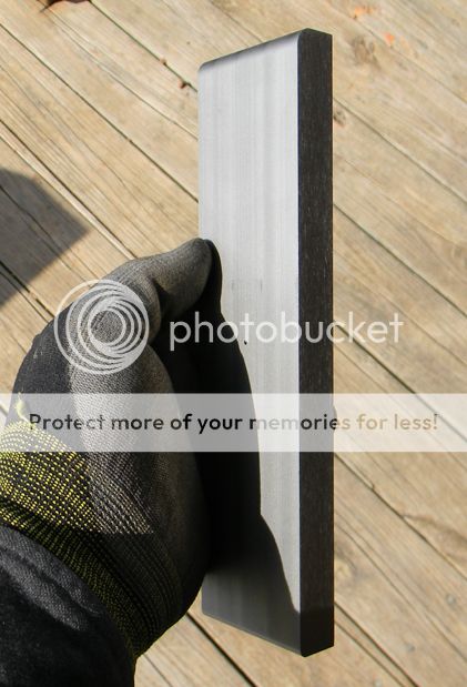

Flat platens are sold out. There are some radius platens and patten chillers still available.
36", 48", 72" curved platens, flat platens and water cooled aluminum chillers.
These are machined of A2 steel and hardened to HRC 61-64. It is 1/16" shy of 8" to fit between the rollers, 2" wide and has the KMG 1/4-20 6.75" center to center mounting pattern.
Radius is $110, flat is $90, the chillers are $50. Flat rate shipping in the USA is $5. The cost of tool steel and carbide keep going up, so if I make these again in the future it will likely reflect my rising costs.
There are fifteen 36" platens, five 48" platens, ten 72" platens and twenty flat platens. These simulate 3', 4' and 6' wheels. Be aware that the 72" grind is too subtle to really notice with your eyes. I think it is mostly used by folks making certain kinds of kitchen knives.
In using these platens I have found the effect is subtle, but noticeable. It isn't a flat grind, but it isn't really a hollow grind. I believe this is a historically accurate grind for blades ground in yesteryear on really big stones. I see this being a cool grind for blades made in an older style, and blades like kitchen knives where you would want a full height grind on a tall thin blade.
If you look closely, you'll see a tiny hole in the surface of all of the platens. On the opposite side of the hole I have cut a 1/4" NPT pipe thread (a regular taper pipe thread) which you can (if you want) use to pressurize your platen with air.
One of the problems of grinding on a radius platen is heat, and the addition of air between the belt and the platen both reduces friction and cools both of them. It is possible to grind with high belt tension and a large contact area at your highest speed for hours at a time without excessive heat buildup. This only works well with a stiff belt. Once you get into something like a j flex you will find the air cushion rounds the leading and trailing edge a bit. At this point you will want to move away from the air zone or reduce air pressure. I get best results with the air pressure between 5 and 50 PSI.
You don't have to use air to use these platens. This is a feature I have added by request.
The new flat platen is thick at 5/8". It is hardened A2. The mounting holes are now blind so there are no holes in the working surface except the tiny air bearing port. It has a radius on the leading and trailing edge that can be used to clean up integrals and otherwise grind your plunge while finish grinding a blade lengthwise. This is a very cool technique. You remove your top roller, lean the platen way back and wrap the belt around the end of the platen and grind the blades lengthwise at low speed. The finish almost looks hand rubbed and this can greatly reduce your hand sanding time. There is an 1/8" fillet on one end and 1/4" on the other to grind perfect plunges. Like any new grinding technique you should practice on scrap before trying it on real work. Due to the severity of the bend, it gets extremely hot very quickly so this can only be done at low belt speeds and you will probably want a chiller if you plan on doing much of this.
By request I have made some aluminum platen chillers. These work very well if you're having difficulty with excessive platen heat.
These have an internal meandering water path circuit where you can pump, siphon or otherwise flow water to control the temperature of your platen.
The mating surface is precision machined flat and the back of my steel platens are also precision machined flat so you can simply bolt these up and get fairly decent heat transfer. For better heat transfer or to use a platen I didn't manufacture you can use a little thermal grease during assembly to get really good heat transfer.
Because the chiller covers the air port, it is not compatible with an air injection setup. This is a one-or-the-other kind of thing. It is sealed with a buna N o-ring that is rated to 250 F. The o-ring is compatible with water, antifreeze and most oils. It is not particularly compatible with acetone, so if you're planning to flow subzero acetone through it for use as frozen quench plates - you probably shouldn't. The assembly can be opened to remove clogs or replace the o-ring if necessary. If opened, you should use a little smear of grease to lubricate the o-ring upon reassembly.
The pipe thread is a standard 1/4 NPT. You are responsible for hooking up your own coolant supply. I recommend 1/4" swivel push-to-connect fittings and plastic tubing, though rubber hose and hose barbs work too. I'm using a dinky little centrifugal pump here and a bucket of water. The meandering coolant path in the platen chiller induces a lot of turbulence in the water flow which helps you get good heat extraction without needing a lot of water flow. An aquarium pump is adequate. Or you might opt to hook up to your regular water supply and simply dump the water (though you'll go to hell for wasting water). Just remember you don't need huge flow or pressure here. Keep up with your tubing to keep it out of the grinder wheels and mechanism using zip ties or similar.
