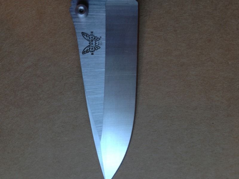

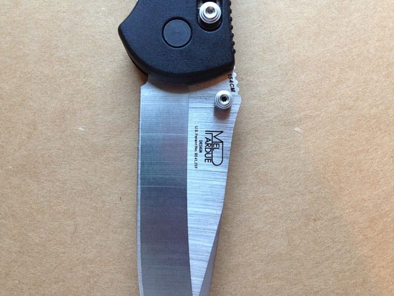

Sweet knife dude! I don't have that many ZTs, however I've received knives with very similar marks from both BM and Spyderco. One was a Griptillian bought from Cabelas just after it opened. (It had 4 or 5 lines like that). The other was a HAP40 Stretch that I had pre-ordered. They're simply cosmetic, which doesn't bother me as mine are all users, but what you do with yours is totally up to you. I would be interested to hear what ZT said after seeing them. Good luck in getting it worked out! I'll try to snag a pic of mine for ya!
Nothing to worry about, I've had a couple worse than that. It looks like final grind on the blade incurred a little blemish. Probable can't see it at different angles.
Once you start using it, it'll blend in with the other personality marks you'll give it :)
Here's a quick visual aid, you can see a few lines on is little fella, the Stretch is already way to scratched to tell......just the way I like it! :D
