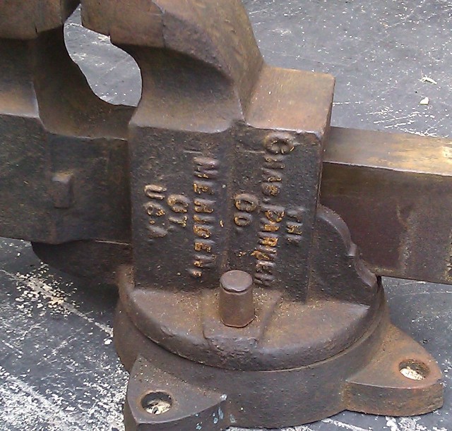

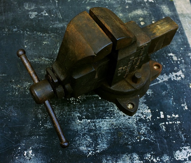

This Chas. Parker swivel-base viSe was sold twice this morning... to me the second time.
At $40 it was still a steal.
I believe it's got 3" jaws with a 5" opening.
I'll post some more pix once it's cleaned up a bit.
This ought to replace my wobbly Pony viSe...

Hi Daizee,
If on the other side it say's #954 I have the Identical vice. Sturdy is the word I would use for it.
Nice buy,
Dave

Dave, I'll check that number when it comes back from the spa.
There's another one in the Family, similar but considerably larger.

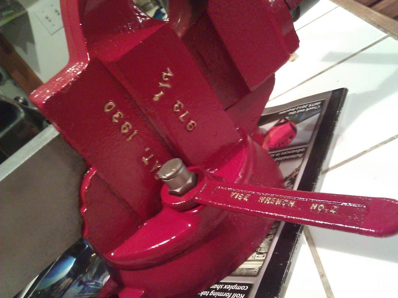

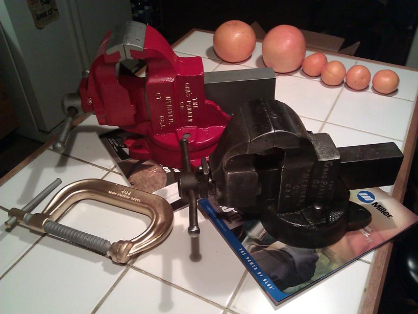

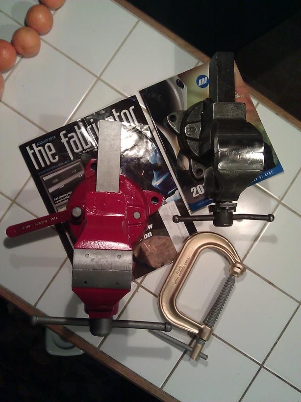

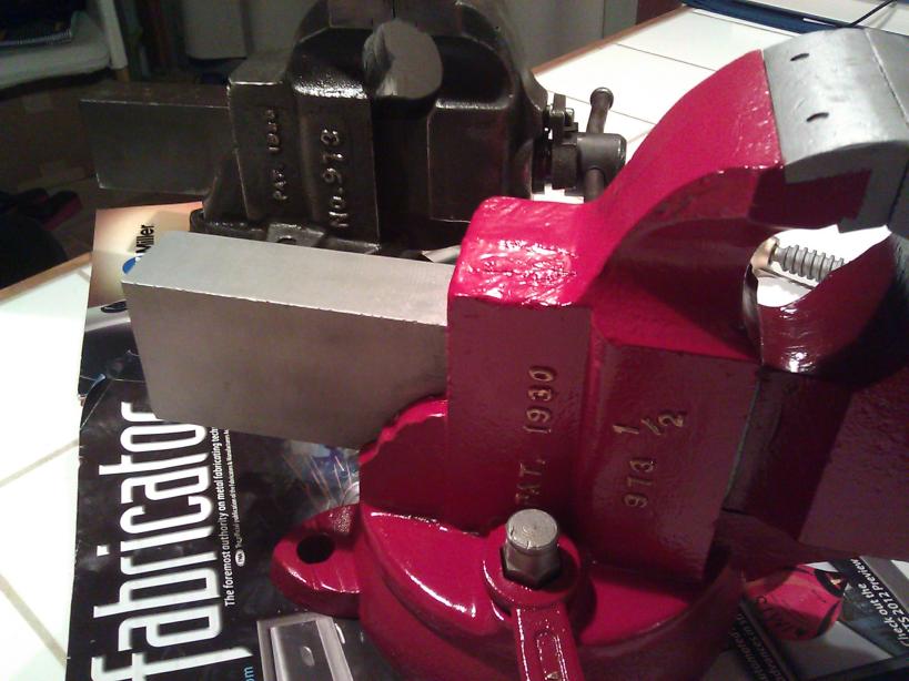

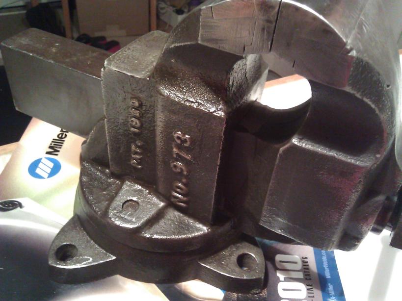

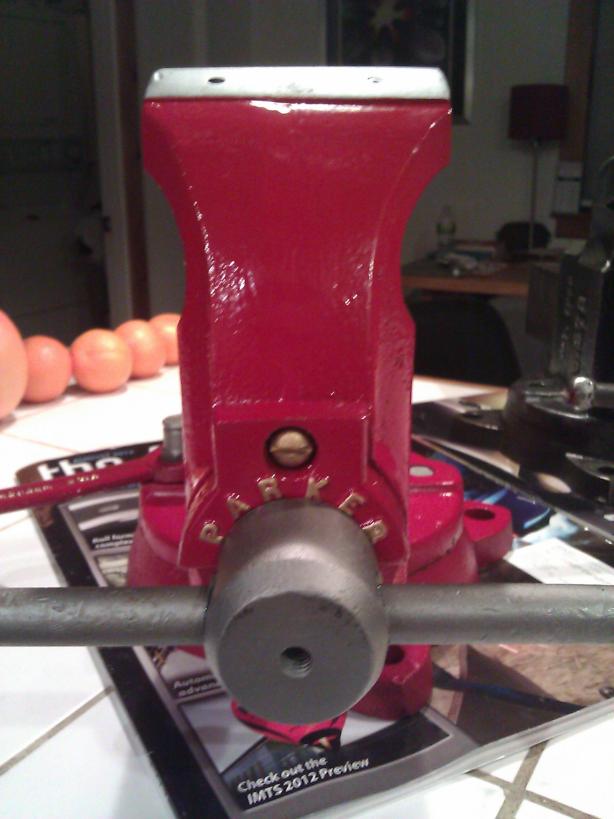

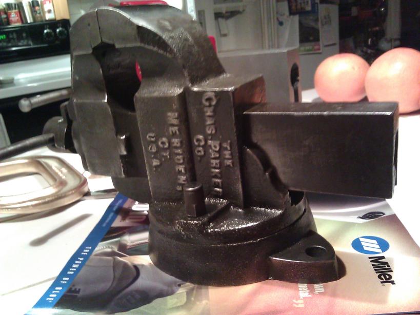

I can't wait until tomorrow, so here are some low-light phone pics!!
HeftyLeft is The Tool Spa!
The natural one is mine, the red one is hers (you shoulda seen how gunky the red one was before restoration...):
That red is RED, without the pinkish hue the camera gives it. The Wilton clamp was picked up the same day as the smaller vise.
dang, I jittered.
Beautiful. I love tools with well executed paint jobs. I also love tools with a natural patina. Thanks for sharing.
Very nice. What are you cleaning them up with. Care to share your process? I have cleaned up some old rusty tools with citric acid. I had a local guy show me that trick and it works well. If a tool is really pitted with rust it won't take the pits out but it will clean the rust right off.

I like the way you repainted too. I tend to highlight the forged trademarks on my good equipment too. (which is a recent upstart effort of mine)
Thanks for checking. The process depends on what I'm inspired to do and what the owner wants; Daizee cautioned against a restorative treatment that might require he throw his vise a coming out cotillion--he'd never touch it because it was too pretty. I was motivated by the thought of relegating his pony to the slaughterhouse. Boring details and not what you asked but it's late after a long night in the shop with an ugly machine, and flixNet dubbed(!) my relaxation kung fu movie *GGGrrrr*
I always begin the same way:
-- I disassemble _everything_
-- Arm&Hammer laundry soap and a horsehair brush &/or brass wire brush (I leave the fancy de-rust-ification alchemy to the competition tool reincarnators and tools of precision whose original properties I'd like to retain as much of as possible) NB This cleaning method does _not_ degrease or de-rust completely, btw, which can be good or bad depending on which fork in the road I need to take to continue
-- While cleaning out the small spaces with dental tools I inspect: all threads, ways, castings; replace all missing and wrong hardware; re-thread the needy and file the burrs
The next steps are determined by desired aesthetics. All surfaces are painted/waxed/oiled/greased/antiseized/polished/protected as required.
I know it's not as sexy as Frankenstein's electrolysis tank filled with electric rust eating beetles of unusual size with muriatic acid for saliva.
