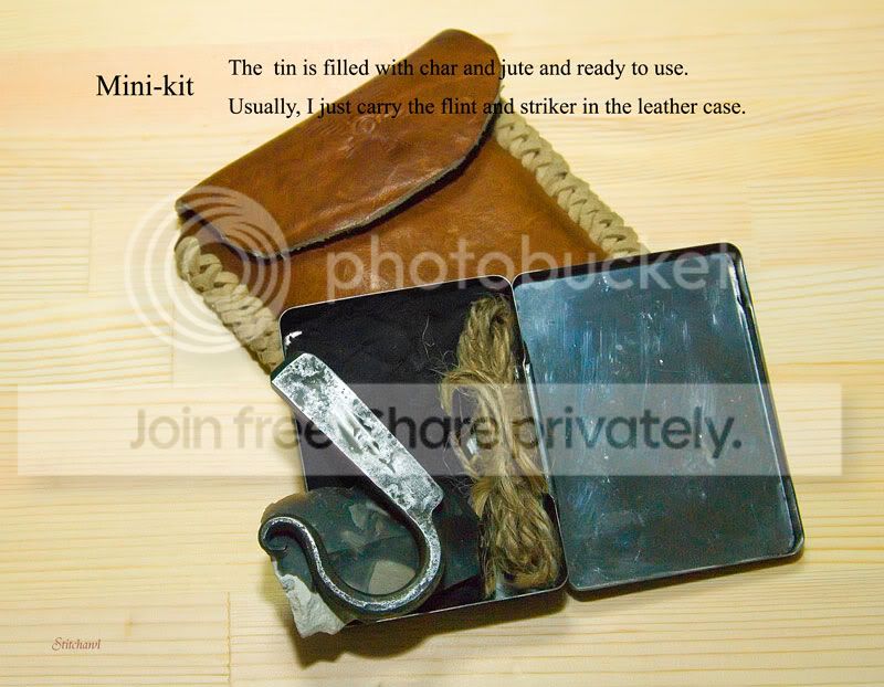

Here is a little 'mini-kit' that I carry 'just because...'

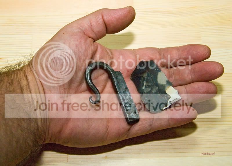

Even though it's small, it throws more than enough sparks to light a fire. You just have to be extra careful not to slice your fingers... Usually strikers are 2-3 times larger than this one. To give you an idea of the size of this little guy...

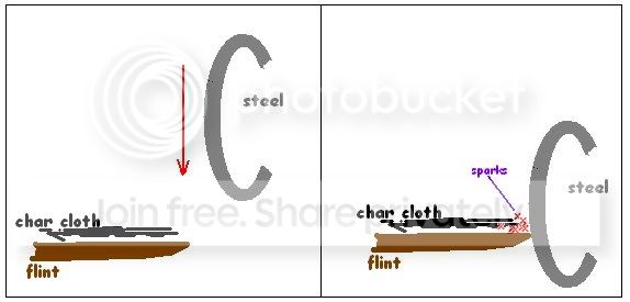

BTW, GS, try with the char cloth on top of the flint, not underneath it. You may find it works better.

What do you mean on top of the flint:confused:

It looks like you are holding the char cloth underneath the flint (taken from the perpective of the steel). In other words as you strike down with the steel, the steel approaches the flint first, with the char cloth underneath it. If you're having trouble picturing this, I'll take a picture or make a drawing.
Remember that the flint takes a tiny shaving of steel off, so that shaving generally lands on top of the flint, first.
Doc
I'll see about getting a picture this weekend when there is somebody to either hold the char cloth/flint or take the picture. I'm not saying this is the proper way to hold it, just the way I was shown, but it makes sense to me.
Doc is dead on in his sketch, I took this pic to for ya too. The cloth lies on the top of the flint, you strike the edge (make sure it is a sharp edge) of the flint where it and the cloth meet. The cloth catches the sparks. Don't be afraid the tear the cloth, you can even lay the cloth over the edge of the flint then strike it through the cloth. In my above post also shows video bearthedog took this past weekend of me lighting char cloth with my steel. Hope this helps. Took me over a month of constant trying to figure out how to do it properly. I was laying the cloth on the ground and stiking the steel over it hoping a spark would land on the cloth ***this method does not work well at all*** After a TON of searching online and I finally figured it out. The cloth goes ON TOP of the flint lol, I felt really silly.
