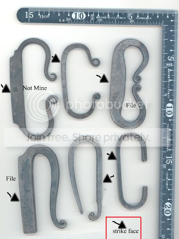

Here's one more thought on the subject; you can hold the flint still and strike it with the steel, or you can hold the steel and strike it with the flint. Both work, and the only difference is your own comfort, and THAT will be a result of the style of steel striker, how you are holding it, and the size of the flint! With a properly made striker and good flint, you should get a shower of sparks with each strike. If your char is dry, one or two strikes should give you an ember.
Just remember that the flint needs to be sharp, and that you are moving your soft fingers quickly and hard in the vicinity of a very sharp edge. I prefer strikers that allow you to hide your fingers BEHIND the steel.... I have a nice collection of strikers, some that I bought and some that I made, but most protect my fingers. I like my fingers even more than I like my strikers.
This is a pretty old photo. I've since gotten a few more different styles from different cultures and countries. Interesting to note the difference between the styles from the 1700's fur trappers to the style used during the American Civil War.
Stitchawl

Here's what I found out when I began making them...
For my forge, I used my BBQ grill most of the time. :o A couple of times when showing friends how to make them, we used #10 tin cans with the ends removed and some holes in the bottom, and filled with ordinary charcoal. I used my wife's hair dryer for forced air, and ordinary pliers to lift the metal out of the fire. I used a large rock for an anvil and an ordinary framing hammer to fold the steel.
It should be very good quality high carbon steel to begin with, such as you'd find in old, well made files. (Best source is old flea markets and yard sales!) The lower the quality, the fewer the sparks. New files, if they are good quality work fine too. One of the best steels are the tines from old tractor rakes, but watch out for old farmers. :p
For the ones I made easily without any special equipment, good quality rat tail files worked well. They don't need to be round or flat. Any shape is fine, but you do want to anneal them in a fire to grind or file off the teeth more easily. A flat, smooth surface is what is needed for the strike face. The wider that surface, the more sparks can be thrown, but if you use a very thick file the resulting striker will be heavy. 1/8" - 1/4" is fine.To anneal it, just heat it to bright red and let it cool without quenching.
After smoothing and shaping the striker to your liking, you MUST harden the strike face. If it isn't hard enough it will not throw good sparks. To do so, heat the metal to a dull cherry red color. At this stage the metal is called 'martinsite' and it will no longer be reactive to a magnet. Use a magnet rather than trying to judge the color unless you're a blacksmith... Once the steel is no longer attractive to the magnet, quickly quench in cold water. Use a file or emery paper to remove the fire scale and try to strike a light. If it works, and you have a good shower of sparks, you're done. If there isn't a good spark display try reheating the steel and quenching again. On a couple that I've made in the BBQ grill, I had to re-heat several times. On some, I never did get a good spark and deep sixed that piece of steel. Use good steel, use the right heat, and you should have a fireworks display every time you strike a light.
