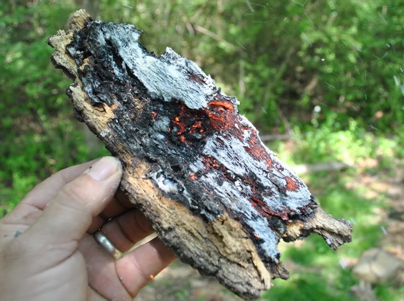

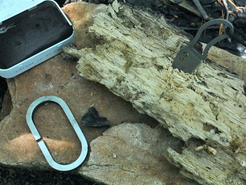

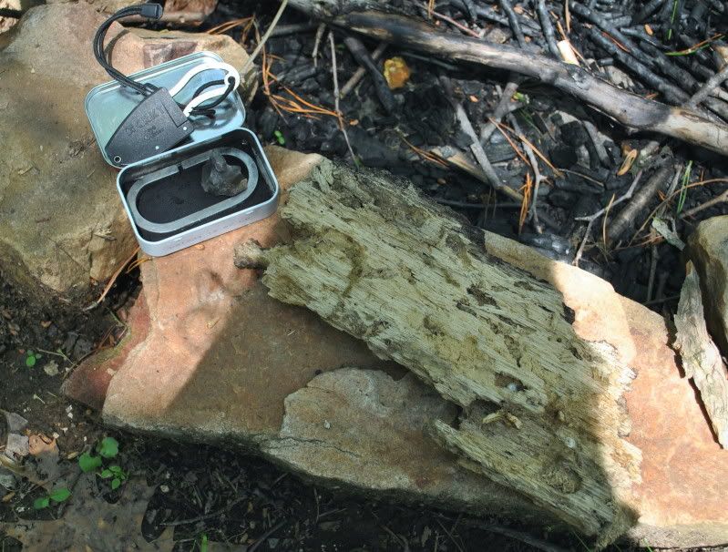

Today I played around a little with flint and steel using punk as a coal extender/expander while i waited on better light for the photos I needed to take for work.

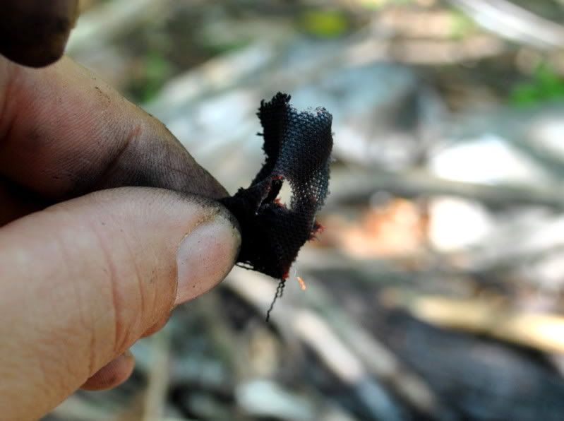

The first step was to make a pocket in the punk to insert the char cloth into.

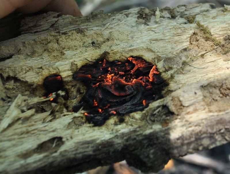

Then spark the char cloth.

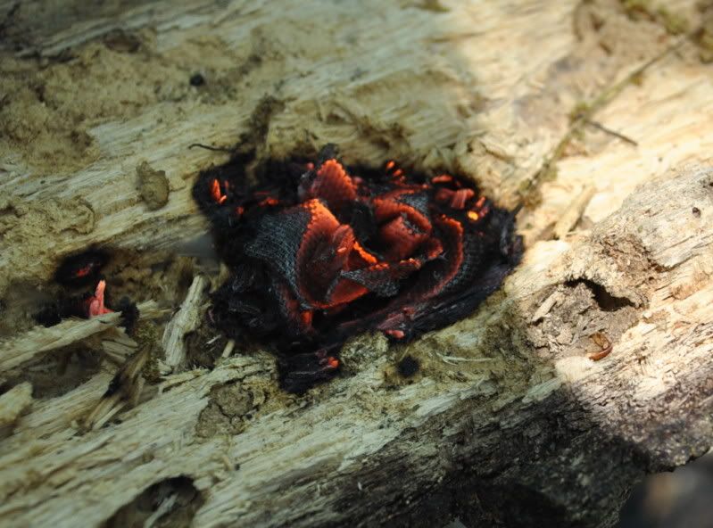

Then place it in the pocket and give it some oxygen.

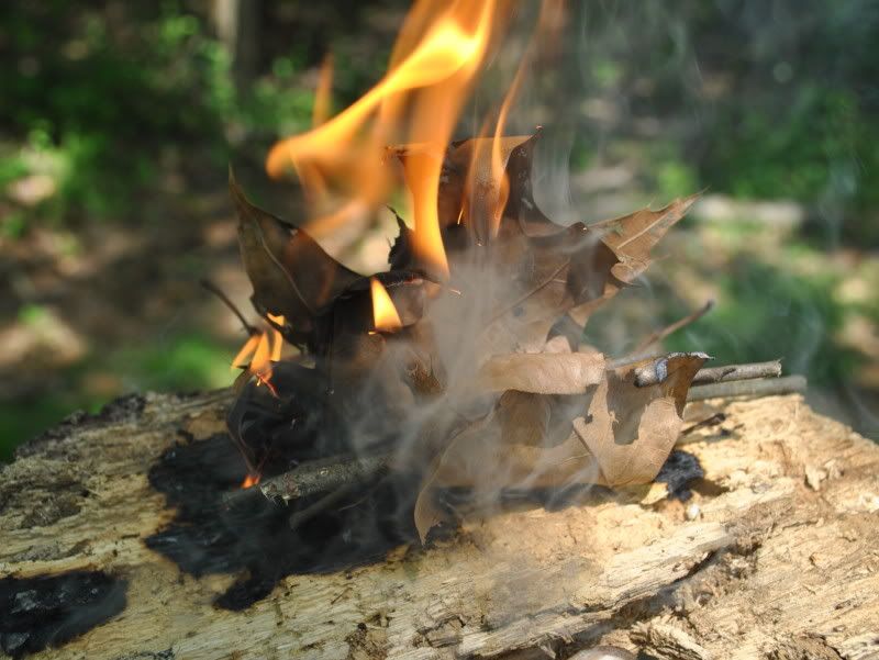

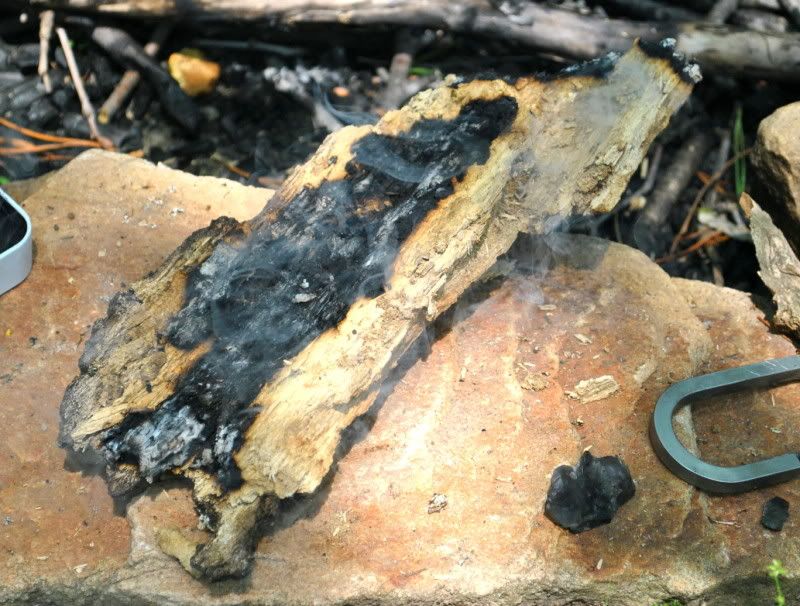

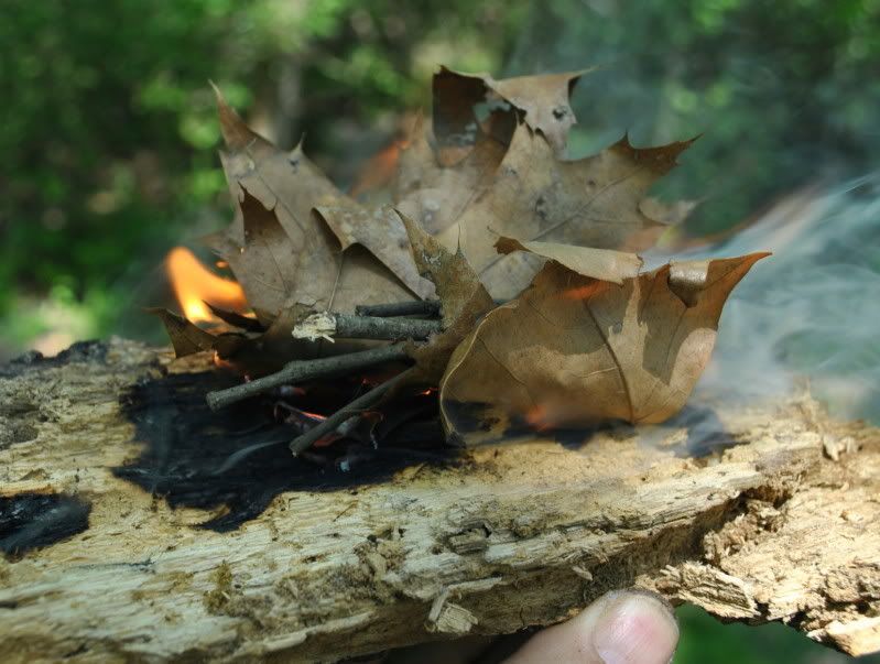

After expanding the coal a good bit, Next came igniting the dry leaves and twigs I had for tinder.
It would have been easy to ignite a few fires with this one large coal.

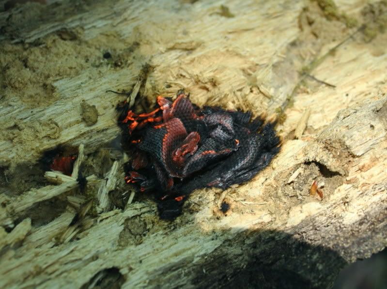

I just sat the coaling piece of punk on a rock and let it smolder to help keep the mosquitoes at bay.
And I still could have started another fire or two nearly an hour later.
I may well have been able to just spark the punk itself if I had a bigger piece of flint on hand, I'll have to give that a shot later.
