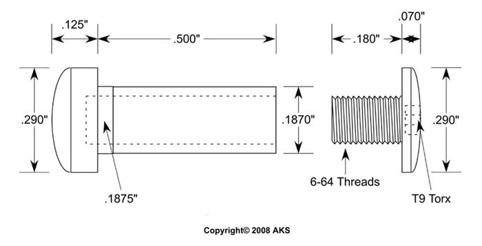

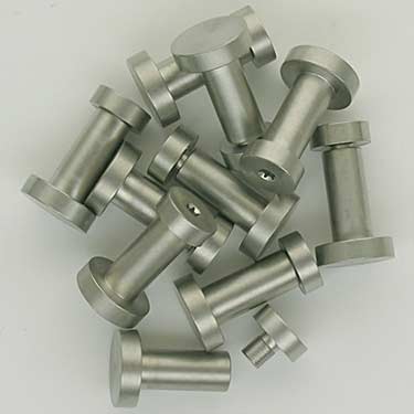

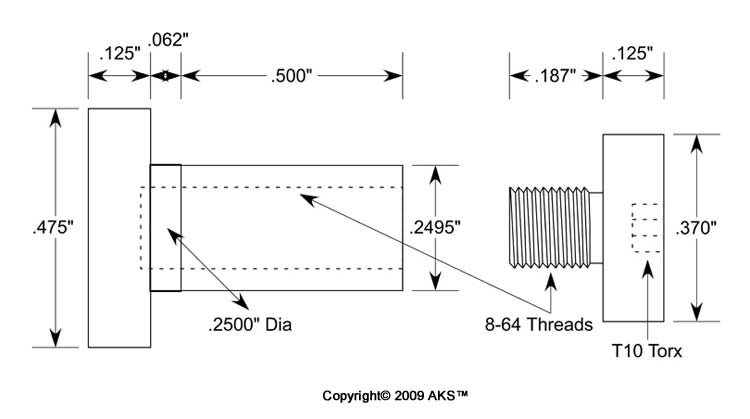

We have the following folder pivots. The pivots are machined to +.0002 -0.0000. Both pivots are threaded to 64 tpi which makes it easy to adjust the tension. The .187" pivot is a #6 screw and the .250" pivot is a #8. The pivots are machined from 416 stainless and heat treated full hard to approximately HRC 42. The raised .0005" shoulder next to the pivot head is for a press fit.
.187" Diameter
$5 Each
$45 For 10
$400 For 100

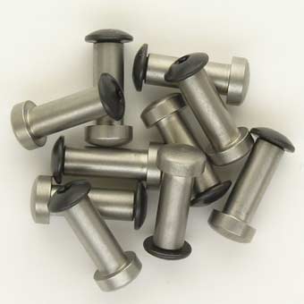

.250" Diameter
$6 Each
$54 For 10
$500 For 100

A cool feature on the 1/4" pivots is the fact the screw is available with or without the torx head drive, making them completely customizable on both sides ;)
