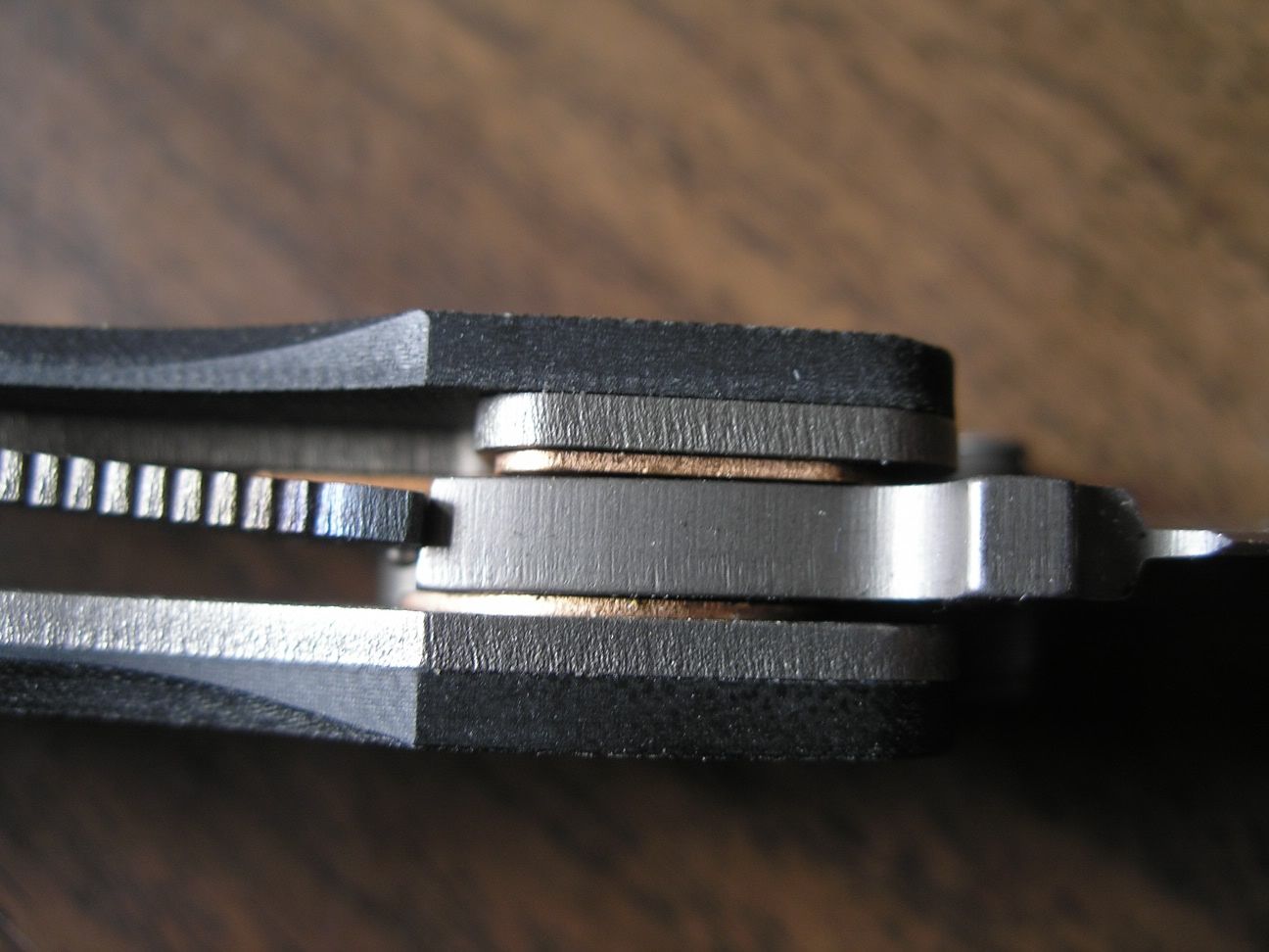

The knife in question is a Buck/Strider 880SP and it is built like a tank. I just can't imagine what was done to it to cause such damage.
I had one of those and it always felt very weak, just like you could have just flexed it by hand and damaged it. I think the TI liners on both sides, made it flex a lot more than it should have.
It appears to be the screw that failed, not the lock or liners.
Somebody needs to design a folder that doesn't use pivot screws.
Most of you know for some adventure rallies of my friend Kornolda.
who does not know that I introduce in the action;
As the Kornold is in love with his knife Buck-Strider 880 decided (of course quite significant anesthesia of the brain)
put up with any of zgrzwke that his beloved Buck withstand a breaking away to the side.
At the beginning of wbijaliśmy it in n. at the old desk with all his strength and wyłamywalimsy is getting bigger pieces of the tree.
after some time, when lacking willing Kolnel probably decided to convince himself and with all his superhuman power on a grand scale stuck in a piece of dry beam knife.
that this time went really deep.
few people kept the beam and using all his strength Vrtěl curved it ...
always succeeded .... but suddenly .. twang, łubudu and splash ....
what happened?
not resistant screw on the main axis and the blade was launched in the air straight into the lagoon Reservoir.
After perhaps an hour searching before transplantation rescued us from the oppression found mainly about 4m from the edge driven into the mud.
The whole story testifies to the incredible strength of the knife blade is not broke, after all, just popping screw
https://translate.googleusercontent...0.html&usg=ALkJrhiWIR-0SoaIR80CzefxCDxJgcYgAA
The screw broke.
