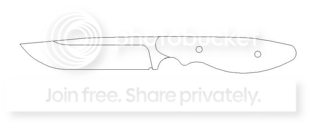

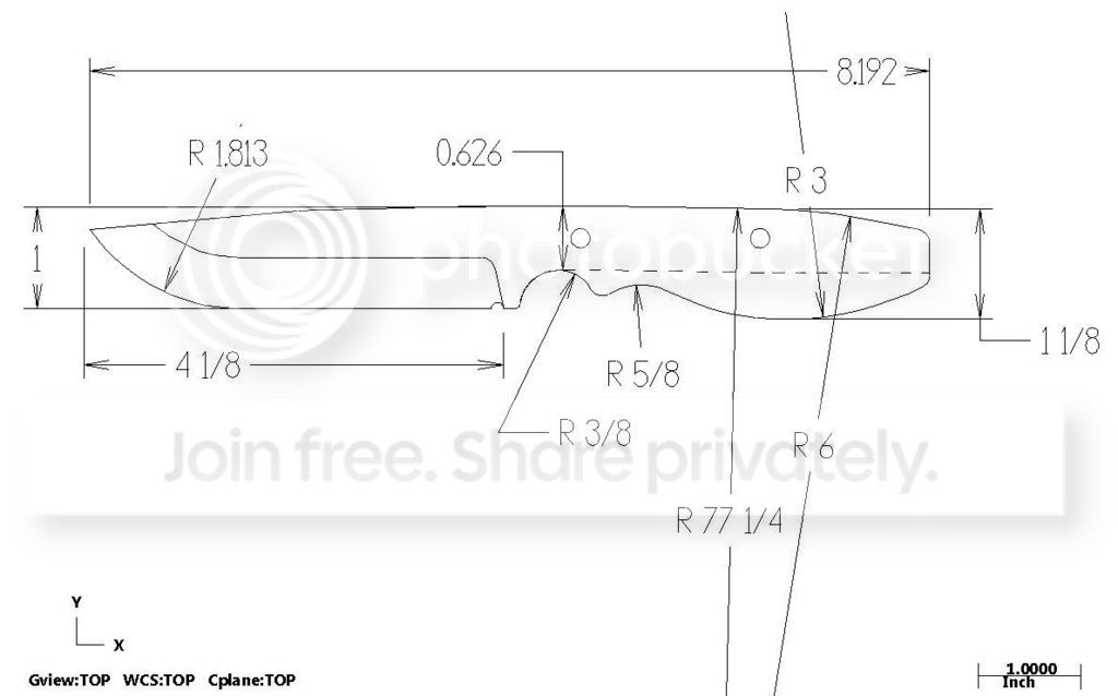

ok I'm shooting for an outdoor utility knife, semi tang, 2 pins, optional lanyard tube, G10 spacer to make up the difference below the semi-tang steel.

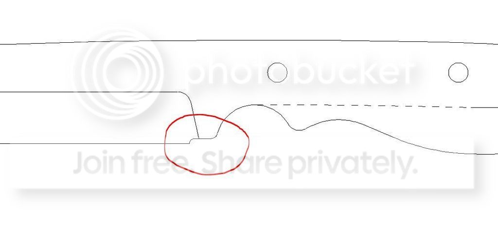

pics 1 has a choil because I think it's important for sharpening, pic 2 is a variation of that same area.
this handle design may not be for everyone so I'm thinking of a different handle option.
grind could be flat, full flat or partial convex.
ok, lay some wisdom on me! please let me know what you think, is this a solid design or have I missed something?
Doesn't look too bad. Something with the back of the handle sticks out at me, but I can't put my finger on it at the moment. I wouldn't go with pic 2.

What thickness blade ?
1" material seems pretty narrow
The rear pin is too high and too far forward.
I was going to try for a thinner slicer blade so was thinking 1/8"...i know many knives in this style are often 5/32"
I could widen the 1" height too a 1.125" or 1.25", that would help that rear pin I think.
I want to point out that the horizontal hidden line (dashed line) represents the steel blank. hence i'm saying semi tang
I agree on the rear pin. I'd bring it down a little bit--or maybe put two smaller diameter ones in the chunkier rear section.
Nice design otherwise!
I think it would look a lot more elegant if the butt was less squared off. Either put a pointier tip, or round it off some more, but it looks like the butt just got chopped off. I definitely think you should go with the conventional sharpening choil. Also as The Count pointed out, the pin placement. I know you're using a partial tang, but it is going to look very weird when completed if you leave the pin placement like that. Maybe have the partial tang come down lower so you can center the rear pin a bit more? Have you tried mocking it up in wood/cardboard? I usually do some back and forth between CAD and cardboard mockups, because it's hard to tell what feels comfortable from the screen.
I think you need to re-think the handle nearly completely. The back pin is too far forward and too high. The front pin is too far forward. The butt should be rounded. I would suggest doing a full tang and normal scales. The "semi-tang" isn't any advantage and just adds another difficulty.
Using 1 1/4" wide stock would make it easier to get everything lined up and provide plenty of room for a full tang. Forget a lanyard tube on a knife that size.
Blade is OK at 1/8X1", but the length is longer than needed. Try 3 1/8" long.
Stick with the basic choil drawn on the top blade.

Stacy's advice I would have to say is spot on, just as it always is. Primarily though, I don't see any advantage of the "semi" tang and it will be overly complicated as opposed to a full tang. If weight is your concern, hollow grind or skeletonize the tang or even better yet, do a tapered tang. If you are wanting a slicing knife, why not take the bevels higher? Maybe take them 2/3 of the way up or even higher.

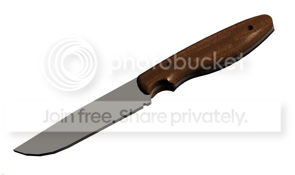

a quick update I just did, I'll continue to work on this
Much cleaner and simpler....a very nice overall shape.
The handle is a tad fat in the belly to my eye, but that can be adjusted as you shape it in the handle stages. Unless there is a reason, try and not have the widest part of the handle much wider than the blade. It is optically disconcerting as well as often unnecessarily plump.

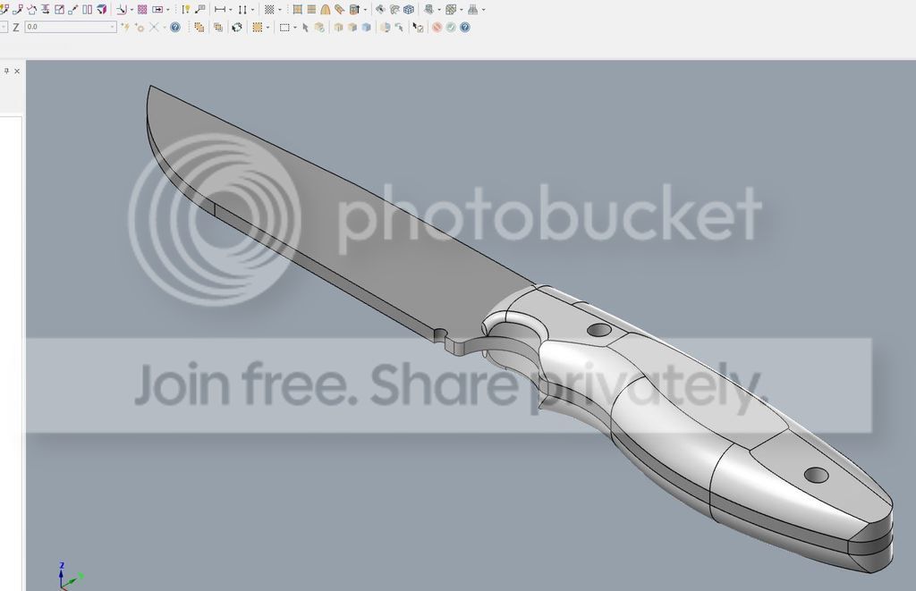

a little WIP update on this.
I was able to visit a MS knifemaker and took a grinding lesson.
I'm not done with my training just yet but here is a grind I was able to get last night on some practice mild steel.
The other side was good but not perfect.
And so I modeled up this handle as a test on a CPM-154 blank
I had a fellow knifemaker here on BF model the surfaces for me, (because I'm rusty and want to focus on the knifemaking part right now)
He was kind enough to make a solid model from my 2D geometry. The facets are little still a sharp and need to come together,
But this should work fine for now as a test.
From there I can machine the scales on the CNC however I want or can envision.
The design isn't perfect or solid and frankly I'm not certain where I'm going with this...but I sure am having fun :-)
