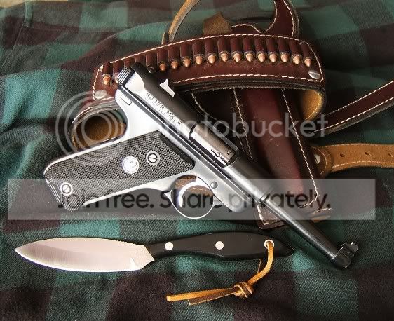

I own standard bushcrafters in the form of a Kosters Bushcraft and a Bark River Aurora. I was looking at BrianS's Canadian:
What do you feel the advantages of this shape are? Why do you like them? I think they look cool - but I don't know if I 'get' it? Help me out - sell me!

I think that's actually a Grohmann DH Russell No. 1, with the original grind (as opposed to the flat ground version). It's definitely a classic Canadian knife.
The advantages: It's a really great slicer with a comfy handle and good balance. I have heard that they are particularly good at skinning, though I have not used mine for this purpose yet. Mine gets used for food prep (where it excels), woodworking, and general camp chores. The grip is very reliable, and I have often used this knife in the winter, wearing gloves. Paired with an axe for chopping, it makes a great outdoor knife.
This is what Grohmann says about the design:
This is the Original Design Award winning D.H. Russell Canadian Belt Knife in production since 1957. Grohmann and D.H. Russell teamed up to design a truly Canadian outdoor knife and through trial and testing with hunters and trappers came up with this first design in the line. By our last count, our knives have been copied by more than 16 different companies over the years that have come and gone, ours is still the only one in production after 50 years. High quality materials, along with outstanding designs and talented craftspeople, made in the traditional way.
General Purpose fixed blade outdoor knife, ideal for dressing game. Extremely comfortable grip for any application from small game and birds to large game. Unique elliptical blade to lessen cutting drag. Palm & finger fitting "offset" handle for safe grip.
Blade approx. 4" x 1", of 1/8" stock, total knife length 8 1/2".
If you opt for one, consider getting a flat ground version. Mine cuts like a razor and holds a decent edge.

Yup, that's a Grohmann #1 in carbon, original grind. Got it for $50 bucks at the Scout Shop - figured it was a good blade and the money going to a good cause. It field dresses well and is excellent for food prep. The blade lies below your fingers, so I find it excellent for precise cutting tasks. It's nice and light for backpacking and doesn't seem to scare the sheep.
It's a soft carbon, which has it's advantages and disadvantages. I heard that some Canadian trappers requested the carbon so as to enable quick field sharpening. When camping, I enjoy refreshing it's edge on my little ceramic stone whilst relaxing by the fire :)
It's my best slicer and can push-cut paper by almost weight alone.

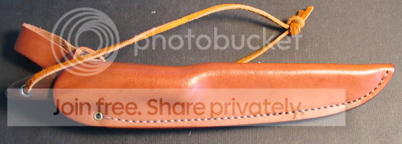

Shaping is really easy - you just need to wet the sheath and form it to the contours of the knife. It will retain the shape as it dries. To make things a bit more durable, I recommend adding a few coats of neatsfoot oil to the finished and shaped sheath - this hardens the leather a bit, and helps it to retain the formed shape.
For a carbon steel knife, I recommend either taping the blade or wrapping it in plastic wrap before forming, to protect against rust.
Soak the sheath in water until the leather is thoroughly penetrated. Pour out any excess.
Insert the knife into the sheath and shape the leather around the contours of the knife using your fingers.
Leave the knife in the formed sheath for a while. There are different schools of thought on this. I have left knives overnight and allowed the sheaths to dry around them. I have also gently removed the knife after just a few minutes, and allowed the sheath to dry on its own. It should hold the formed shape anyway.
You can speed the drying process by putting the sheath in the sun or by a radiator, or by using a hair drier. I usually let it dry on the windowsill.
Once the sheath is totally dry, you can give it a coat of neatsfoot oil (I get mine from Texas Knifemaker's Supply) if you want.

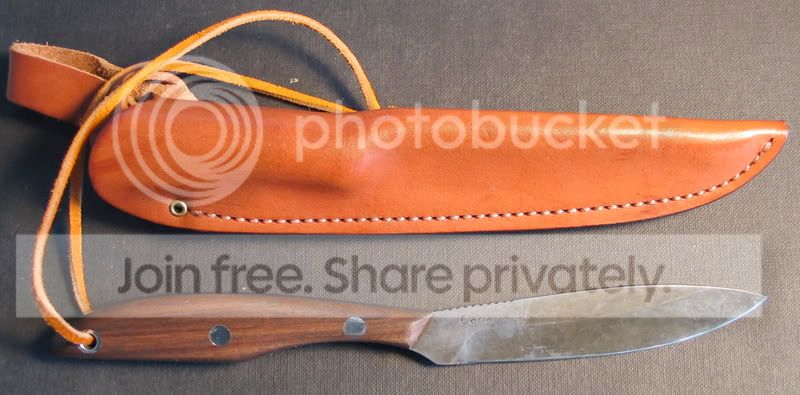

Here's a shot of my Grohmann Bird and Trout knife and formed sheath. This blade gets lots of use and has developed a respectable patina.

Yep, Bird & Trout. I love this knife. It's a great fishing companion. I recall a few outings where I used this knife to cut line, cut a cigar, clean bass for a shore lunch, cut onions and potatoes, and whittle a fuzz stick to get the fire started. Definitely a good all-around user. Not much of a chopper, though!
