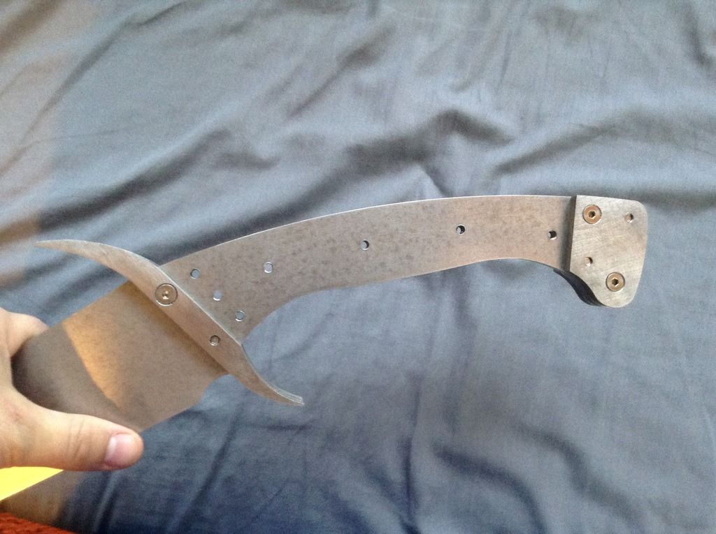

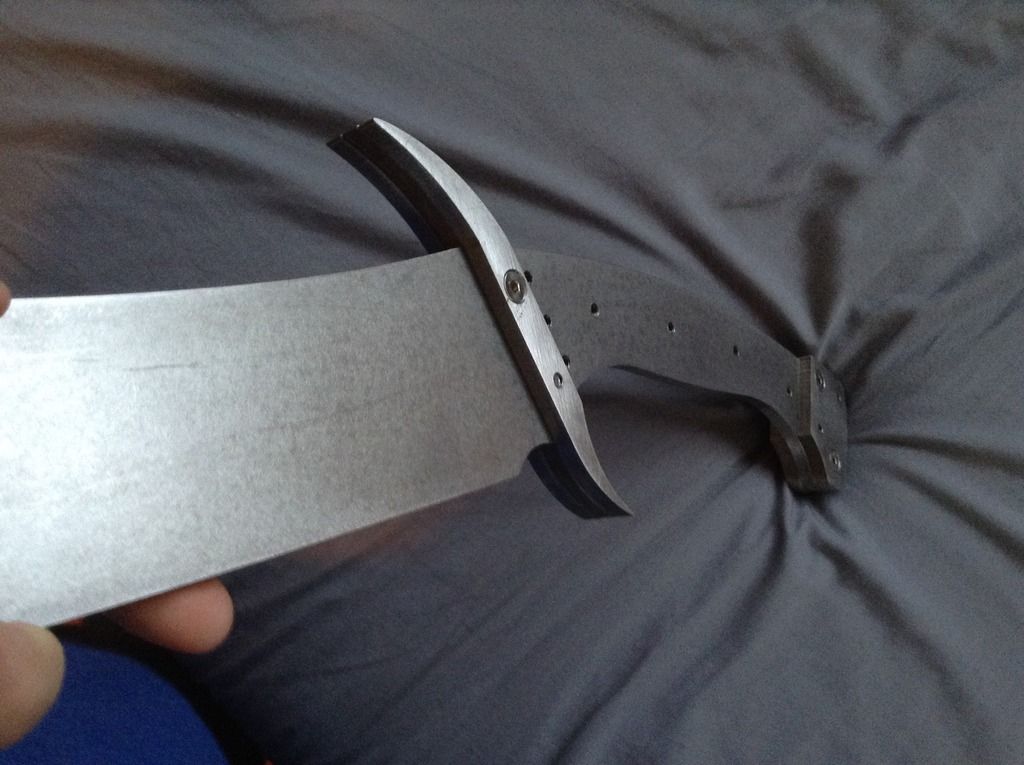

I think you will benefit from cutting off the guard lugs on the blank, and crafting a guard that can slip on as a press fit from the rear....that is, however, your choice.

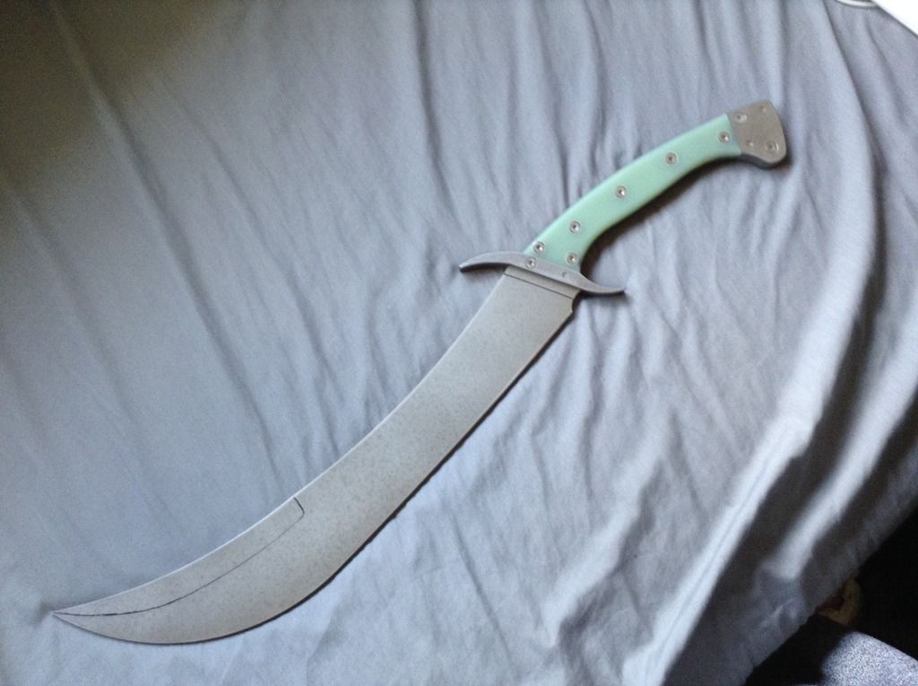

I like the look of the sandwich tang and that i can remove all the bits and pieces if i want. Iv already made the handles just haven't posted pics yet, but they are jade g10 over black liners.
