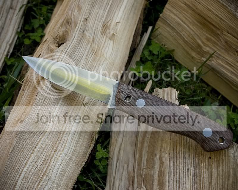

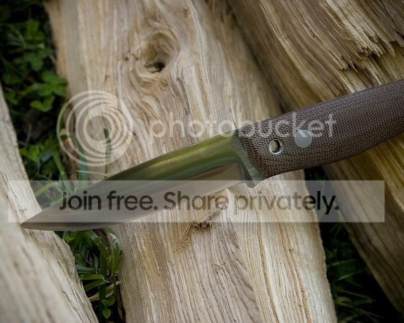

Okay, enough talking. The only knife I currently have in O1 is a prototype Koster bushcrater. The sides came "as forged" so I had to polish it up first.
As you can see, I wasn't too careful about the clean-up. You can still see spots up near the handle, etc. This was just a general experiment on O1, so I didn't really care.

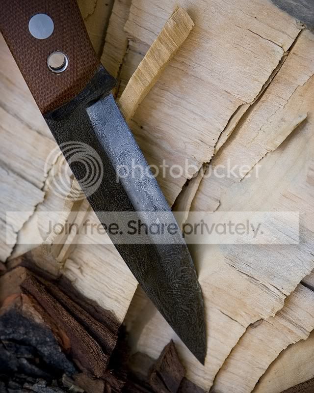

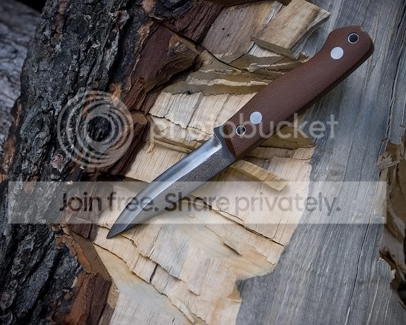

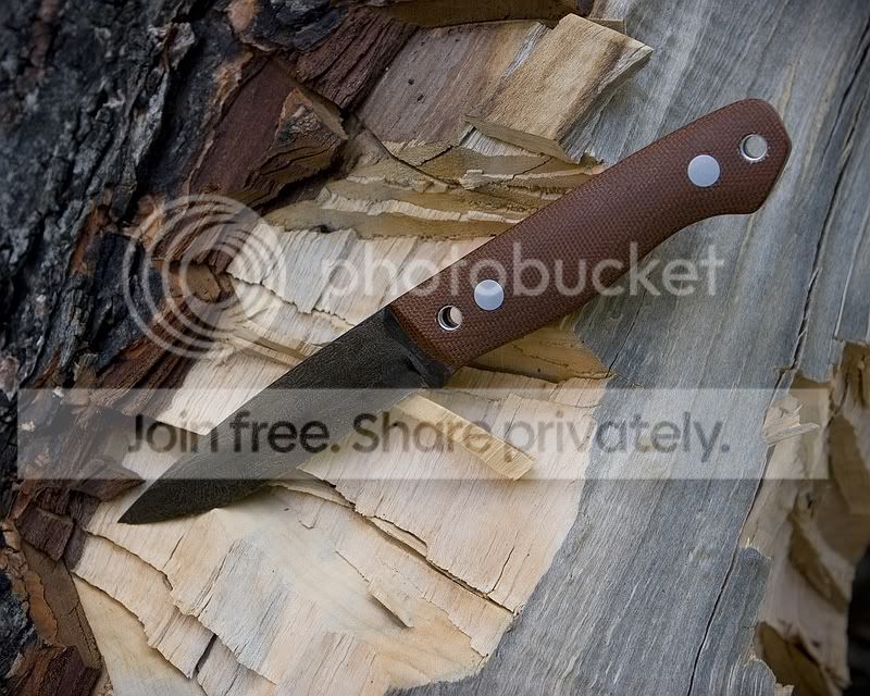

Here is afterward, but before a needed sharpening. Whole thing was able to be done in 1/2 day and two applications, versus about 1 week and 20 applications of mustard.
Okay, now I needed to sharpen it a bit. Since it is a scandi grind, obviously there is going to be alot of contact area with the abrasive. So, it removed some patina, but I didn't try getting it all off.

but i like the patina you have there. its very dark and solid and even, it looks almost like a bluing type of finish.
Yours has a very nice pattern to it. I find that O1 gets really black at first and then the forced patina kind of washes out after using it a bit. Either way I think it is a good look for your knife.

Now, I did not do it that way exactly. I was afraid to dip micarta into 200 deg F bleach. I got the recipe from a knifemaker, and he does it before handles are applied. I also knew that I could not safely touch a liquid at that temp. So, I heated it to about 125, soaked a rage with it, and tried to soak it that way. Everything else was the same.
I did it twice.
I don't know if the pattern is repeatable. It was my first try with this method. I applied it with my finger in small swirl motions.
We will see how it looks after some more use. From past experience with O1, once you get a patine going, it generally just keeps looking better and better.
