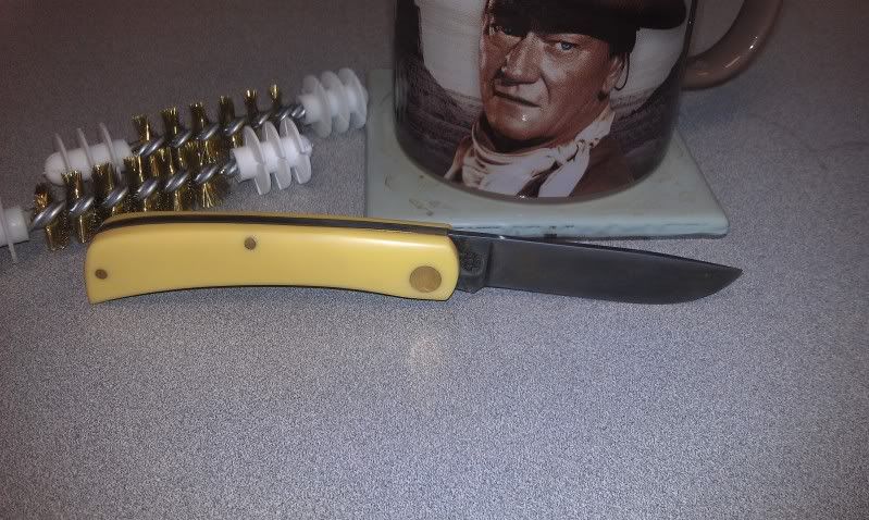

Here's my Sunfish after a vinegar bath. I've done it several times. The first time I heated the vinegar, but for subsequent times, I just used room temperature vinegar. I wrap the blade in a paper towel that I dip in vinegar. Set in on the counter for 15-30 minutes and get what you see on the left. I then put some Simichrome on the blade and work it some with a clean paper towel. It seems that the more you do the process, the darker the blade gets. I really like it, and do think it helps protect it from rust. I don't really care that it's not even, looks more natural to me.
