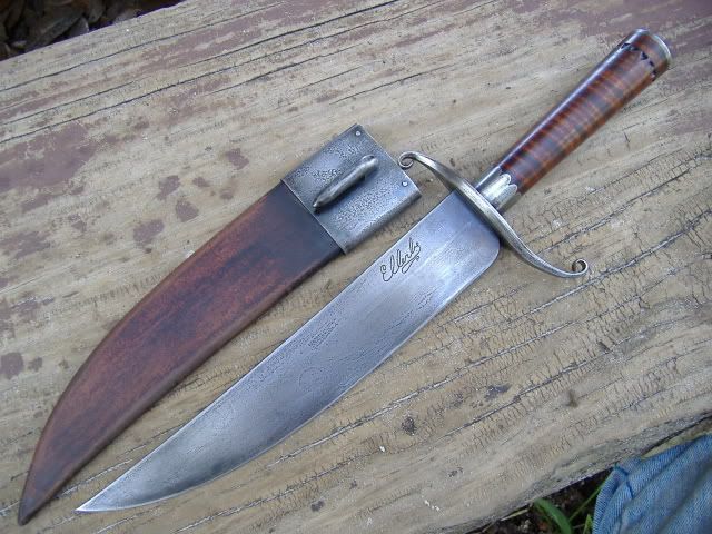

For the heavily etched look the fastest way is to use the cold blue/bleach method and that can be varied considerably- examples:
These blades were forged by the late Gib Guignard and the spine is forge finished then the etching was done by me - as you can see it can vary considerably due to soak time and material......

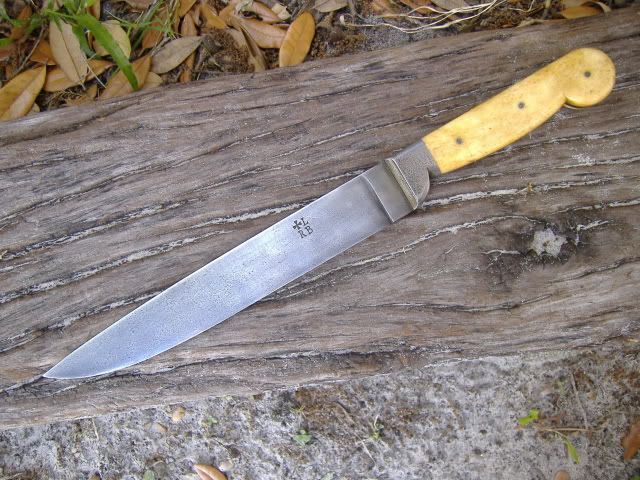

heres a hawk done with the bleach/cold blue method. The longer the etch the more aggresive the patina..
Here are some examples of gun bluing and bleach...

It is simple hardware store cold bluing solution. Apply it, let it dry and soak it in bleach.
Factors that affect the etching pattern...
- The finish prior to bluing
- How the bluing is applied (patterns, layers, etc)
- How you bleach soak. (spray, dip, full submersion, etc)
- Temperature of the soak
- The duration of the bleach soak
- How you clean/sand the blade after the bleach soak.
- Subsequent bluing applications and buffing/polishing to highlight patterns
There can be as many variations as bringing out a hamon. You just have to get to it and experiment.
Rick

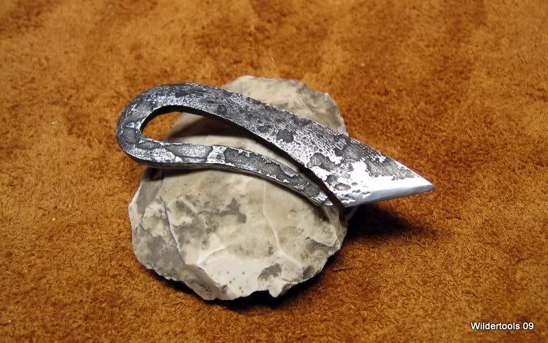

I would call it an etch rather than a patina. How I understand it, patina is surface oxidation that forms a blanket over the metal. The blue/bleach is plain old corrosion that happens due to a chemical reaction between chlorine(bleach) and selenium dioxide(blue)
The fumes are toxic by the way!
So the pattern is actually etched into the blade. I usually leave it in for 25-35 minutes. This is what you get at 2hrs... If you left it in overnight you wouldn't have much of a knife left but it would sure look as if it was just dug up from centuries of old...
